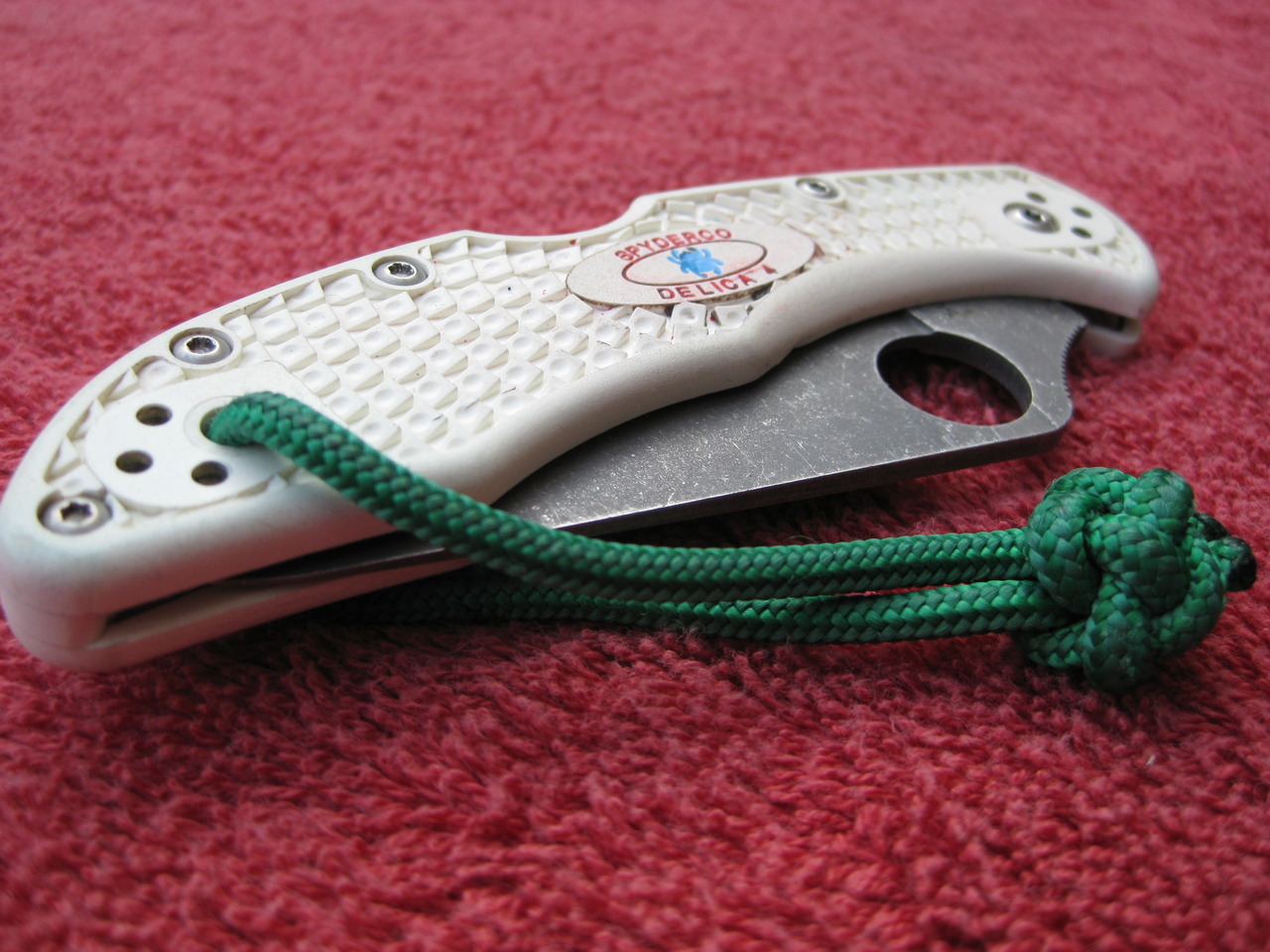

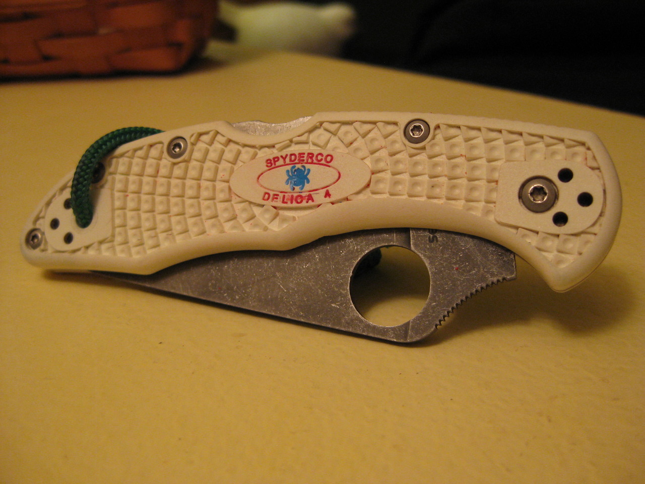

This is not exactly a patina, it's more of an acid etch I guess.
This is my Sage2 in S30v with an acid stonewash, done by So-Lo
Are you aware to what sort of acid did the etching and if it's possible to mask the blade in any way to control a design?
I'd like to educate myself on this matter and possibly do some experimenting.
After a bit of looking, the chemical appears to be Ferric Chloride. Anyone adept on the safety precautions needed with this? What about materials it will avoid? I could possibly dab Vaseline around a bit to make a cloudy effect on the blade, which could be interesting.
After a bit more research, it appears as though a half and half solution of this Ferric Chloride and water over a period of ten to fifteen minutes will achieve the level of darkness you acquired on your Sage 2.
Safety precautions include possibly working outdoors or in a well ventilated area and with a facemask and gloves. I've worked with lye before, if this is at all similar, it shouldn't be too hard to deal with.
Also if this only effects the steel, I should be able to mask it easily with either something oily, masking or packing tape or possibly even peanut butter. It looks like I can pick up a can of this at my local Radioshack. I'll buy some and run it sometime midweek and post pictures.

This is 3 minutes in pure ferric chloride followed by 15 minutes of stonewashing
