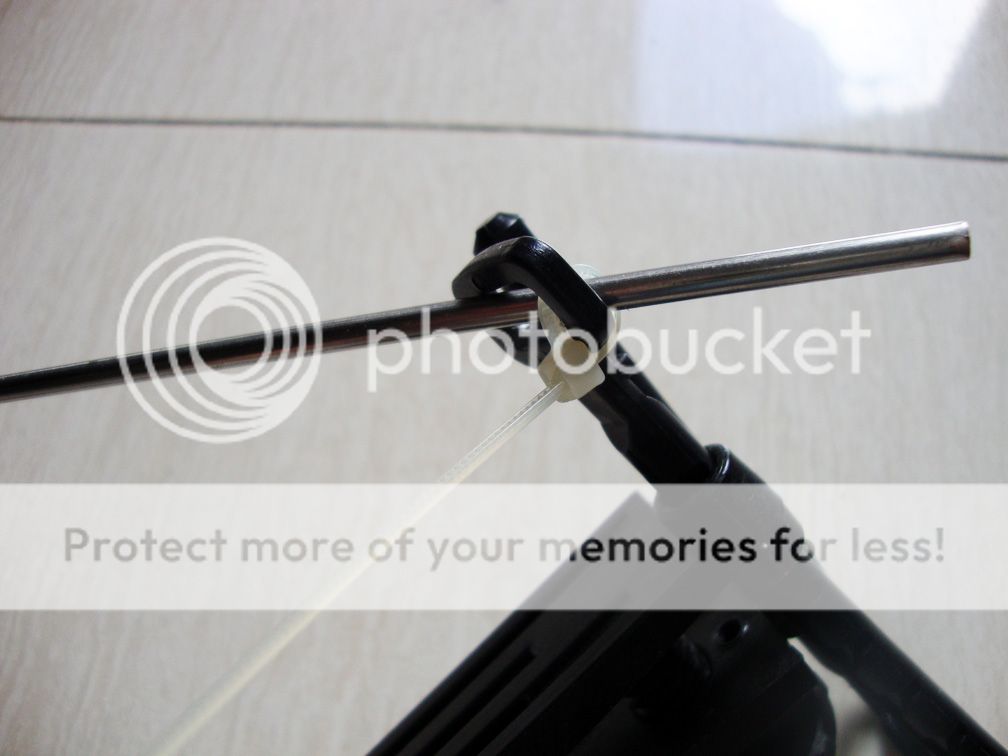

This happened to me too with a DMT Aligner kit. I surmised that I had too much flex in the system and wasn't hitting the edge cleanly. This was my fix and it did help a lot but YMMV.

I use my finger to hold the stone's rod in about the same place. I push the rod towards the handle. This was taught to me by the guy who recommended the Lansky.
I did remember this afternoon that I did something different. Most of the time I try to make 3-4 passes in a space roughly an inch long. When I sharpen this I did the normal 3-4 passes with the fine 600 grit stone and then switched to 1-2 passes per inch with the 1000 and 2000 grit ceramic hones. However, there is a big hole in that theory. I first noticed that the edge looked wrong when I was working with 600 grit stone.
