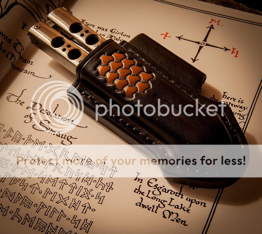

My fav stamp is what I call the dragon scales, it's the tri-corner basket weave stamp and can also be tricky to use, comes in two sizes, while my sheaths are folders only, I often just add some embossing to add some contrast/character and not try to do the entire area, in this example it was a little trickyier (real word? :) ) as I dyed around it with burgundy and did the dragon scales in saddle tan and then applied HiLiter to bring out the details of the stamp's corners, it was for a large Sebenza without it's clip

Pat, Gary is being a little modest with the Dragon Scales stamp. It is a SOB to run properly although Gary's photo is an example of properly. If you buy it be aware, it's not a beginner tool. It allows NO room for error without putting out a tall tale sign for all to see.
Gary, about all you could learn from my DVDs might be a few "different" ways of what you already do better than anyone I know. That is the best use and display of that Dragon Scale tri weave I've seen also. It is kind of a bastard to master, no?
Paul
Thanks Patrice and Paul, that one can be a lot tricky for sure! one slight misstep and you have them angled and too close together, really hate when that happens!! But the thing I was trying to bring out is you might not need to do the entire sheath, especially where it folds as the embossing can smooth out and not look as crisp sometimes.
