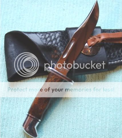

Now here is a special "Special"
My ATS-34 and Desert Ironwood 119
