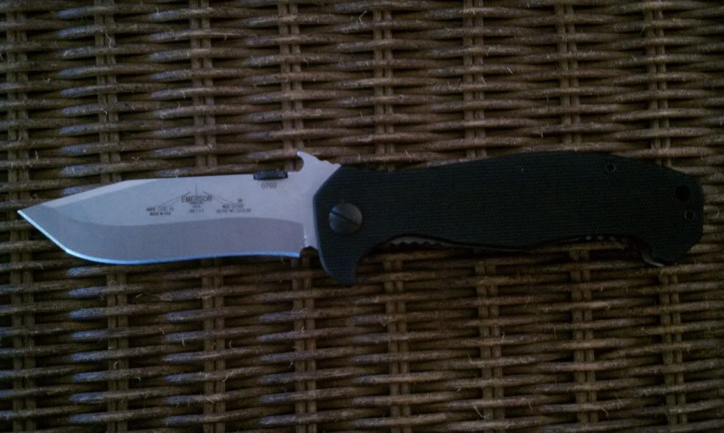

Well, even it is hard, I could not help myself and here it is... :D
First Emerson for my collection - amazing handle and a sick, sick blade. The only downside it now I want a Persian, a Super CQC-8 and a Super Commander really bad...
One question though - the Emerson's site says the CQC-15 has a conventional V-grind, and mine seems to have a chisel ground, although the blade says "2012". Am I missing something or is this awkward? I know most Emerson knives are chisel ground.
The 15 does have a conventional V grind. The proof is flipping the knife over and looking at the other side. You are confusing cutting edge and primary grinds.
That's referring the main bevel. All Emerson knives have chisel EDGES though.
Oh yeah, I did not realize that, thanks for the info, guys! A classic Emerson newbie collector's misunderstanding. :)
I hope I will be able to purchase one soon and share the love, Emerson is great, I finally understand the passion for them.
That's a beautiful knife. Let us know when you buy your next one. LOL!
