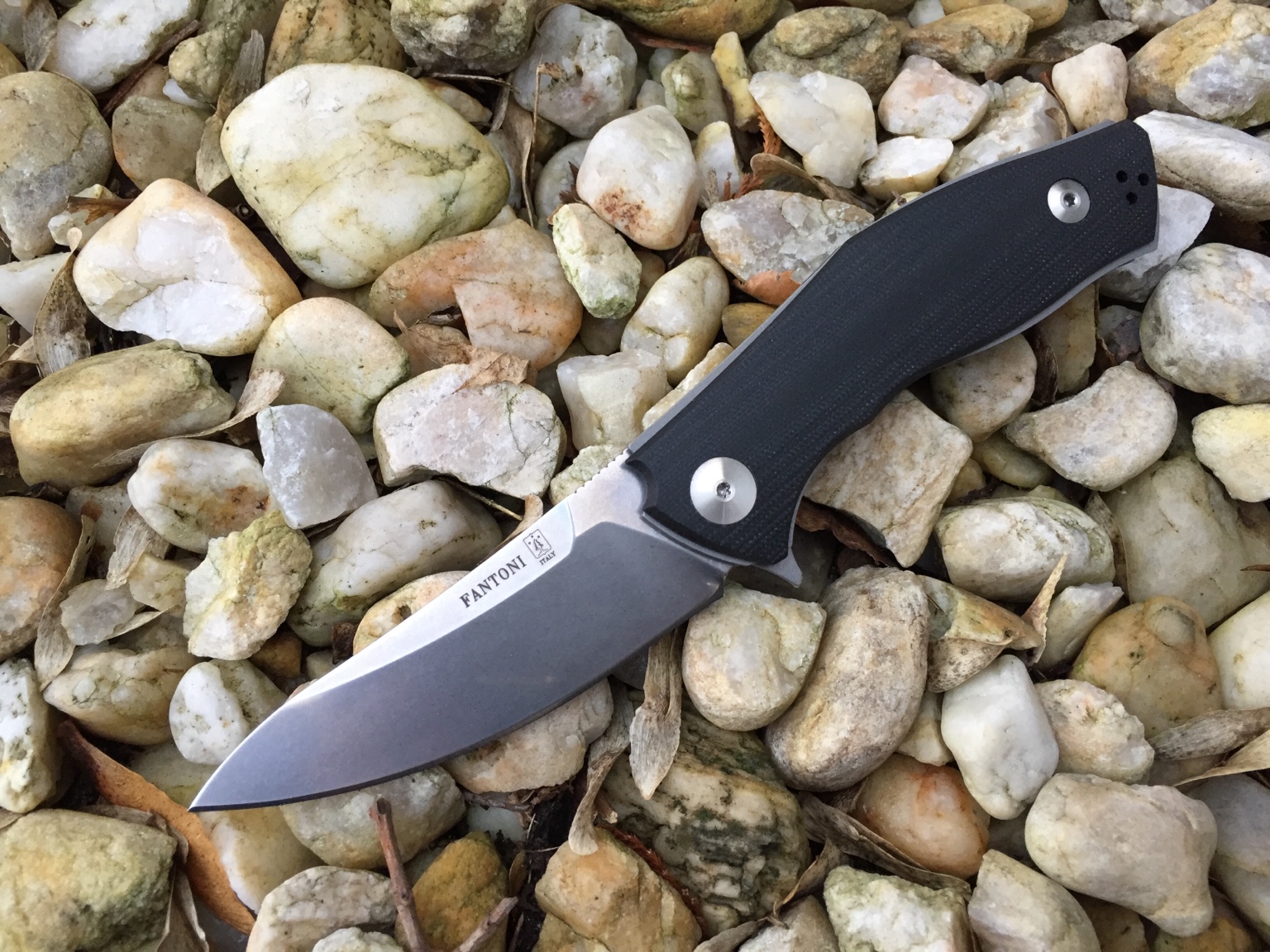

Fantoni makes quality knives. I have a HB01 and HB02. Tough and smooth folders with the best titanium liner locks I've had. However, for the CUT they should've used bearings. Nice ergos on the CUT.
Anyhow, after reading this thread I have determined that the lockbar is just too strong. The detent is smooth but it pushes on the blade so hard that it doesn't flip out quickly. Last night, I disassembled it again and adjusted the lockbar slightly to relieve the tension. Now it flips perfectly without effecting the detent strength or the lockup. No wiggle or movement and it fires much harder. I really like this knife and I'm definitely going to pick up an HB03 soon.
I can't take mine part. It ate one T9 bit and a new craftsman T9 driver is also twisting while in the pivot screw. I'm not sure how to heat up the pivot to loosen the red locktite without warping the G10 next to it. I guess I'll just live with the way Fantoni designed it. It is built like a tank though.
