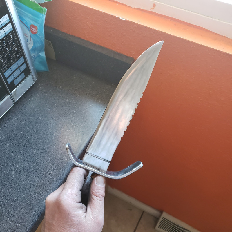

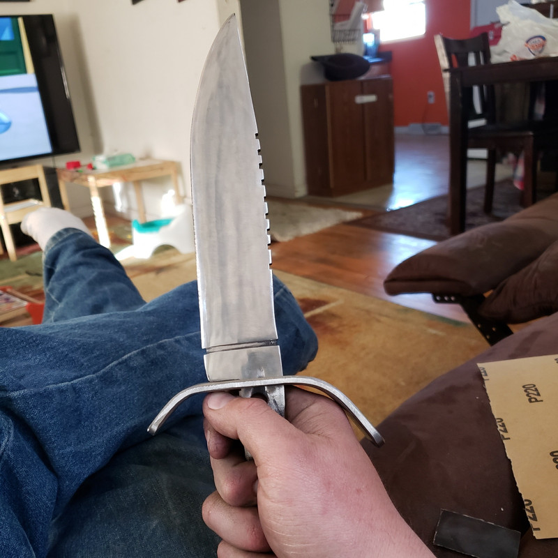

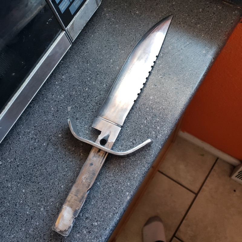

I was really trying to make it look like a simple version of a Spanish haft that why I raised it But now that you said it maybe more synthetical would be more pleasing to the eye. Thanks for the inputI would like to see it being more symmetrical, but that's it. If you like it this way then do it. The top piece looks like too much, compared to the bottom half. I like the smaller version of it.
Great point I could just flip it lol . Never thought of that duhMaybe you like this. It's asymmetrical but it makes sense this way.
I'm gonna sleep on it but I agree with both of you. I think I'll save this one and forge something like the exampleI don't generally go for big guards, but for a "combat" style knife it makes sense. I would do it like the example posted - the longer arm of the guard should be on the blade side, bent back to protect the fingers. The shorter top arm would be bent forward to act as a blade catcher.
Put the longer part to the bottom and bend the small part forward. Then embellish the guard a bit with file marks. The grind line forward of the guard will be a potential crack line, I would redo the tang and move it up to that grind line. Flat grind lines are potential crack lines, always round inside corners to reduce chance of cracking.
think this way it would bump into your hand if you hold it like a hammer. You going to add handle and it will be even less space. With guard being forward on top you can perhaps put your thumb on it at times.
