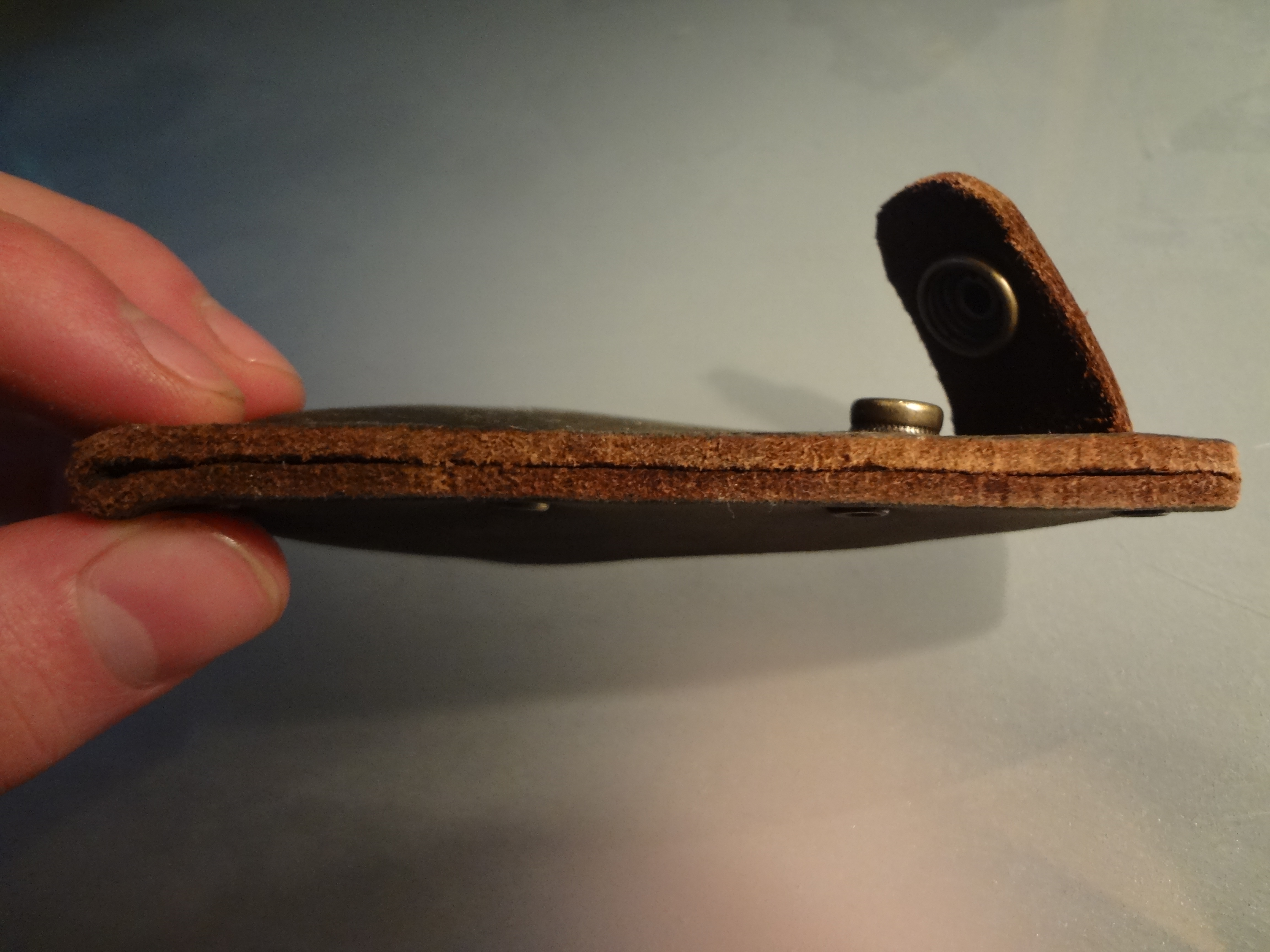

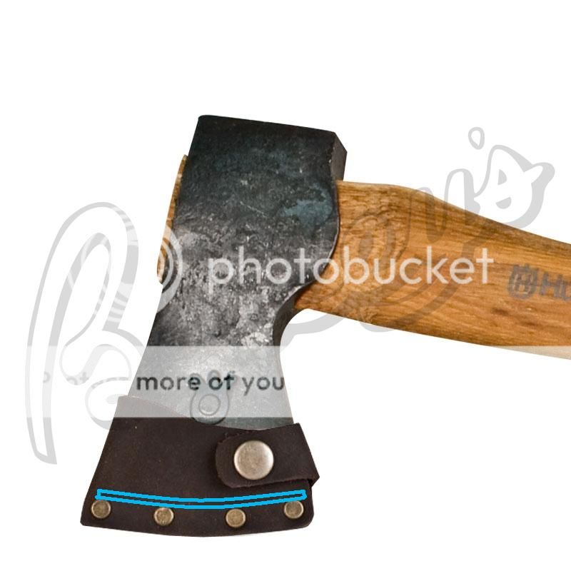

I received my Husqvarna 26" axe today, and I noticed that the sheath that comes with it has no welt and could possibly damage the edge.
Is there any fix for this besides getting a whole new sheath, or removing the rivets to put a welt?
The rivets are, most likely, much softer than the edge of your ax. I wouldn't worry about it. But, you will need to pull the rivets (a pain) to insert a welt. You could stitch next to the rivet shank but the ax will cut the thread sooner or later. You could also run a bead of epoxy or rubber glue (carefully) or something else along the inside of the seam. Let us know what you try and how it works.

Along these lines glue a leather a "mini" welt inside:
What ever way you go you may have to stretch the strap.

That isn't a bad idea, unfortunately all I have is super glue,which might work but will most likely fail over time. I imagine if I can cut a strip of leather with a bevel to sit in the crease the super glue will hold better.
Thanks so much for the idea of a miniature welt inside the mask, the axe still sits very well, and has much less movement with it on.

Yeah I made the strip of leather about 3mmx3mm with a bevel, and added some super glue to be safe.
Late as usual to the party, but the heads on the rivets are much larger diameter than the barrel/post which means, if they are properly set, there is no chance of the edge touching them. They can be smacked with a hammer lightly on some sort of anvil to tighten them if need be. But appears as though you found another good solution.
