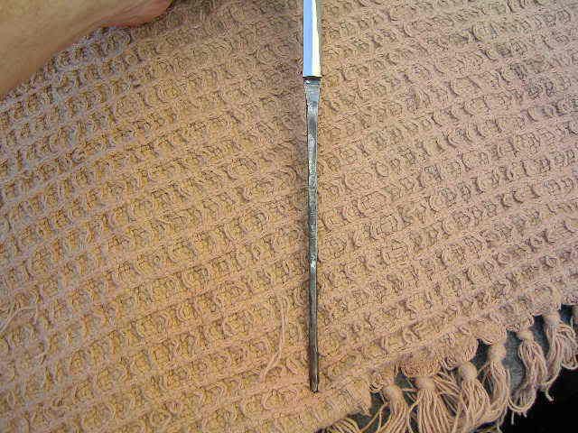

Gotta remember too that an HI "rat tail" tang is a huge piece of metal more accurately described as a hidden tang. It's no small, thin extension...it's stout. There are pics on here if you care to search.
Yes it is quite stout, and will last anyone a lifetime. Photos are taken by Norm of his museum model.
After seeing how my Ang Khola has survived with flying colors all the extreme heavy use l've put it through, I don't see that hidden tang ever breaking.
I shattered the wooden handle on a Windlass kukri but the tang and blade survived perfectly intact. The tang on the Windlass isn't even close to being as stout as the H.I. khukuri tangs.
Im not very versed as to the "internals" of the HI Kuks, my I have been using the absolute hell out of my month old WWII, and its holding up like a anvil.
