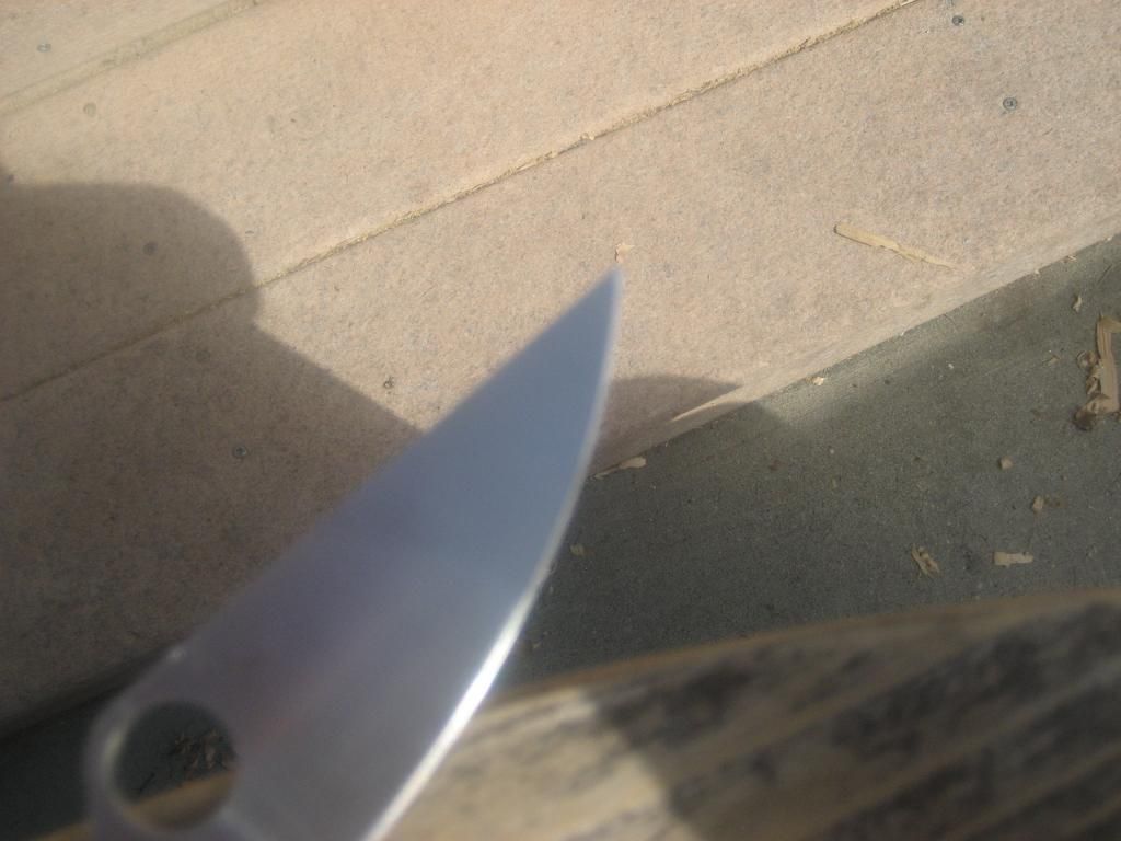

I wish I could focus better, and it probably doesn't look like anything at all but here's what it looks like.
Is that a PM, or PM2? If so (I'm comparing to my PM), I think the spine on that blade should be dead-flat, all the way from the hole in the blade to the tip. If so, should be able to just lay the spine flush on the paper to sharpen up the tip. That would keep everything looking like the original factory profile. Because you'll be sanding the full length of the spine, it'll take longer, but the end result would look cleaner. You can lift the spine a bit to focus only on the tip, if you want to; that'll speed up the process, but will leave a bit of a 'drop' in the spine, near the tip.
David
David
Yes it's a PM2. So I'll leave the spine flush against the 400 grit. Will this do anything to the rest of the spine?
It will leave the 400-grit finish on any part of the spine in contact with the paper. So long as you keep the stroke steady and straight, it should come out looking clean. It's just a matter of whether you'd like to keep the dead-straight lines intact, all the way to the tip. Keeping the spine flush to the paper would do that for you; otherwise, lifting the rearward portion of the spine away from the paper will tend to make the spine at the tip drop a little below that dead-flat plane, while sharpening up the point.
