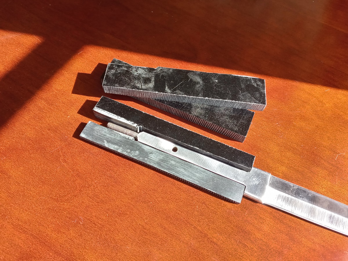

So, I'm thinking a pair of 1-1/2x3/8" black paper micarta scales, splitting a 1/2-inch section off each one lengthwise to form the middle layer, with a little angle at the ends so they enclose the tang where it meets the threaded section, thinning them, gluing up, turning to shape, then filing the groove by hand. If I can get a good tight fit on the wire wrap, maybe it'll help prevent the layers from delaminating.
Finally got my hands on the micarta three days ago. The plan is progressing... more-or-less according to plan.
Is there a glue that I can be reasonably confident will keep the assembly from coming apart while it's being lathed? You can envision that the contact area between the layers isn't going to be huge by the time it approaches its final shape.
Edit: I do not know the manufacturer of this micarta or exactly what materials it's made of. It's sold by Crazy Crow. I could try calling them if that might be helpful.

BUT - since you are trying the layered approach, I would suggest making sure the micarta on the sides is uniformly flat and only a tiny bit thicker than the tang. Drill the pin hole through the micarta Rough up the flats of the tang and the micarta then clean with acetone before applying the glue (I use JB weld a lot). Glue the pin in and clamp for drying.
Once cured you could try the lathe method and hope it doesn't blow up. Or you could drill smaller pin holes to pin the 3 micarta slabs together on each side of the tang and glue pins in for extra strength, and then sand the handle to shape.

Well, the epoxy wouldn't hold the micarta. I put it on the lathe, and as soon as the chisel touched it (or maybe even before) it just exploded.
