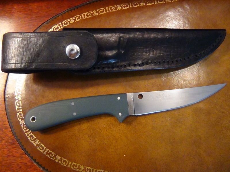

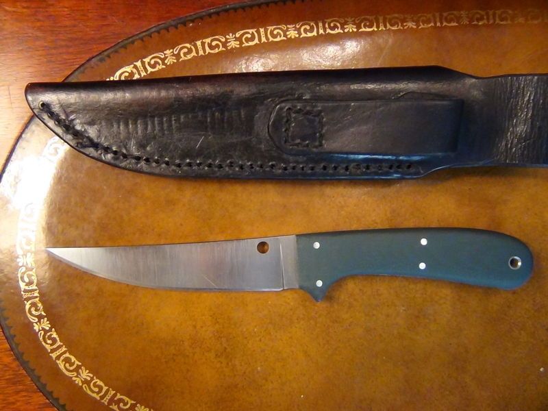

Hi Guys, it is a legit Spyderco and I can solve part of the mystery. Early on I did a few re-grinds and this looks to be one of them.I no longer do that for obvious reasons.This one appears to have been though some testing of some sort. The Spyder is gone since it was ground off. My logo was also ground off but replaced after the work was done. This one has had the lower blade edge curve modified from the standard profile. I did check the hardness as I remember but looks like there were more done subsequently. It is still a useful knife but is a departure from the original design and shape. Hope this helps, Phil
I don't see how that knife could possibly be .003" behind the edge and still have an edge bevel that wide. I believe somebody has their numbers wrong drebs.
Way off about .015" off or more. LOL
I would say that is in the .020" to .025" range, guessing from the picture.
I contacted the seller and had him give me the thickness behind the edge and the spine he said the spine was 3mm which comes to .118 which sounds right. But that the behind the edge was .8-.9 mm which is .003. That sounds like it has been converted to a fishing knife? I was going to use this on elk and deer, anyone opinion on if that's ground down a little too much?
