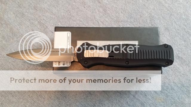

Going to look at this used infidel, I have never handled one I guess the weight is a real tip off.
Can you tell anything from this pic? Asking price is $250 I probably won't go more than $200 if real.
Blade looks a little narrow to me but not real sure.
Thanks for the help!!
Looks legit to me. Here's a pic from Benchmade's website of the Infidel and the blade looks in proportion compared to the official pic
A real one is about 5oz. The fake ones are quite a bit heavier.
The real one is anodized and it's kind of a rough powder coated type look. The fake looks painted (because it is).
The clip isn't that great of a test because anyone can call Benchmade and request one for their fake (obviously not telling them it's for a fake).
