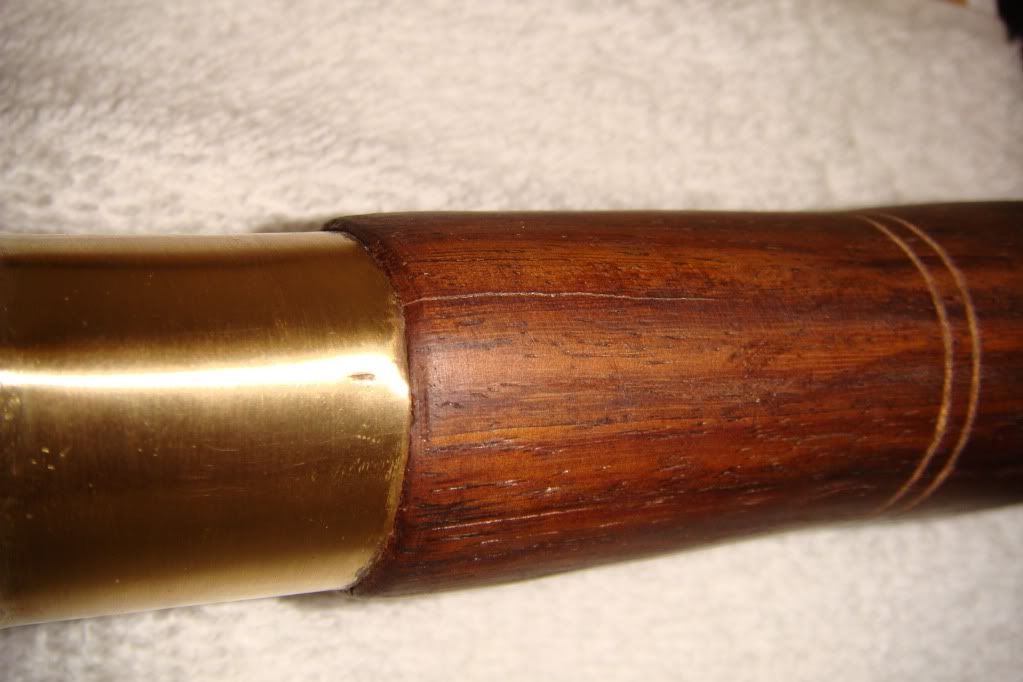

I just received my Villager Tarwar (which I LOVE) and noticed 2 small cracks in the wood handle. Should I be concerned about the cracks? Are they a problem? If so how do I fix them so I can still polish/stain the handle in the future. I also don't want to void my warranty.
Here are some pics of the handle and cracks:
The big crack - the one that worries me.

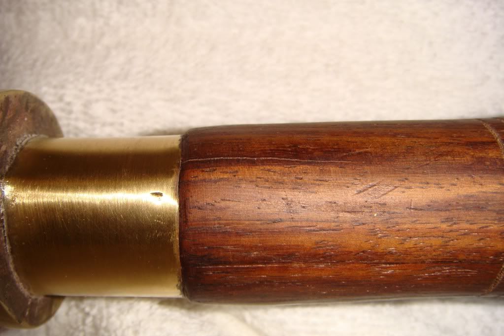

Another view of the big crack.

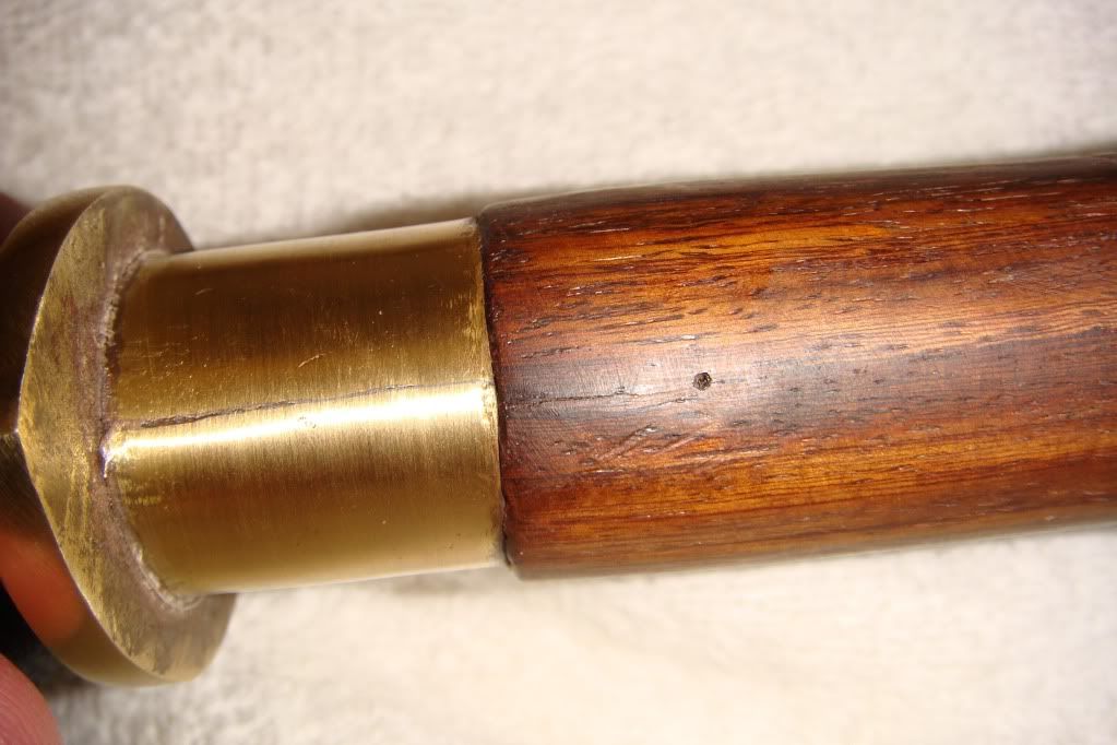

Here is the small crack. It looks like someone drilled a small hole at the end of the crack to relieve the stress and keep it from spreading.

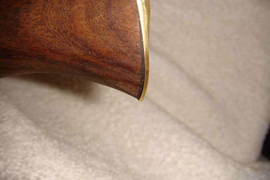

This pic shows that the wood handle has "shrunk" in the Nevada heat, pulling away from the butt-cap. I plan on filling the gap with super glue or epoxy.

The cracks shouldn't worry you. Just a little superglue or epoxy and you're good to go!
yep, those are minor. If you don't want to fill them just yet, try re hydrating the wood with some oil. I like tung myself, but there are a million ways to refinish a handle with a little forum search:)
Buddy, if those lil scratches bother you that much you should stick to polymer handled knives.
Ezaske, +1 on the Tung or mineral oil or Boiled Linseed oil, let the wood rehydrate before "fixing" the cracks.

Those cracks are almost negligible. I would sand off the surface a bit and then apply some clear epoxy.Re-sand the surface for a uniform finishing.
Then use some beeswax to touch up the whole handle.:D

I like my hairline crack khuks because it gives them identity. Anything deeper I epoxy.
Ezaske, my apologies. They aren't falling apart. It's not uncommon. Don't worry. I wouldn't even touch that unless it spread.

Oil it! Those aren't cracks -- they're channels to get the oil deeper into the wood! :D
Actually, oil is probably a better idea than epoxy. In dry country, you need to oil the wood anyway, and superglue or epoxy will block that.
Ezaske, this is the absolutely the right place for your question. Your concerns are a valid concern to you as this is your first foray into Himalayan Imports and this is the Forum for you to have those questions addressed. Occasionally a member will make a statement that is unresponsive to your question, but we are all prone to making mistakes at times. Just bear with us and all should be well.
You've been given good advice about rehydrating the wood with oil, and if that doesn't close the cracks up enough you can use a wood glue, super glue or an epoxy if the crack's large enough. If staining the handle in the future is a major consideration, I would consider adding a like colored wood dust to your glue. I don't think that your warranty is in any danger but if you need to know then a quick call to Yangdu will definitively answer your question.
