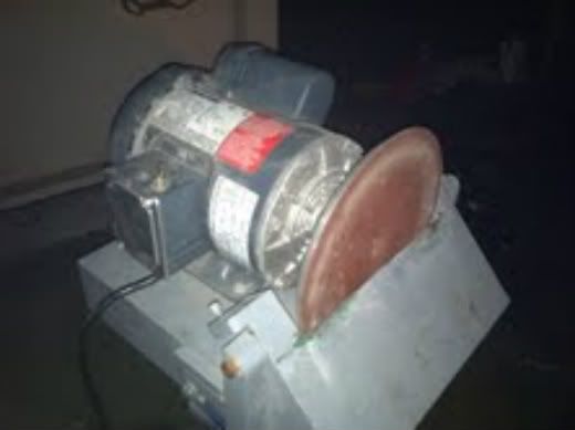

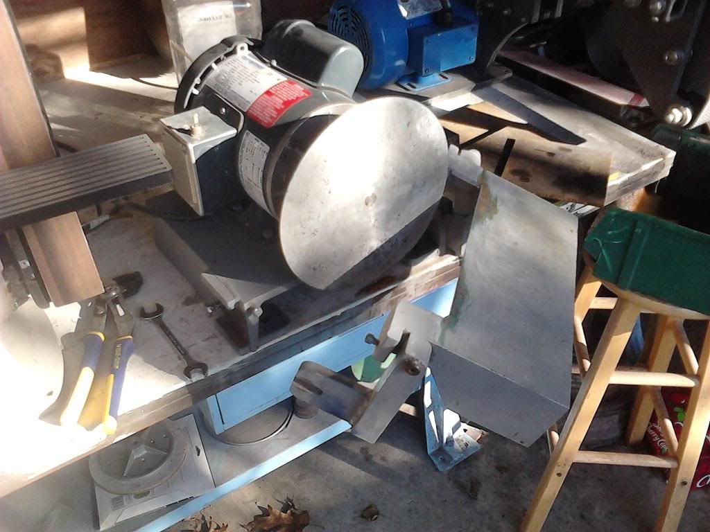

Btw, I have this disc now. It's from RW Wilson. Adjustable in and out, work rest swings away. is on a 36" stand, and indexes from 45 to 90 degrees......
Google him and see what one costs? It's bullet proof.
Sorry for the crappy pic on the second one... :D

I have the 12" Delta and use it every once in a rare while. I have a variable speed, REVERSIBLE, 9" disc, and use it on EVERY KNIFE that leaves my shop.
IMHO, the 9" disc set-up by RW Wilson that Brian posted is, ideal.
The 9" disc sander set-up like Tru-Grit sells is very very nice. However, you can't use it to finish off flat grinds very easily because of how the work rest is situated. It's a beautiful sander with the anodized blue color, and precision work rest and works great for things like dovetailing bolsters... but I can't grind a blade on one.
The RW Wilson design is awesome as it would be super easy to get the work rest out of the way for finishing flat grinds, and super easy to put it back on for things like truing up dovetails.

The stand by RW is easily converted to allow the disc to be both vertical and horizontal too... pics later..:D
R.W.'s set up is nice.He had one at the show in Ft.Worth.His number 304-670-5643
I've posted pics of these before, what is slick is how fast you can change paper or go to
dead square in seconds. I made a bracket to fit the "C Face" motor (copied from Terry Davis).
