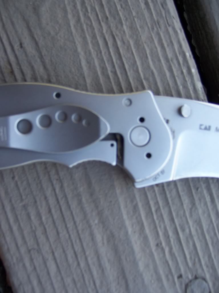

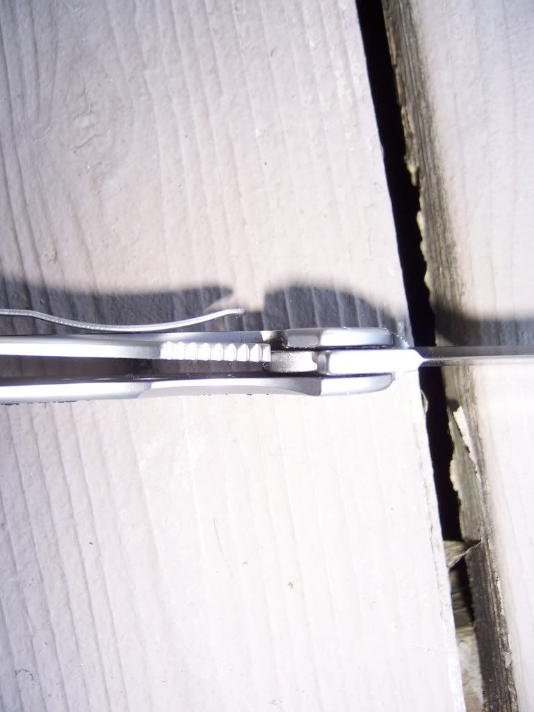

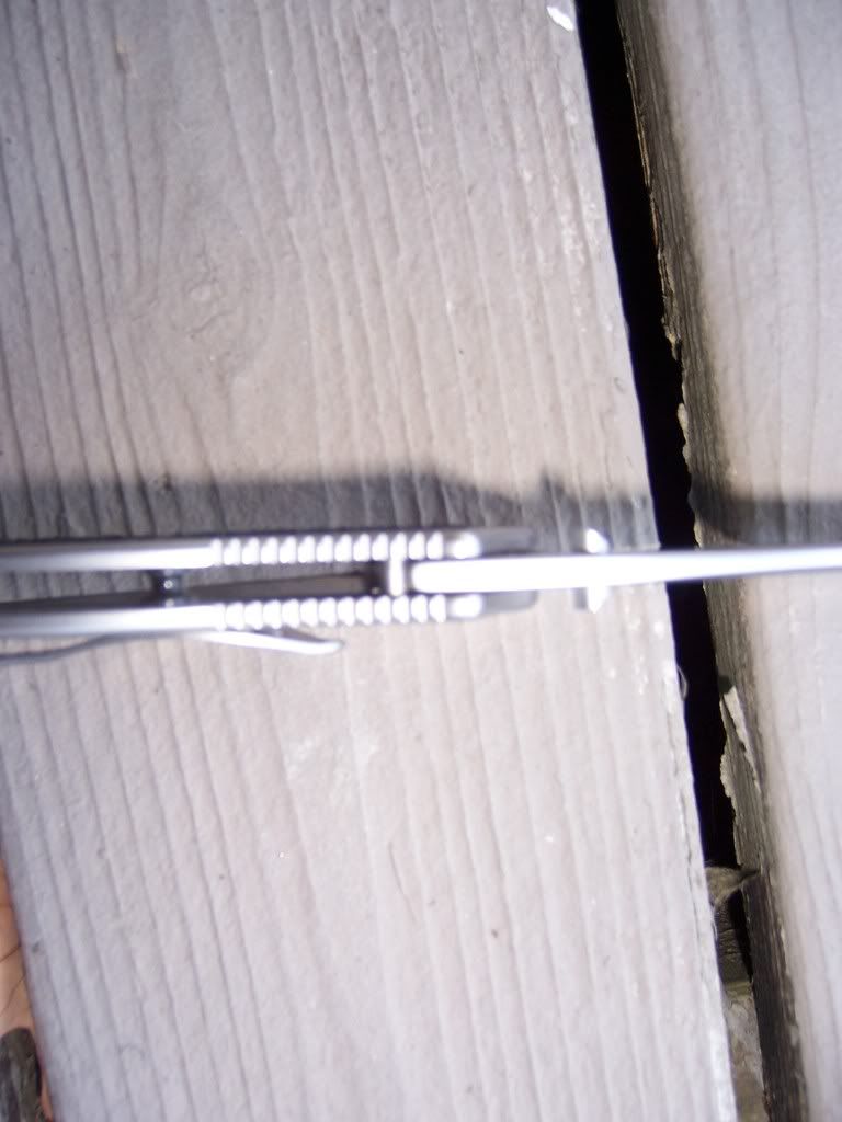

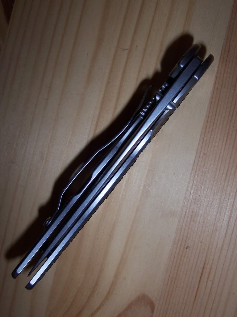

I have a kershaw storm that has developed exessive blade play, the blade just rattles around in the handle when you shake it back and forth. I have tried tightening the pivot but the play is still there (it just doesnt rattle). I just ignored it at first but it's getting steadily worse. The thing is that I had exchanged my first storm which had the same problem for this one so is it normal or do I just have extremely bad luck? Anyway I can fix it?
Definitely not normal. I always suggest tearing it all the way down. Tightening the pivot should fix the problem.... It sounds like you have a bigger issue. Check to see that your knife has both washers and that the lockbar is making proper contact. If you get a chance to check the stuff I mentioned report back in this thread and we will see if we can take it from there. Also, if you have a camera, pics would be most helpful. (inside of the picot area and the lock up on the lock bar)
Here are pics from all angles I could think of, (I know, It needs to be cleaned:o)
hope they help.
If it's up and down blade play, you have a lock problem.
You really need to get it back to Kershaw.
