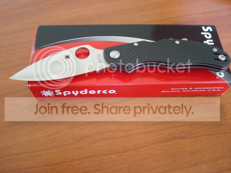

I bought my Spyderco Caly 3 several months ago and fell in love with it. It was one of the nicest folders that I've bought, and has since then turned me to Spyderco for many of my money-spending options.
But I've noticed in the past few weeks that the lock-up in the Caly 3 has developed some movements. It used to be rock-solid, but now it has some up-and-down movements that you can feel and hear. The movement also involves the lock-bar, which moves with the blade when I wiggle it.
I've only really used the knife for light-duty uses, so I don't know if this is a normal development or something of a lemon.
Now I have played with the pivot screw to adjust the tightness of the pivot, but I don't think that messes with the up-and-down movement of the blade. Can anyone with Caly 3 tell me their experiences with the lock-up? Thanks in advance for your input.

The lockbar pivots on a pin going through the handle. So there has to be some slack in there to allow for movement. And then there are blade to lockbar interface and the blade to pivot screw interface. All these moving bits press against eachother and tighten up when force is applied to the edge. That's what you're hearing and feeling. The necessary tolerances translate into tiny movement of the blade. Nothing to worry about.

Tiny amount of vertical play is inherent in the lockback design. I know its annoying but its just the way it is and sending it in or getting a new one isnt going to fix anything. Now if you have significant vertical play and not just normal 1-2 mm movement with the clicking noise than by all means contact Spyderco and they will take care of you.
