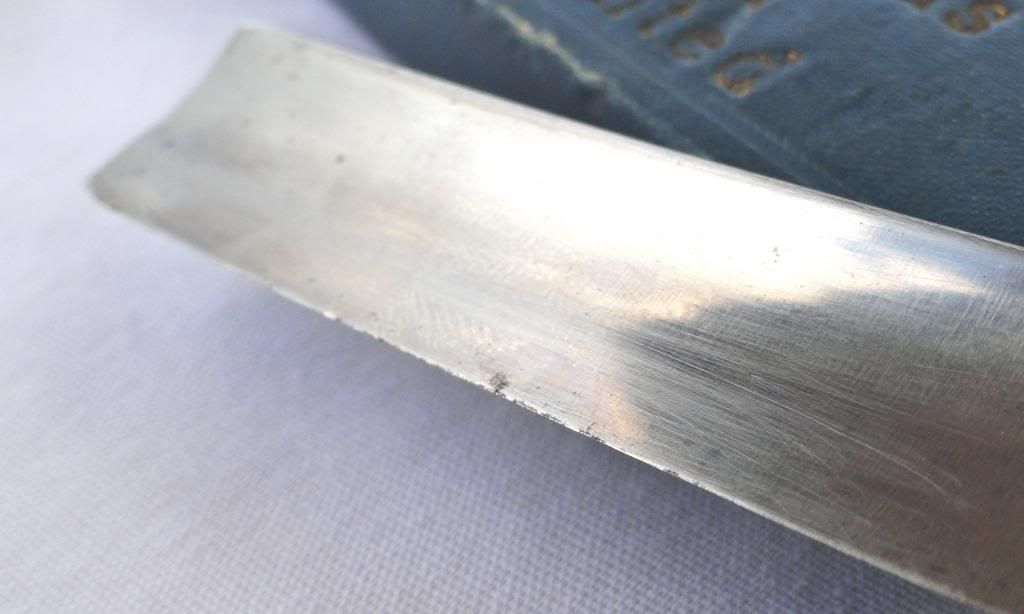

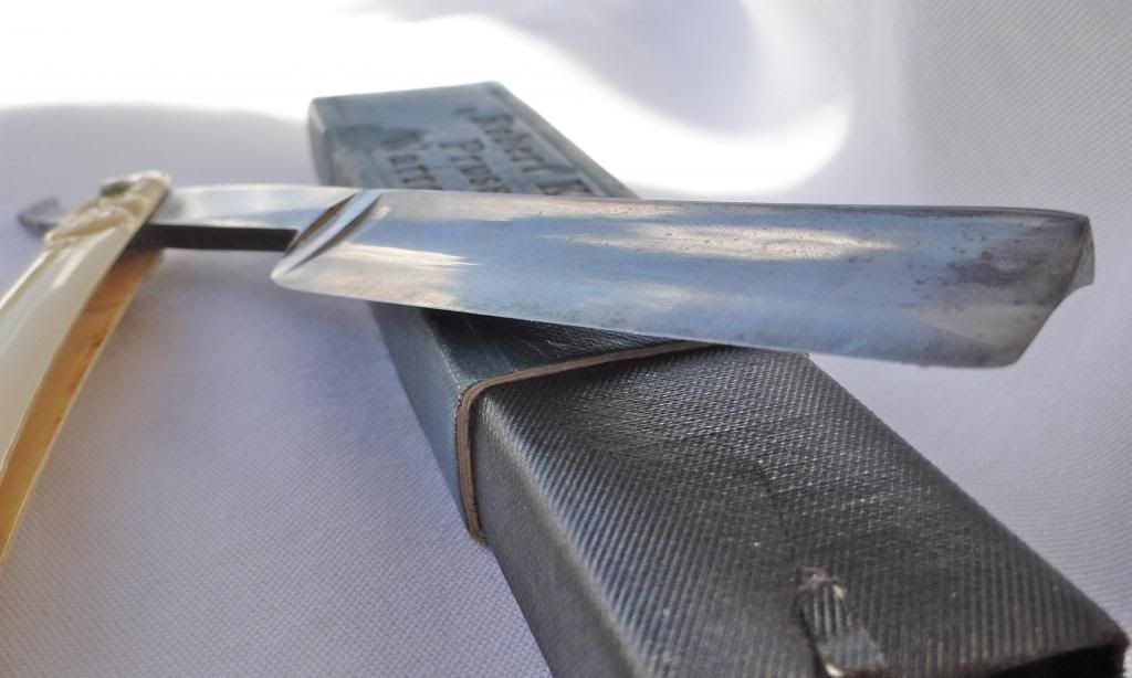

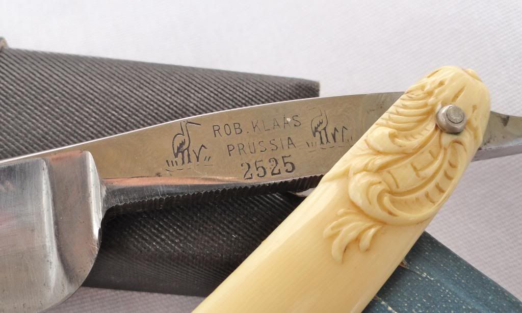

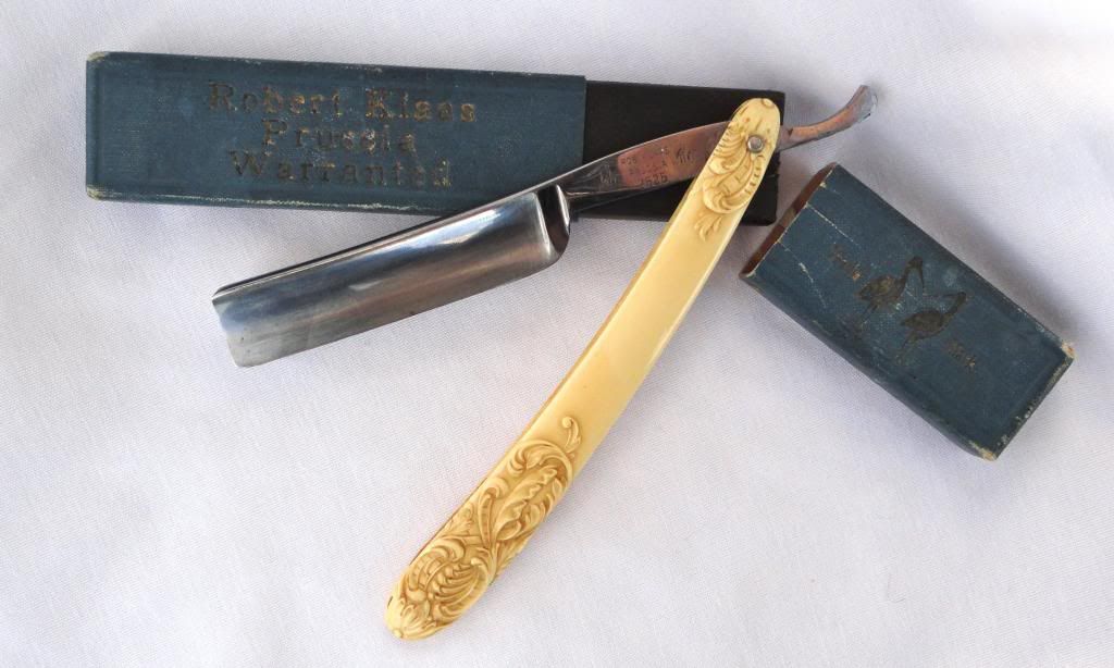

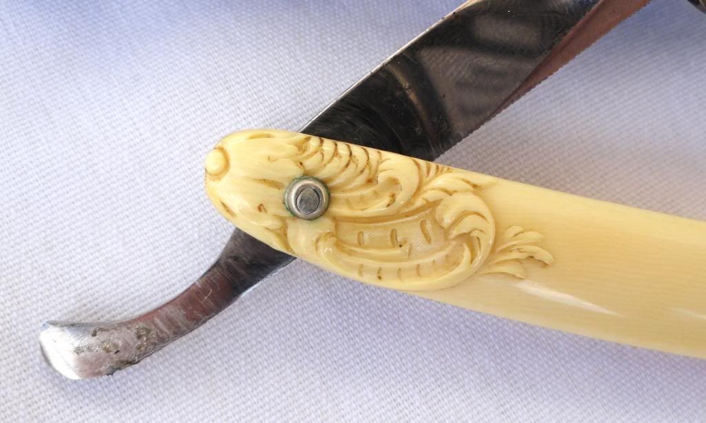

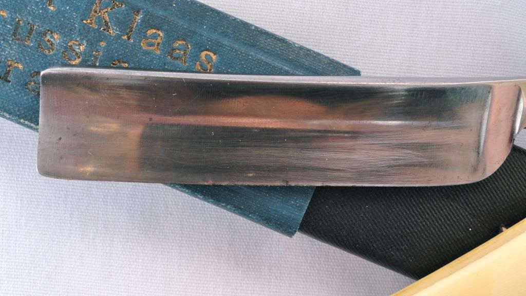

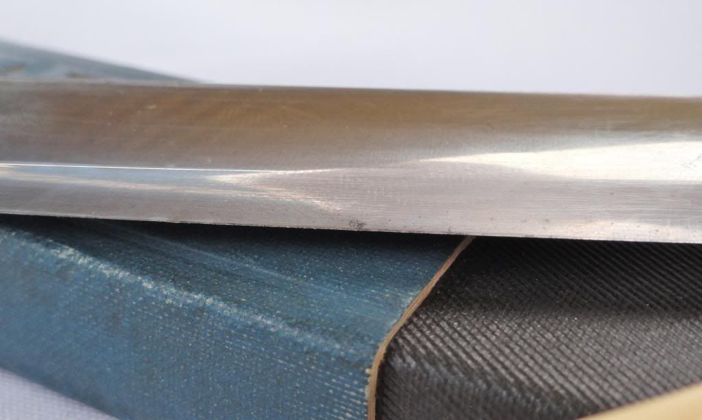

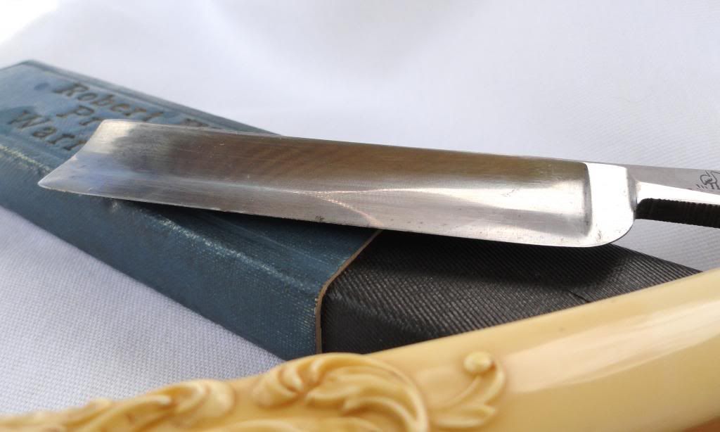

Wondering if anyone knows much about this razor? I haven't been able to find much info on this specific model. Only thing I can really tell is that it is early 1900's since it was made in Prussia. From the little that I've found, it probably isn't a real expensive razor, but wondering if any of you know much about it. Also, does the blade look salvagable? It is a little rough, but also has a couple very small "dents" in the edge, although they are pretty hard to see in the photos. I'd like to get it honed if possible and try a shave with it. Thanks for lookin.

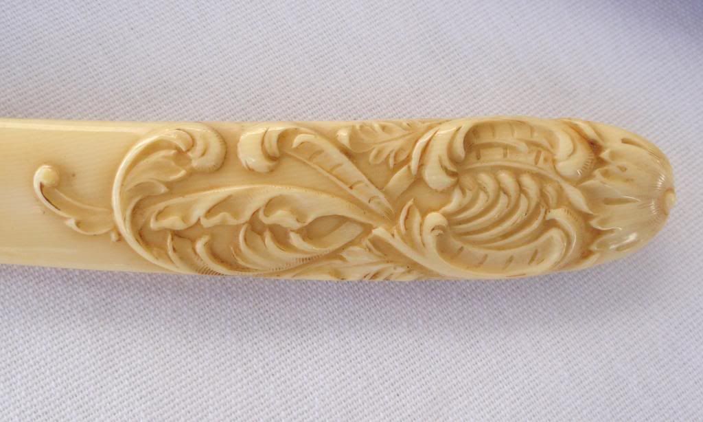

I'm no expert but I would say it's definitely salvageable. I love the handle.
It needs a little love, but it certainly looks viable. I have honed/repaired FAR worse specimens.
It appears to not have much hone wear and a slight smile at the tip. I'd say you have a great starter there.
Robert Klaas is a famous name from Solingen, not Prussia. And that looks like a fancy ivory handle, not some entry level item. It would be interesting to hear if anybody in Bernard Levines ID forum knows anything about it.

That would be a solid B+ in my book, definitely hone-able and ultimately useable. None of the usual signs of a dieing blade, and even if that is just celluloid-faux ivory, those last much longer than clear amber or tortoise shell celluloid, so no worries there. Great score!
Thanks for the info guys. After some more searching for examples, it does appear to be celluloid, but I still think it could be hand carved. Definitely a "fancy" set of scales. Plan to fine someone to send it to for honing and give it a couple trial runs before I decide to go hardcore into the straight shaves.

I have a fair amount of experience honing razors and I would say that yours almost definitely can be made shave ready. There is corrosion at the edge but it's nothing severe. It clearly needs an entirely new bevel set and that will likely eliminate all of the corrosion but the honer will need to watch for that to make sure. I don't see any other issues with it so it should be easily brought back into service.
