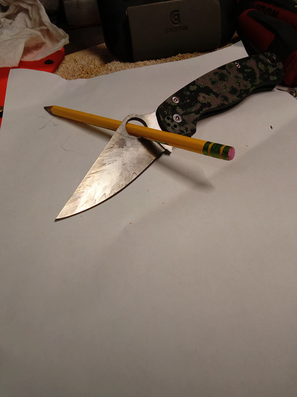

This knife has had three different treatments. Yellow mustard, brown mustard, and yellow mustard with apple cider vinegar added. It's tough. It's rather difficult to get it to actually rust. Make sure to wipe the blade off at the end of the day. Pocket sweat= salt water.

I love the look of that! Did you smear the drops of mustard down the blade intentionally to create the pattern (as much as you can call it that)?
Squirt a line of mustard of about an inch. Then use one of those soft silicon spatulas to wipe it out from the line into a flame pattern. Leave it for at least 12 hours. Until the mustard dries up. Then scrub it off under the kitchen faucet using dish soap and a toothbrush.
The very first treatment sets the pattern.
Before you apply the mustard. Clean the blade with acetone. You want clean bare metal before the treatment. Soap and water won't do. Acetone.
