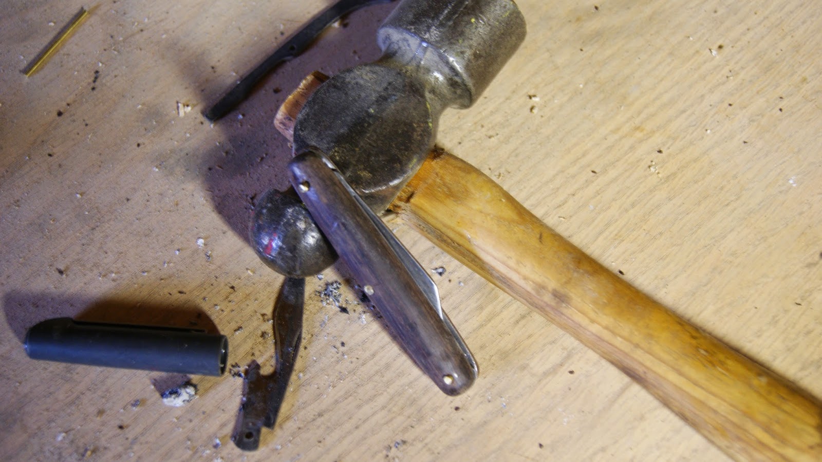

here's my lastest fail with a hammer brand that was all used up
I got it this far to find the blade and spring were not working together properly, it could fall out to a 45 degree angle when I turned it upside down :(
oh well, I learned this time form a post elsewhere that drilling holes into a hard surface to hold the pins while you work the whole thing together is a good help, and makes it less likely you'll cut yourselves putting the tension in the spring.
I'd recommend it as a good, fun and incredibly stressful way to spend your free time :D
Now I'll slink off, there are other successful and talented people around here who make this stuff look easy who can probably correct all that I just said :thumbup:
