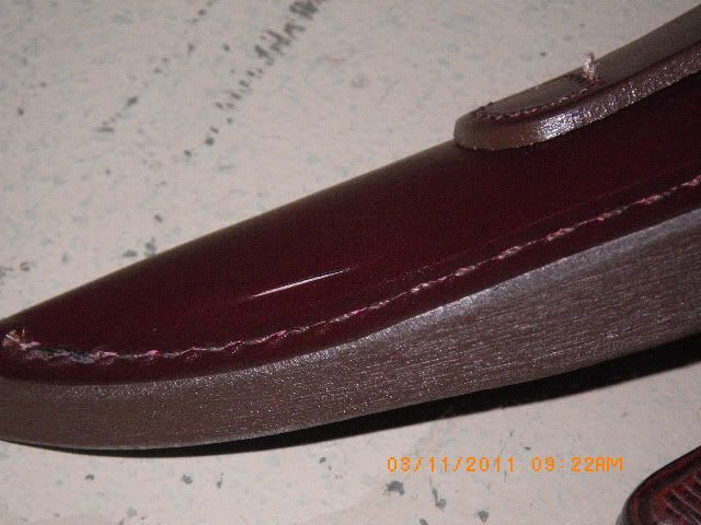

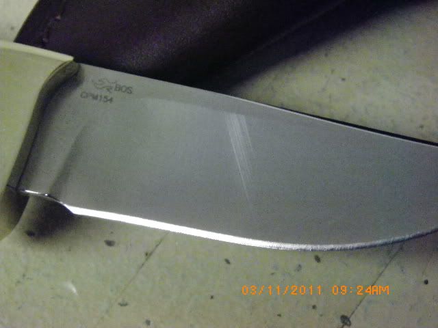

However, the blade is scratched.
And it appears the blade is cutting through the sheath.
I'd planned on using this one from time to time and wasn't initially put off by the scratches but after thinking about it overnight and finding the cut in the sheath I'm going to be contacting GPK and see about returning it.
Anyone else have the sheath issue? From what I can tell there is no liner in the sheath and when inserting the blade you can see the cut widen ever so slightly.

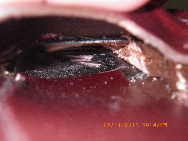

Looking at the interior of the sheath if appears it does have a liner of some type. In this photo you can see that the blade has cut through that liner and and sheath.
I would think that the purpose of the liner would be to prevent just this type of situation. Checked Bucks site and they only show the nylon sheath for the Gen 5, not the leather.
I would send it back,we all know they will fix it,but what makes me upset is why doe sa new knife need fixing/Any old 110 2 dot style i've ever beren lucky enough to get my hands on has been perfect,zero issues.I've handled over 25 buck 2110's at 2 different walmarts,they still come in boxes there,i would have bought 2 out of 25 whats up????
This is just a guess, but I think that the blade got pushed in behind the liner at some point. That may have caused the liner to collapse a bit so that when you insert the knife now, the easiest route fior the knife to take is behind the liner. I just fooled around with one of mine for awhile and the fit is so tight, I doubt if I could tell if the blade was not going into the liner.
On second thought now. I looked into my sheath with a flashlight and I can see where the blade has cut completely through the liner in exactly the same area as the cut in your sheath! Mine just hasn't cut through the leather yet. I looked inside a second sheath and the area inside the liner is much more open and not as squeezed together as my other one.
I'm betting that Buck has the leather sheaths, they just aren't on the website. I think I'd send it back to them, sheath and all.

Those scratches aren't from the sheath, but probably from mishandling before it was sold. My guess would be the same with the sheath. That's great that Buck is taking care of it, but its ashame it wasn't taken better care of prior to being sold.
Your correct, the marks can't be from the sheath, the run across the blade not with it and the sheath has no side to side play.
How do you figure it's mishandling? There is no way the knife will fit into the sheath without piercing the liner and the sheath itself, it's not built right. How is that a result of "mishandling"?
The blade could have been scratched by the dealer that sold it but how could you say with certainty that's what/where it happened? At the least they would have had to unbox and unsheath blade in order to scratch it. Do most dealer even inspect every knife they get let alone damage them in the process? I guess if they had it in a display case it might but since they still have this model in stock that would seem unlikely.
I've got a spot on the blade of my Kalinga Pro folder that didn't get buffed/polished from the factory. Things do get missed that shouldn't.
I tried to take pictures of the insides of two sheaths with no luck today. If you will take a close look, you'll see four layers of leather on the stiched side. On one of my sheaths, the liner appears to be trapped between the outer layers front and back and the inner layers. That liner works find and there's no issue with cutting it.
On the other sheath however, the liner is not between the layers, but is pinched together at the blade edge side and is a super tight fit. That's the one that shows the cut in mine. It hasn't gotten to the leather yet, but I've no doubt that it would in time.

Sounds pretty much identical to my sheath. Also the sheath has a twist/curve to it. Pretty hard for a short rigid blade like this to curve to match the sheath. It can only go straight in and somethings got to give way which in this case it's the sheath.
I've inserted the knife into the sheath maybe 20 times now and there is now liner protruding through the slit on the rear of the sheath. Pieces of the liner are coming off on the blade so it's continuing to worsen as the knife is inserted and withdrawn.
