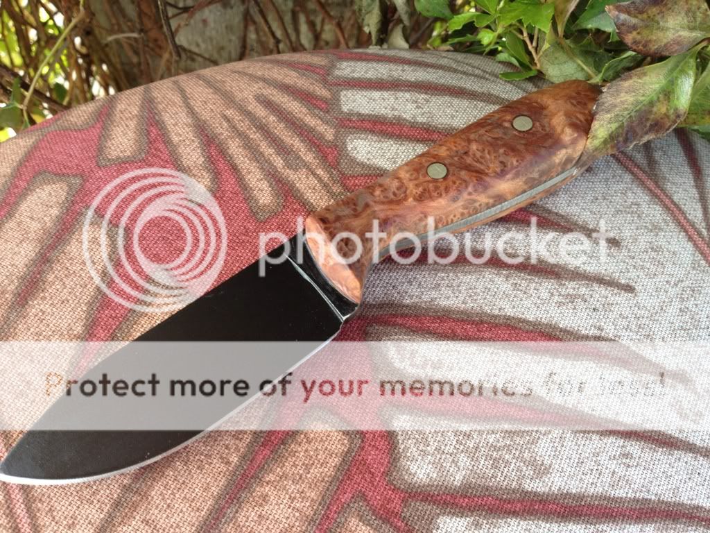

Got a nice double delivery today, some redwood slabs and a Becker BK14. Let the mods begin! I couldn't find any pics of what I had in mind so I just jumped in.
First up removing the guard bump by the blade ( still need to round it a bit more, but that's for tomorrow
More to come as I finish and handle it so my bk7 has a companion
Done!
Here with it's big brother

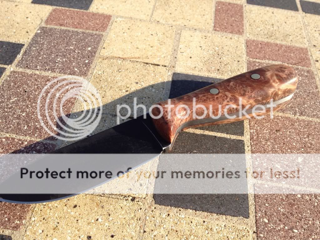

Getting there, sanded to 400 and soaked with tung,
Still going to fill voids, go back to 220 up to 1000 or 1500, more tung, a final sand up to grey mesh then polyurethane
Gorgeous woodwork. people 'round here seem to have as good of taste when it comes to woodwork as they do with steel :)
Wow that looks fantastic.

Not at all, the block was $36 I got it from Burl Source ( they are a supporting dealer here) And they cut it into 1/2 thick slabs.
