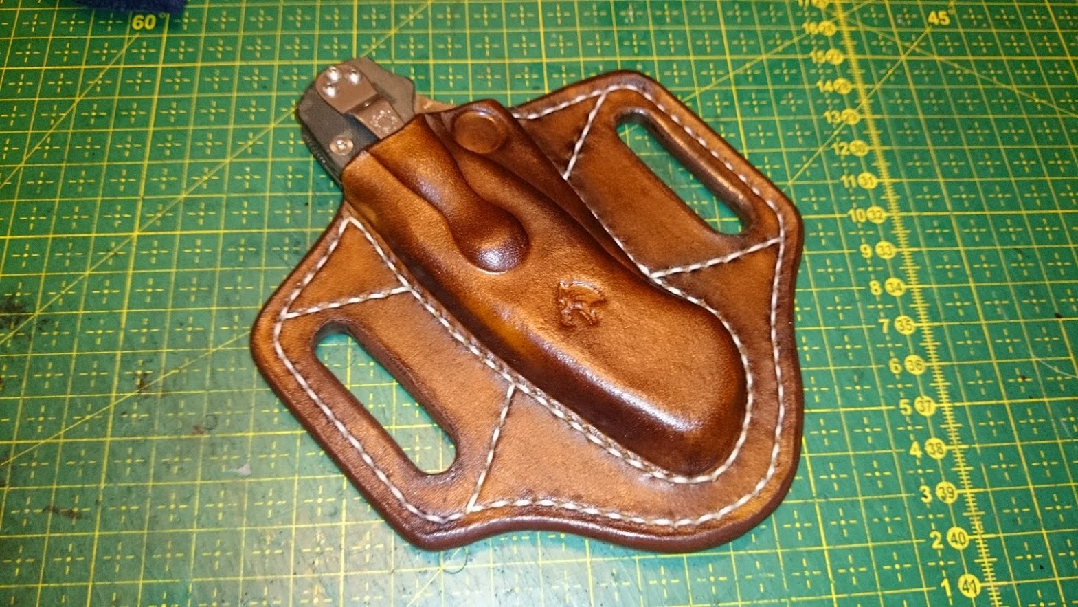

Wow now that first video, man, that was a LOT of work already done there! on some of those it looked like you had used a bit wider than needed? in any case, pun intended, the forming looks great and the pancake sheaths are cool, one thing nice about a pancake sheath, is if the client is going to be in a rougher environment, lot of action/climbing/hardworking type thing, they can slip their belt under the first loop and OVER top of the sheath, this will provide even stronger retention from how tight they do their belt, making the knife even more secure for that days work.
G2
Thank you Gary.
I like doing pancakes .
Its more than 60 % of my productions.
Good idea with alternative carrying.
I have to try it, should work :)
You're right , these wider are horizontal.
For belt up to 2 ", so width is about 2,5 "
For better retention i do two seams, but often clients wanted two seams even if they are not needed.

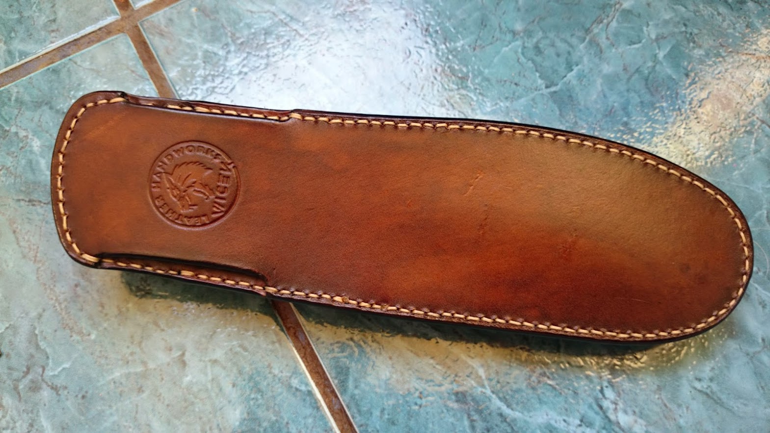

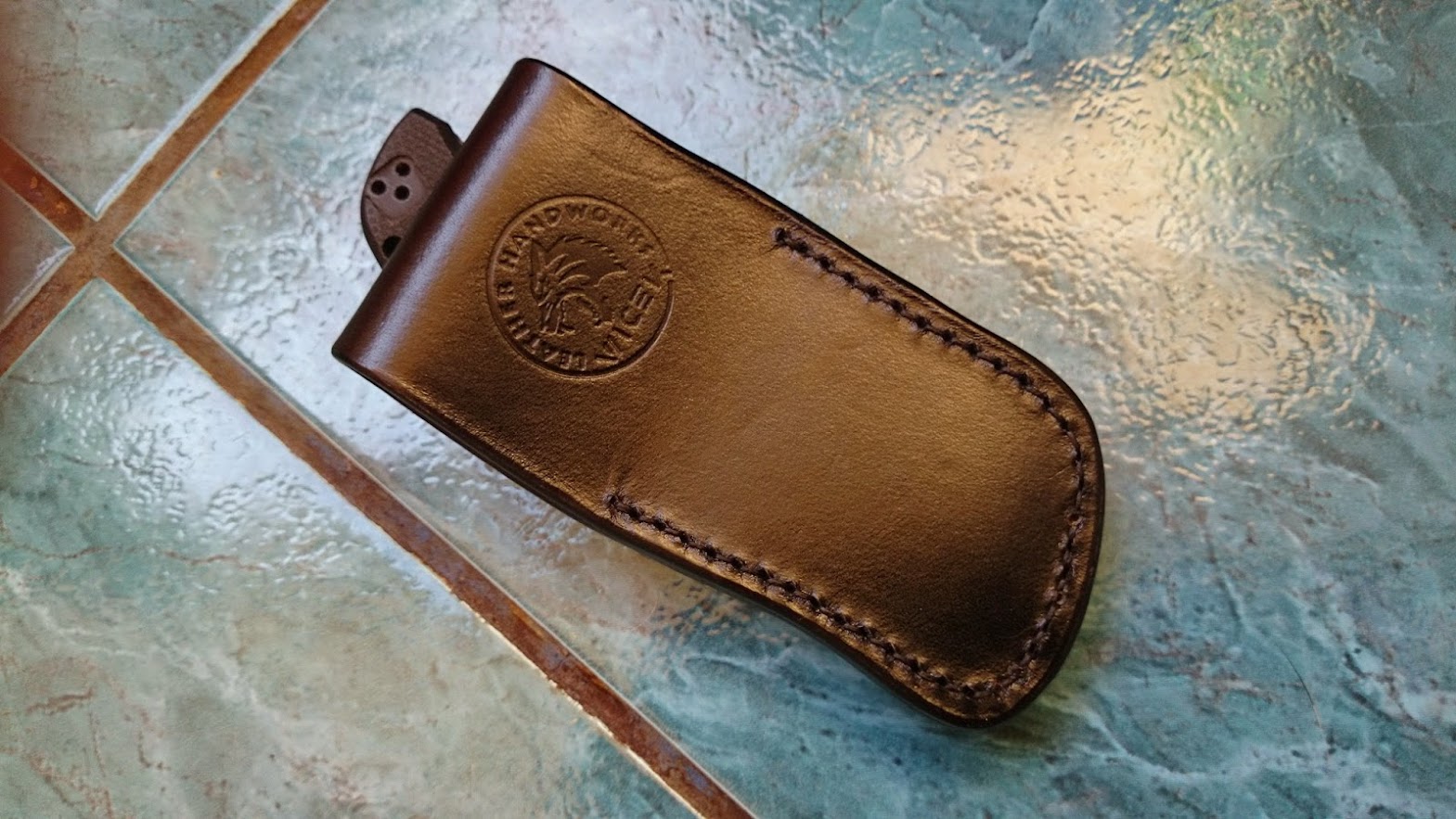

o5cVeqtD1fDs_QnpfeOmLbeYXWTv92yxreYpGHTQEmY=w1569-h883-no
NGlV__Rdp1dE2Vz-z_69YIpMSjWADV8itphgDB_KLqM=w1569-h883-no
Wow again, very nice and now it makes sense why some of the molded starting sheaths are so wide on the sides, they are intended for pancake sheaths! of course ;)
Double stitching, what a pain, I feel for you sir, and yep, doubt it would ever be necessary to have to do that, but it adds to the overall look of the sheath.

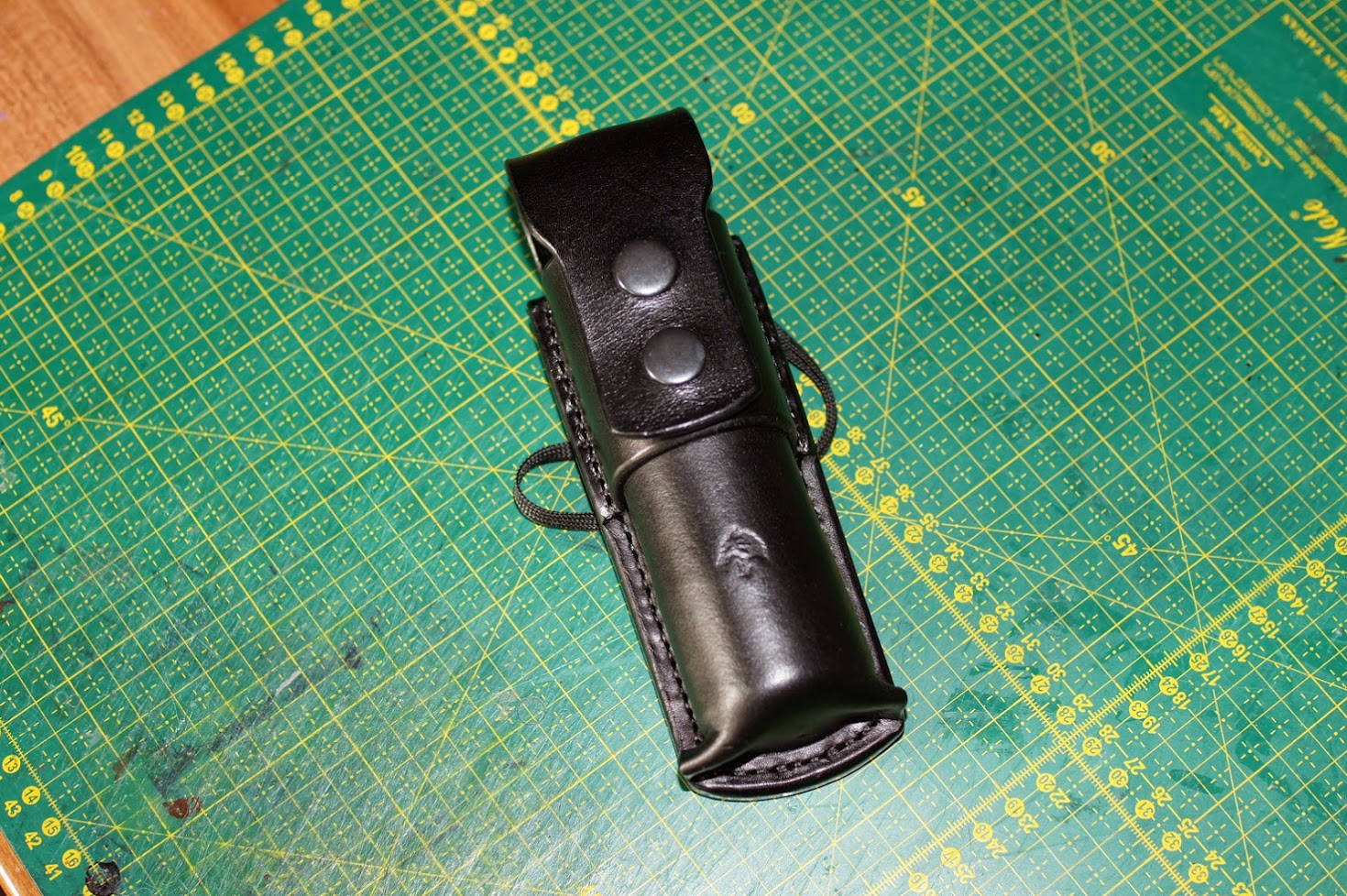

I'm most interested in the black flashlight sheath. It looks great. Would you mind describing or showing how this formed, constructed, and then finally stitched so close to the edge? Do you use a curved needle?
Thanks, in advance.
