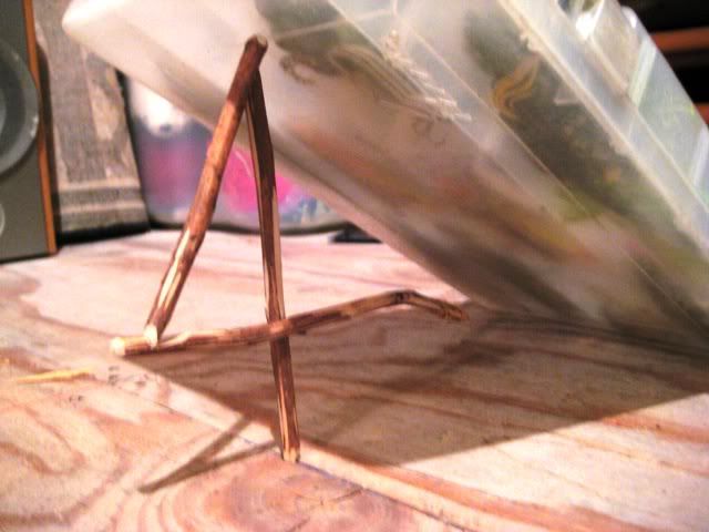

Seriously though, what are your top three favorite traps? I'd like to expand beyond the Figure 4 and am thinking Paiute deadfall next. Just wanted to see what other people consider their "go-to" traps. No knife, knife, cordage, and snare wire are fair game.
FIg. 4 FOr the sheer versatility of it

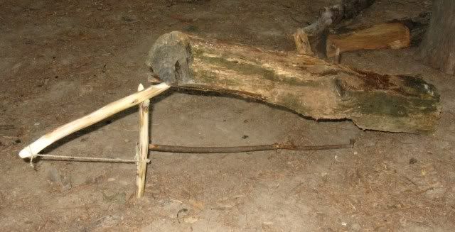

Yeah, I really just want to learn and become proficient at making and placing only the most practical and versatile. I don't trap here, ever. But I want to have the knowledge/ability/experience if I ever need to. To that end, learning how to make and set 3 different ones really well suits me fine. The figure 4 I'm getting decent at, just working on tweaking sensitivity now. And I usually carry a small bobbin of snare wire on me when out hiking.
Dipbait, you're one up on me, haha :)
Come to think of it though, I did make a figure 4 once at a local lake park (got many looks while doing it...). I set it up near our blanket and baited it with with some bread. There are a few ducks there that just wander around and beg food off the people picnicking; eventually a group of em made their way over and one takes the bait :D Well, actually, first it stole the bait right off the stick without springing the trap (Lesson learned - increase sensitivity and make bait as sticky as possible). So I started throwing crumbs in the grass beyond the bait stick. Sure enough, the duck was stupid enough and came through the trap picking at the crumbs, finally triggering it. When the trap sprung, it fell right over the neck and brought it to the ground. There wasn't much weight on it, (it was more of a proof-of-concept deal) so the duck managed to pull itself out after a second or two as it panicked . But the trap worked :)

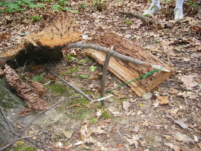

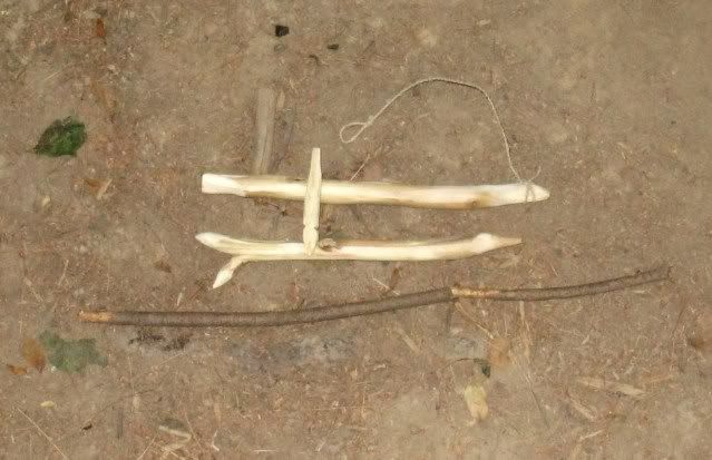

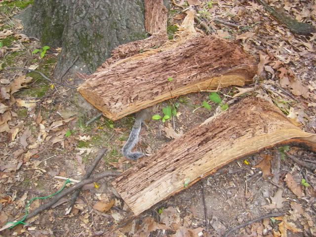

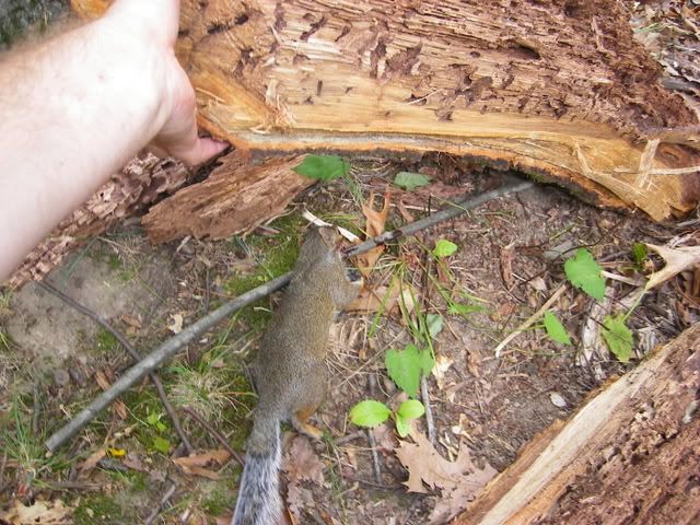

The Paiute is my Go-To trap. I have a series of simple snares that are easily turned into rolling snares in my kit but as far as quick to set with high sensitivity its hard to beat a Paiute IMO.
Lately I have been pointing the bottom of the Paiute's main stick (the vertical one) as well as selecting one with a natural V in the top. This makes setting it much faster while not having any effect on the traps speed or sensitivity. Here is one made with yucca cordage.

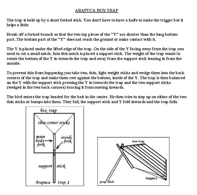

The Arapuca, thanks to brother Pict ..........

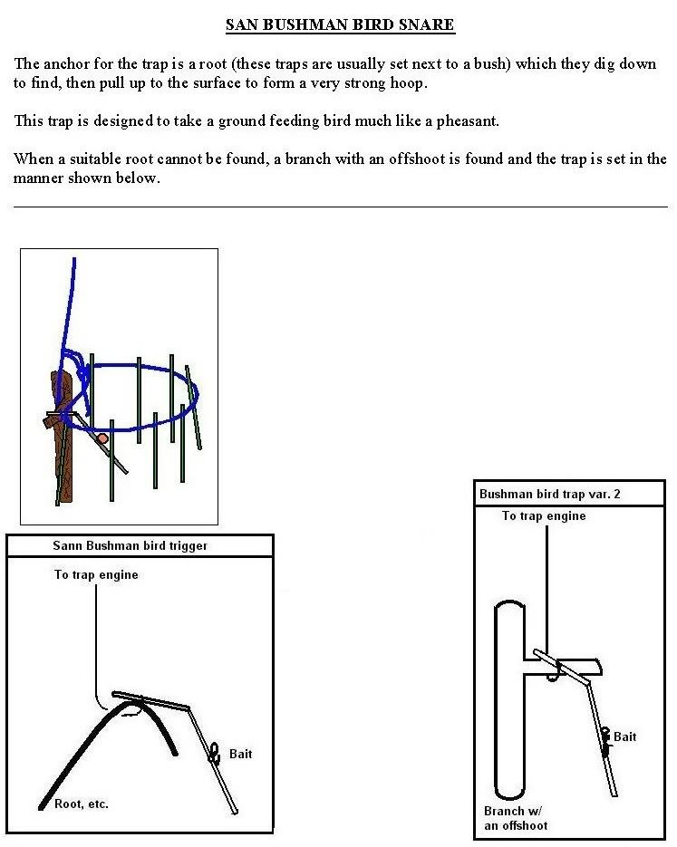

The Sann Bushman bird snare...
and some links to previous threads - here, here, here,

Doc, as usual, thank you :) If I recall correctly, you had a more detailed thread on the Arapuca box trap somewhere, I'll go look for it. I'm really liking that San Bushman Bird Snare...very simple. Found this great thread with coote using it:thumbup:: http://www.bladeforums.com/forums/showthread.php?t=418838
