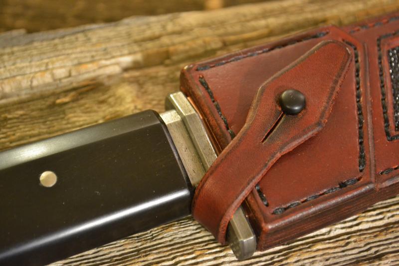

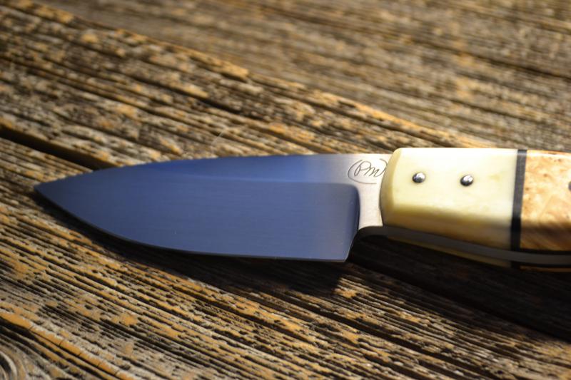

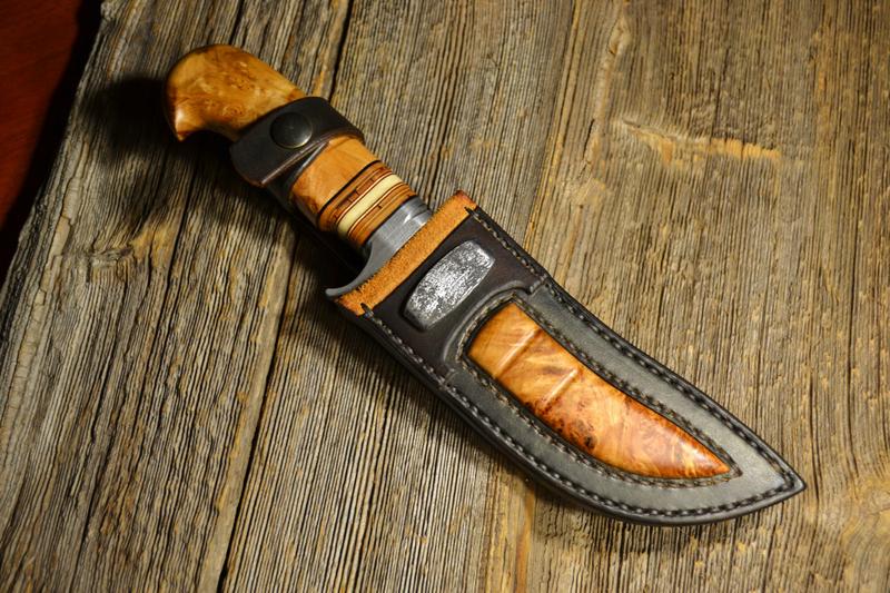

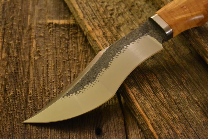

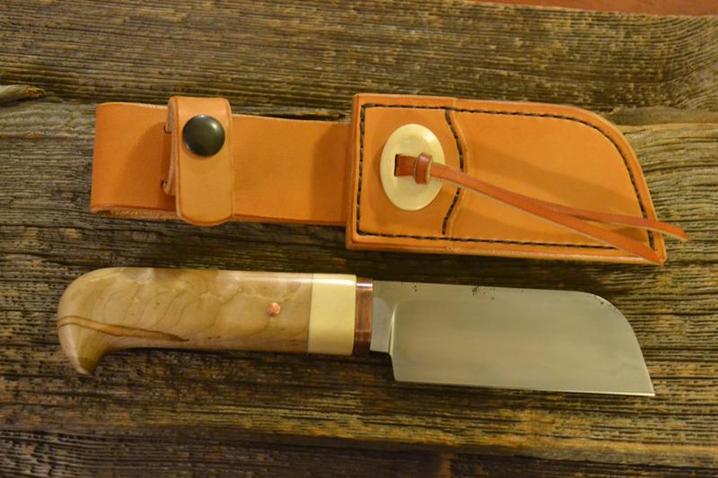

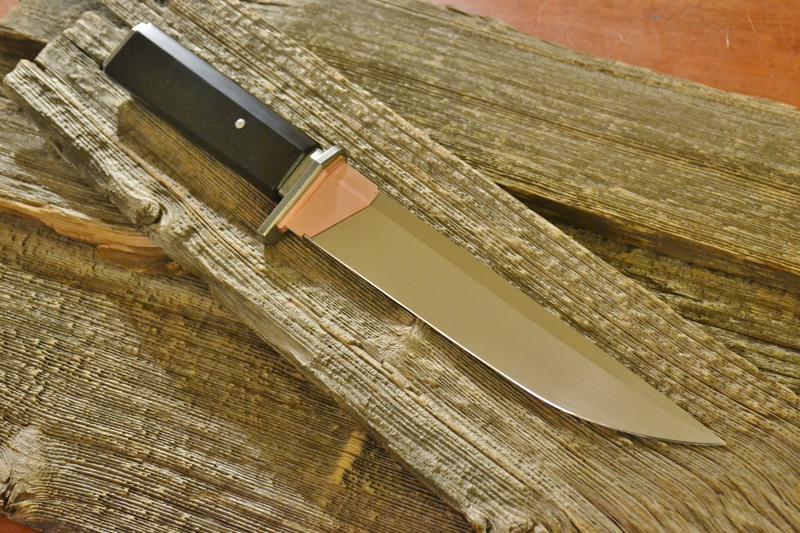

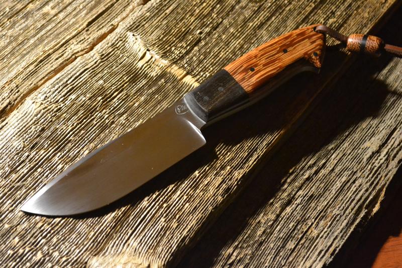

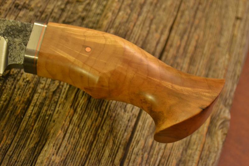

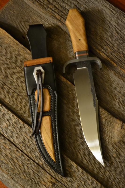

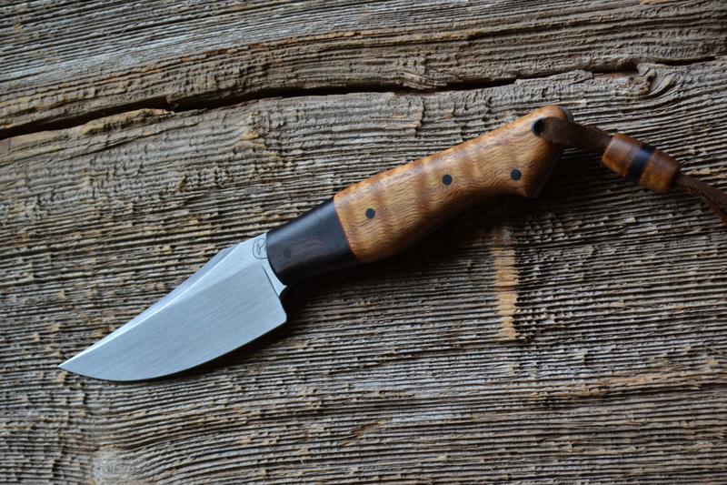

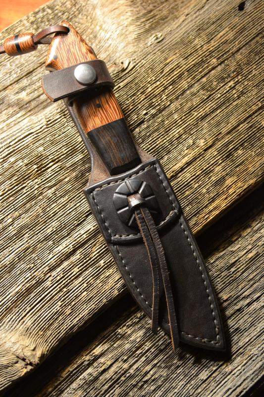

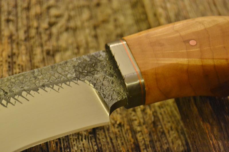

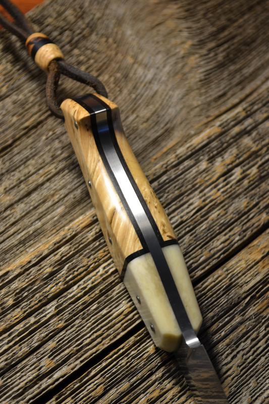

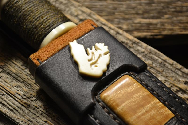

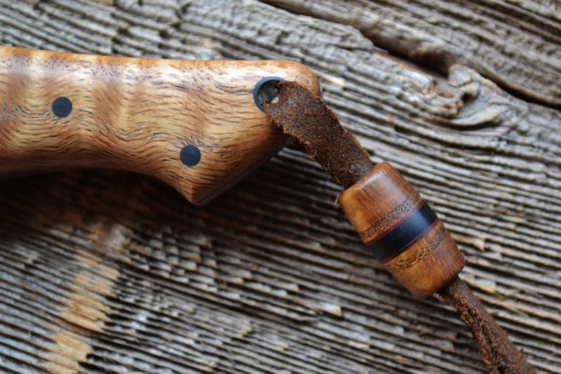

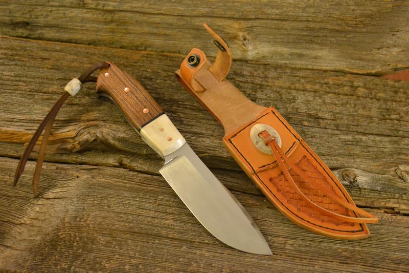

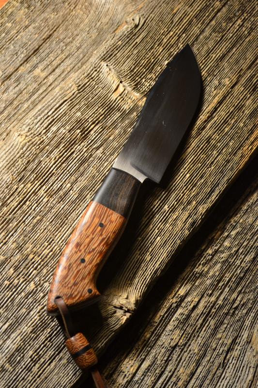

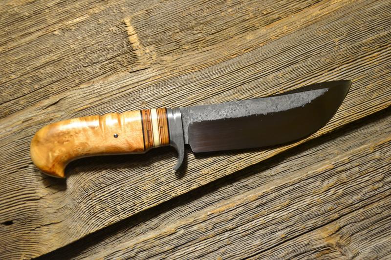

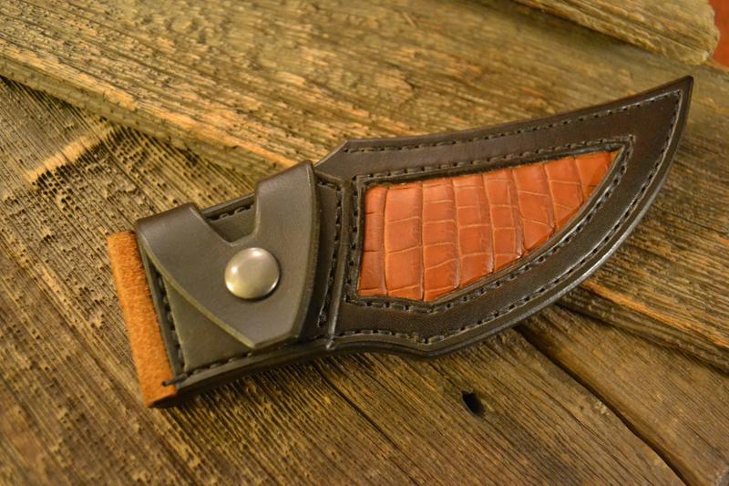

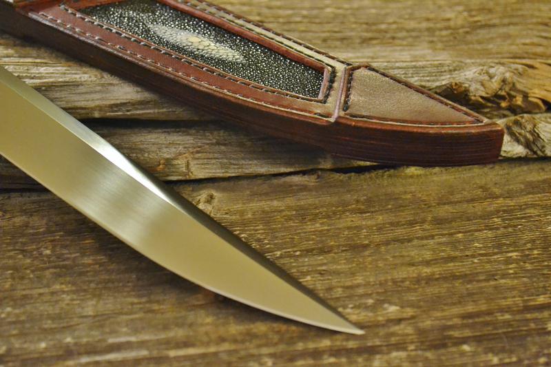

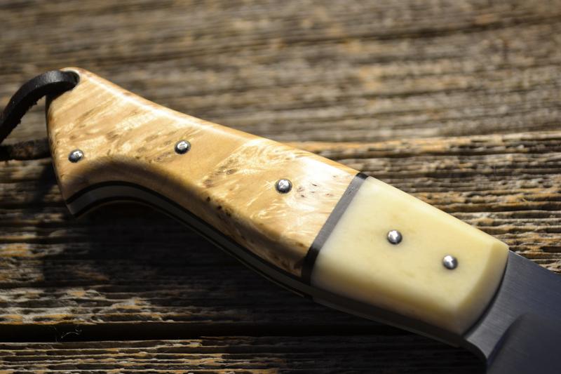

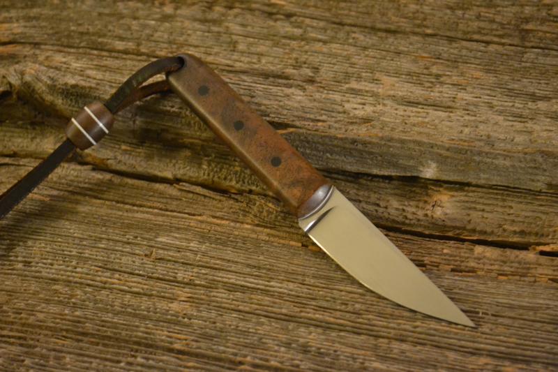

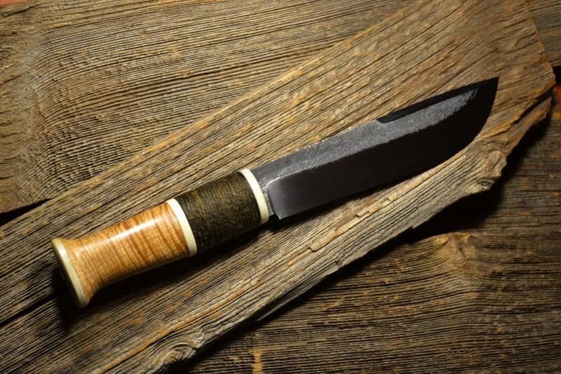

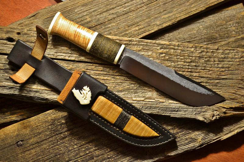

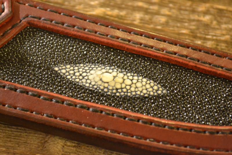

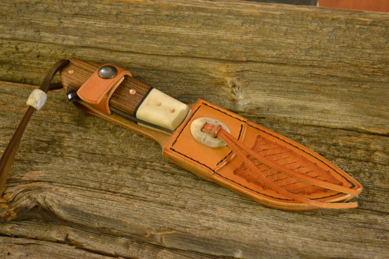

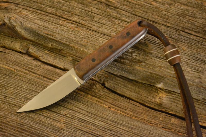

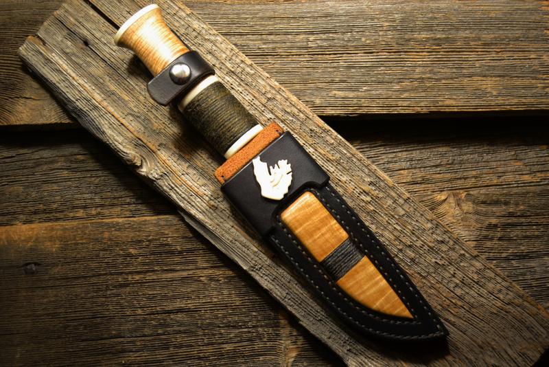

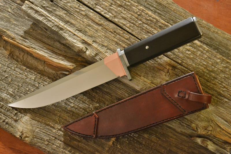

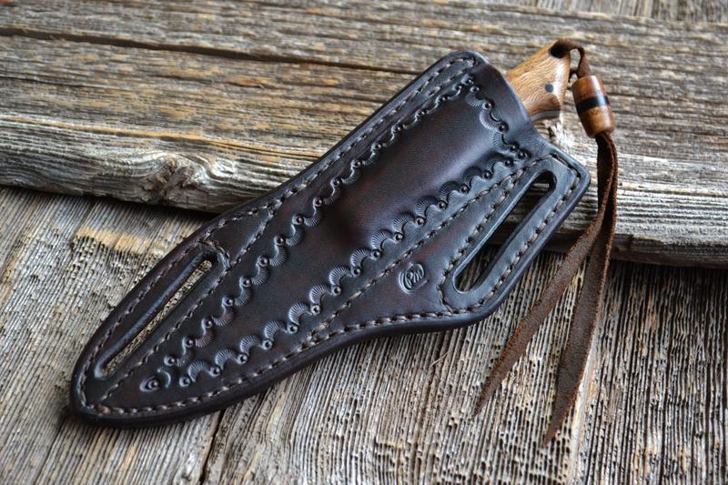

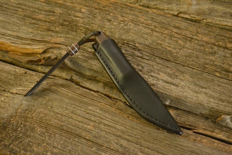

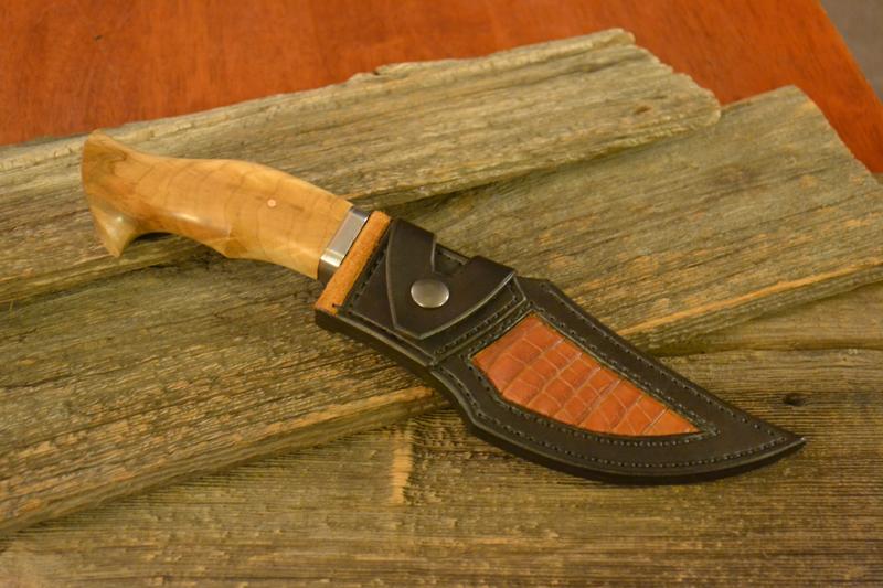

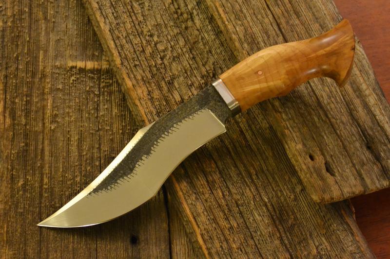

Rumors of my demise, although becoming increasingly more likely with each passing day, are still greatly exaggerated. I'm still making knives and I thought I'd show a selection of my work of the past while. My apologies for the reallllly blurry photos.
-Peter
Unnamed
3 3/4" of 1084, Ebony and Oak:

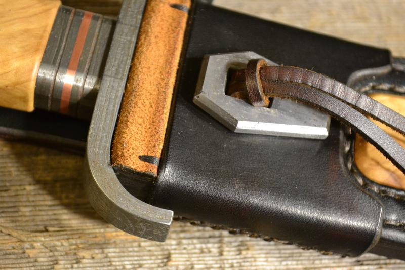

"Send It" (built for a "retiring" JTF2 soldier):
4" of 1084, Cape Breton Red Maple burl, Moose bone, ebony accents:
Barachois Hunter #1
5" of 1084, African Blackwood, and figured Red Palm:
Peter: Thanks for sharing - very clean work. My favorite is the rasp knife. :)
What a great variety! I love the warmth your knives have with the more "raw" and natural materials you use.
Just for fun, my favorites of the bunch are:
The Growler, Wrought'n Belle, Unnamed (rasp knife), and the Fusion Searle.

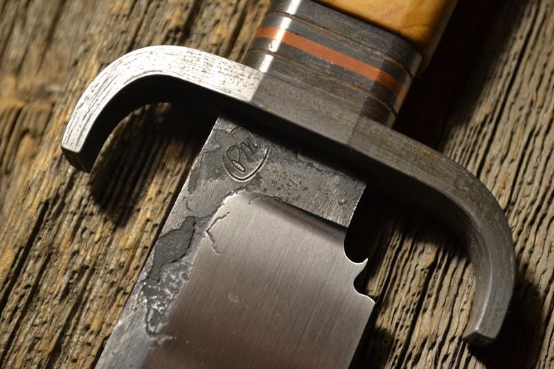

The Fusion is the most intriguing to me. I love how the shinogi (or grind line) carries through the habaki, guard, and all the way through the handle; it's very beautifully done and looks great. I also love how the pommel resembles a coffin, it goes perfectly with the dark and sinister feeling the knife evokes.

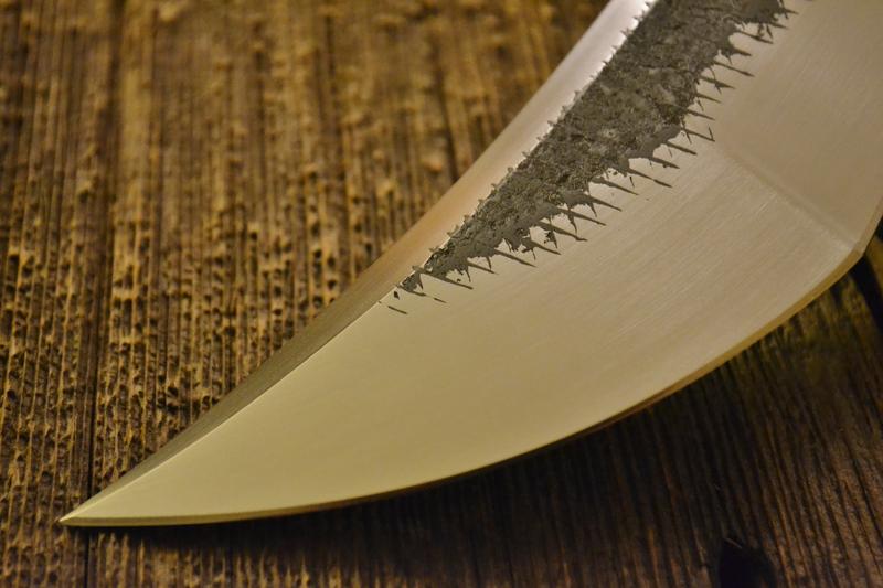

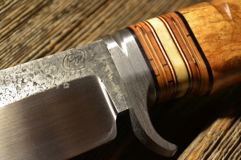

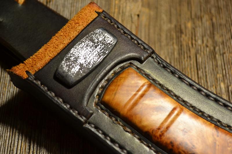

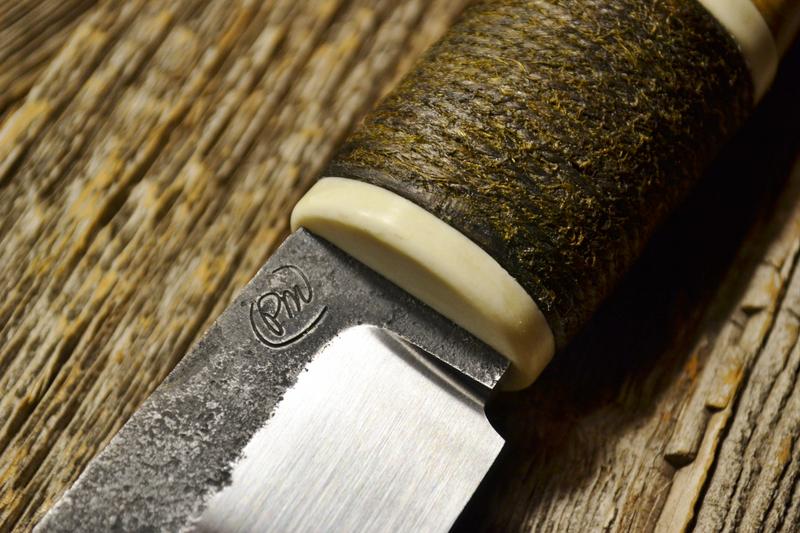

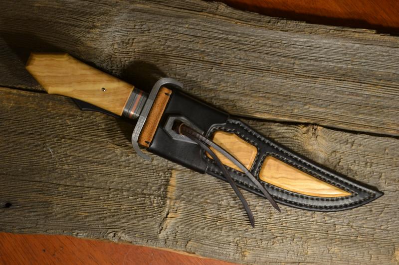

I hope you don't mind my asking, but what process do you use to etch your wrought iron guards? I'm actually just about to reach this stage on a pretty special knife that I've been working on for a while, and your etching looks perfect; light enough to keep the overall clean look of the work but still deep enough to show off the character in the grain. I guess I'm mainly wondering if you use ferric or vinegar to etch (and then go over with a scotch brite pad or something?). Also, do you use a resist in the guard slot? Sorry for the questions, but they really do look great lol.

Paul, The iron is polished to 600 grit then etched in a relatively strong ferric chloride solution for about four hours to give just a bit of texture, neutralized, then lightly polished with 1500 grit to bring out the highlights. I hope that helps.

Oh wow, that's a longer etch than I was expecting you'd say, at least in a strong ferric solution.
And thank you, that does help.
Oh yea, one more quick Q if you don't mind. Do you happen to use a resist (nail polish etc) in your guard slots for the etch, or does it not make a difference for you with guard's the fit up whether or not you do? I'm just a bit worried it may create a gap if I don't protect it, but also a bit worried it might somehow cause it to etch evenly around the slot area if I do, just not sure.

Paul - Yes, I use nail polish on guard/spacer slots and contact surfaces. I use the industrial strength Pink Glitter version I borrow from my 10 yr old daughter.
