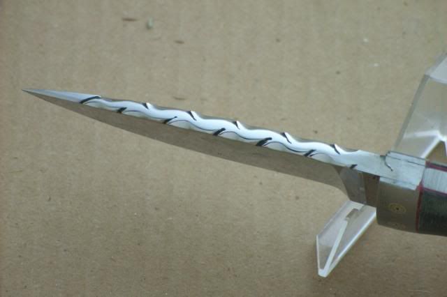

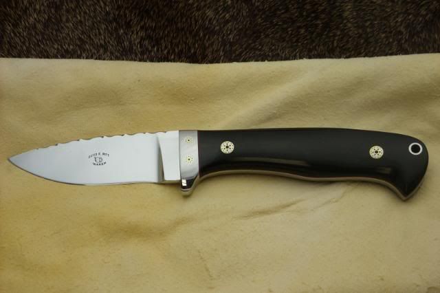

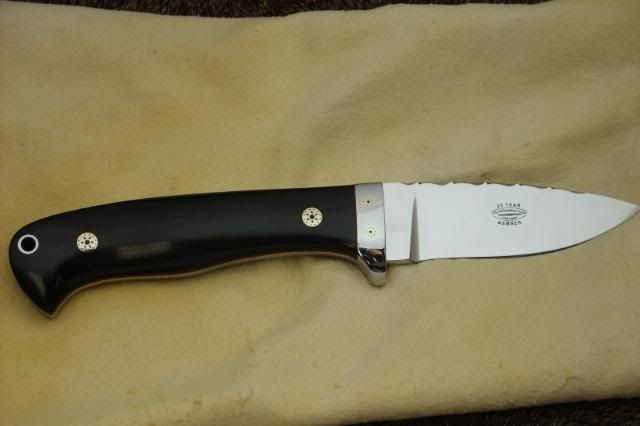

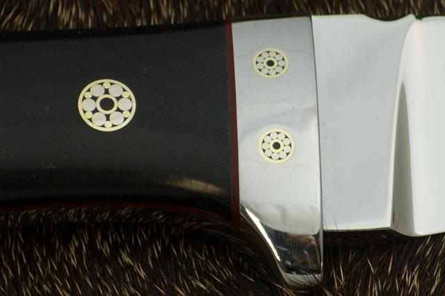

#1 Finished and delivered today. This is my Personal Drop Point Model made of 3/16" ATS34 2RC 62/63 it is Flat Ground and has a Mirror Finish and File Worked Spine. The Guard is 416ss and has Mosiac Pins the Handle is Black Linen Micarta with Mosiac Pins

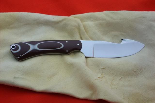

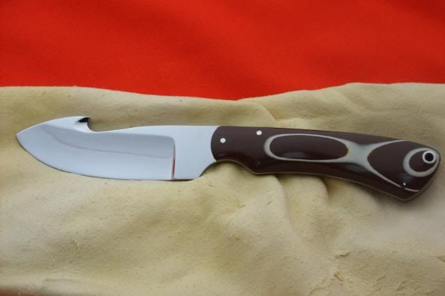

#2 Koala Guthook,This knife is made of 1/8" ATS#$ @RC62/63 and is Hollow Ground(rare for me) and has a Mirror finish.The handle is what I call White and Brown Chocolate Paper Micarta and has a White Spacer against the Tapered Tang.(needs to be Marked and Sharpened)

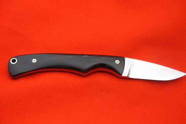

#3 Pro Caper,3/16" ATS34 @ RC 62/63. The blade is Flat Ground And has A Mirror Finish. The Handle is Buffalo Horn with Mosiac Pins and a Red Spacer against the Tapered Tang.
Wow, just the pins are spectacular! That was also a great job bookmatching the micarta. Very cool.
