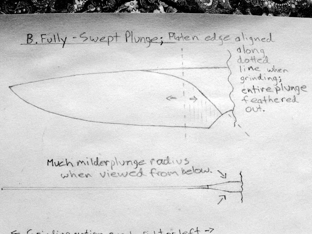

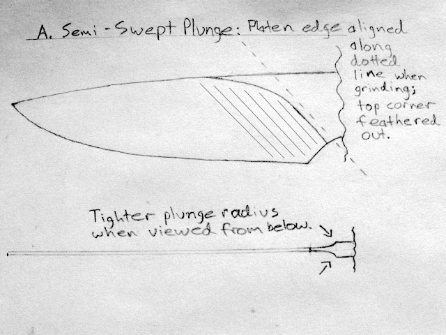

I'm going to do some drawings about that, I find it hard to explain with text (or at all) and hard to take pics of.

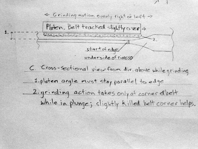

I would describe the process as "carving with the corner of the belt." I only had any repeatable, controllable success with it after I started beaming light right onto the area being worked, and watching it while grinding.
I'd also describe it as "pushing the bevel and plunge to 95% of where you want it, then lifting the blade evenly off of the belt while grinding into the plunge to gain the desired transition."
See? I can't explain it well. I'll try to draw it soon. Also, I don't claim at all to be a master of this stuff, some guys like Phillip Patton, Thomas Haslinger, David Broadwell, etc. are really killing it with the swept plunges. I'm just trying to catch up...

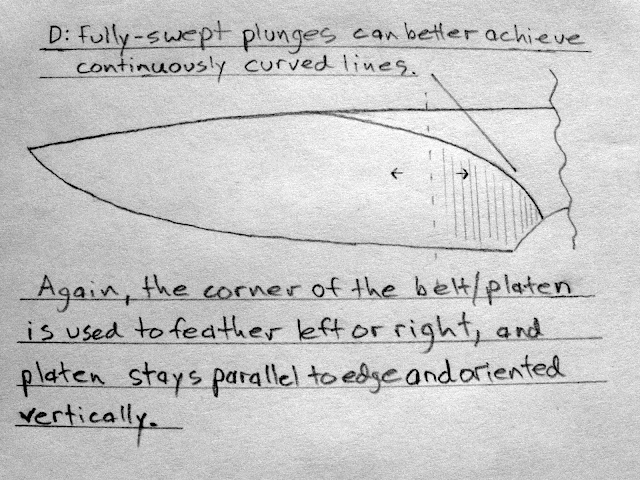

A few drawings. I have a point of discernment between what I call "fully swept" and "semi swept" plunges. I like both, but find the fully swept plunge more challenging and ultimately more appealing. I also suspect it may be a bit stronger, although I find the degree to which people focus on things like that to be a bit ridiculous.
Tell me what you find confusing. I know there will be something; I'm no artist.
The main thing is to be smooth and not dig in unevenly. I know I'm working on this. Also, it may help, especially when trying to match sweeping lines exactly, to make a pattern, use it to mark your grind lines, then "color inside the lines" with the grinder. On a dagger with swept lines, for instance.
I think I get it. I confess I've spent little time playing with this, but I've long admired this type of plunge, and I think I'll work on it. I'll need to study your drawings and do some pondering, but they'll help, Salem. I appreciate your taking the time to do these and post them.
