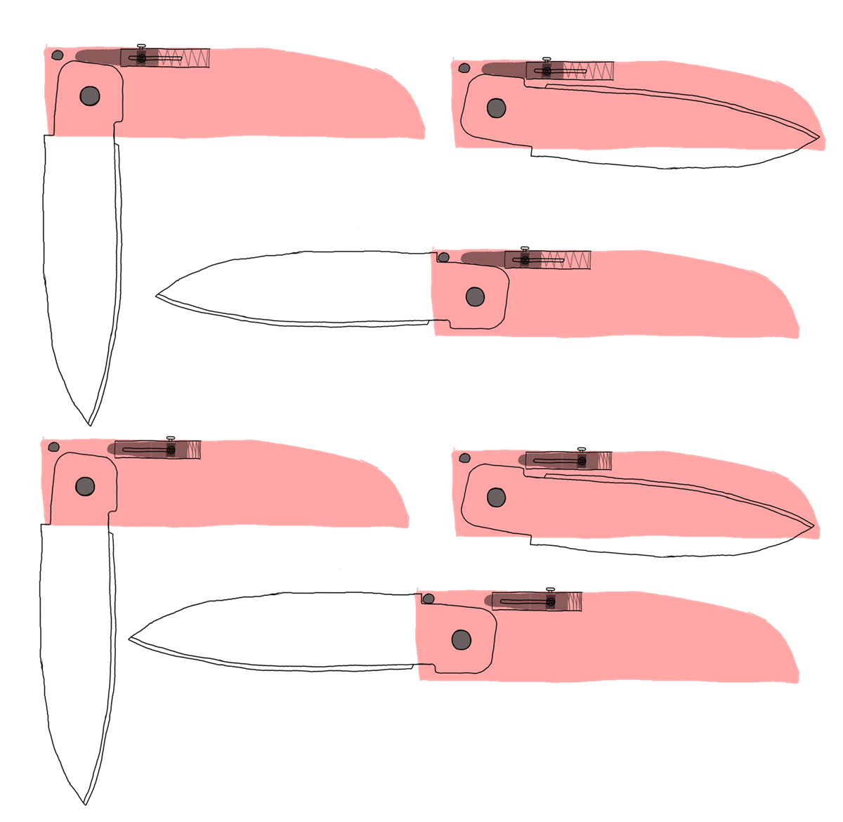

I've designed a lock and would like feedback (no prototype just drawing)
May 5, 2008
644
It's raining, I'm a bit sick, so I decided to fool around with Photoshop and think of a lock as an alternative to the axis lock.
I love the axis lock and can't wait till the patent expires so other brands can start using it to.
Those familiar with the workings of the axis lock know why it is such a good lock.
Very very sturdy lock, will not fail.
Easy to produce.
Easy to operate.
Keeps the blade closed under spring pressure (unlike frame lock)
Will compensate for wear.
I tried to think of a lock with the same attributes but didn't get much further then a twist on the axis lock. (Like Spyderco's ball bearing lock)
The downsides when compared to the axis lock is you need to keep the lock unlocked manual when opening and closing the blade and it would be less easy to produce.
The upside is it has a half stop lock (although you would have to fiddle with the lock, it's not like a slip joint with a half stop) and it compensates for wear when the blade is closed. (axis does not do this)
I'm not a native English speaker and I'm terrible with technical terms so I will let the pictures do the talking.
Two things to note:
- the locking bar gets thinner towards the blade as you can see on the pictures
- the locking bar locks further then the pivot. (important when blade is closed or half open)
That's a lot of text for something which probably doesn't even work, I'm not an engineer, I would like some feedback :o

It looks the same as the design I made for locking the blade when open. Although I can't see if it is made to compensate for wear, could very well be the cut out on the blade (and the bar) is completely straight.
The bar in my drawings can also rotate to minimize wear.
The main difference is that lock does not keep the blade in place when the knife is closed. (because the locking bar should go beyond the pivot for that to work. if that even works, I just made a drawing :p)
I think it uses a ball like a frame lock to keep the blade closed.

Make sure you radius the tang butt so that the tang slides cleanly over the lock. As drawn, your butt tang is squarish, which will force the lock bar up -- or jam -- when closing.
The DOG lock also has a ramp ground into the tang so that there is no vertical blade play and future wear is managed.

I thought about that but decided to go with lock-up when the blade is half open.
Reason for that is I thought it would jam anyway even with a rounded butt.
Thanks for the info on the DOG lock so it is the same as my idea only it doesn't lock the blade when closed.
After watching a video of a DOG lock knife I can see I've been very generous with my lock surfaces. It could probably be re-designed so it does not jam as you suggested. (more room to fiddle about with butt geometry)

Well first off, let me agree with marcinek! Also, please keep in mind I went to bed at about six this morning, ilistrating isn't coming easily at the moment haha. Along with that, I'm fifteen, some of this very well could be incorrect. :o
The major problem I see is highlighted in #1 & #2 - the red represents where the most pressure would be held when any up/down pressure is applied to the blade. The main worry would be the materla holding your locking rod busting. Assuming we're talking a ~125" peice of stock that's like .750 long, heat treated steel, it would take a massive amount of force to break the bar itself. That would rule out some handle materials I would guess. The little peice you actually pull back on to disengage the lock, would also leave an open space meaing less martial around the highest stress part of the knife.
So #3 & #4 are basically diagrams of an axis lock. The beauty off the axis lock is due to the lock face being slanted up, it can compensate for wear, and when downward force is applied to the spine the omega spring forces the lock bar up into the blade, wedging it against the stop pin, making it lock harder...I tried to make a diagram but it wasn't happening haha.
(Click to enlarge - zoom is your friend)
My only suggestion is to add a stop pin for the open position. Right now as is, whether the force is being applied to the spine or the edge, your locking mechanism is taking all of the stress. If you add a stop pin, only pressure on the spine will apply force to the lock, the 90 percent of force that is applied to your cutting edge during normal use will be taken up by your stop pin. Which not only improves strength, but the longevity of the mechanism.
Thanks for getting me thinkin' man, was kinda groggy but this was fun to think about!! There are probably some flaws in my logic here...I'd love to hear what I messed up. :D

Good drawings, I know exactly what you mean with your first point (#1 and 2) Thanks for the good feedback :)
The housing is a tube, the locking rod is round and can rotate to compensate for wear. (the "buttons" to operate the lock are on both sides and on top and are not fixed on the rod. the rod can rotate inside the ring with the buttons)
Anyway, maybe extending the tube much further towards the blade would help relief some of the stress. Obviously the underside of that piece of extended tube must remain open for the blade to touch the rod.
I'm not sure what you mean with your second point (#3 and 4). I also have a stop pin..?
My lock face (on the blade) is also slated up like an axis lock, same with the rod which gets thinner near the blade.
I also find this an interesting remark:
"when downward force is applied to the spine the omega spring forces the lock bar up into the blade, wedging it against the stop pin, making it lock harder."
Could you elaborate because as far as I understand, on an axis lock, the only movement the spring makes happen is horizontal. It pushes the locking bar towards the blade.
How to the "buttons" actuate the lock without being fixed?
3 and 4 are what happens when I get caught up in my thoughts and miss obvious things...sorry :o
I thought about it, and I'm not entirely sure how accurate my statement was...the omega springs are literally shaped like an omega, and exert force towards the blade and down to a certain extent. But I'm not sure that means what I'm saying is correct...
