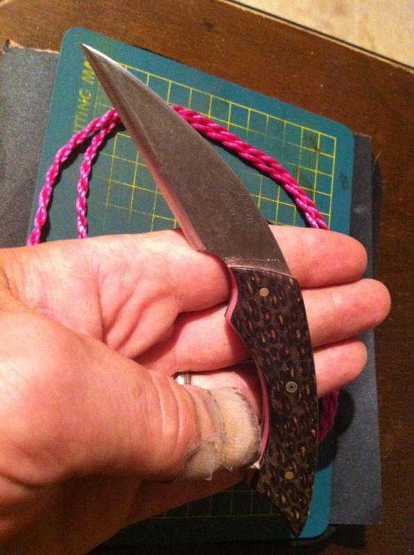

You can use a paper towel moistened with FeCl and water to add dimention to the etching too, and can be done with all steel. Here is an etched 440C blade I did that way, the etch is solid on it after using it for food prep for a couple of years.
(The etched is stainless, the un-etched is 01!! How is that for irony!
And another in CPM-D2:
I'm sure there are other and better methods, but this shows it will work, and I'm liking the results the more I play with it, but I'm slow and an amateur.
