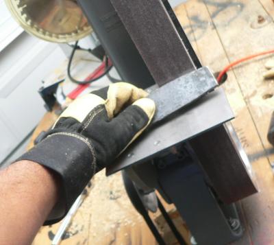

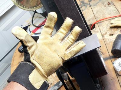

After taking the summer off from cutting, burning, scratching, grinding, scraping, staining my fingers and knife making in general I started back up again. It took about 3 hours and my baby soft hands were burnt, nicked, scraped just like normal so I put on some gloves. I found I picked up a lot of speed since the blade can get quite a bit hotter before dunking and wiping. I'm going to wear the darn things for awhile until I get a real urge to put on a skirt and wear makeup.
For all my grinding I use ZUG leather gloves available at Home Depot. Fit real nice and wear well, and I still have all my fingerprints.

I hope you guys stay safe, because gloves and moving machinery are a very big no-no.I have seen and heard of too many people hurt wearing gloves, jewelery, loose clothing etc.Dave

Dude, take the gloves off. It is probably the most unsafe thing you can do around grinding and drilling equipment. I personally know 2 people seriously injured this way. One had a tendon in his hand severed by a grinding wheel on a surface grinder. After 2 surgeries he can straighten his index finger about 70% of the way. The other person had severe tendon damage when a 12"disc grinder grabbed the glove and broke his fingers. Fortunately for him the glove was mostly yanked off and caught between the tool rest and disc and stopped the disc before it ground into his hand.

I wear gloves for all my grinding except hollow grinding. Staying alert and consious of what you are doing prevents mishaps more then wearing gloves. Gloves have saved me numerous times from being cut. I guess the bottom line is whatever you get used to.

Welding gloves are made to be worn oversize so if they get too hot you can fling them off of the same hand. If your gloves are too tight you will continue to get burned while using to other hand to get the glove off. A glove will also protect your hand while grinding, till it gets pulled into the grinder.

Well, yes and no. I been wearing gloves doing machinery work and what not for a few years. It's loose-fitting gloves that will do ya in. If you get a pair that fit right, it won't be grabbed by machinery anymore than your skin would. I generally wear very thin gloves, and have had machinery pull leather from 'em. I would imagine if I wore very thick welding gloves that it could have grabbed my hand. But to date - I have only been injured when I didn't have gloves on. And I have been around machinery that will work ya much worse than any 1HP belt sander could ever do.
Once you get used to having a good pair of gloves on, you can do most any work with them on, down to detail work. But, as I said, they have to fit well.
