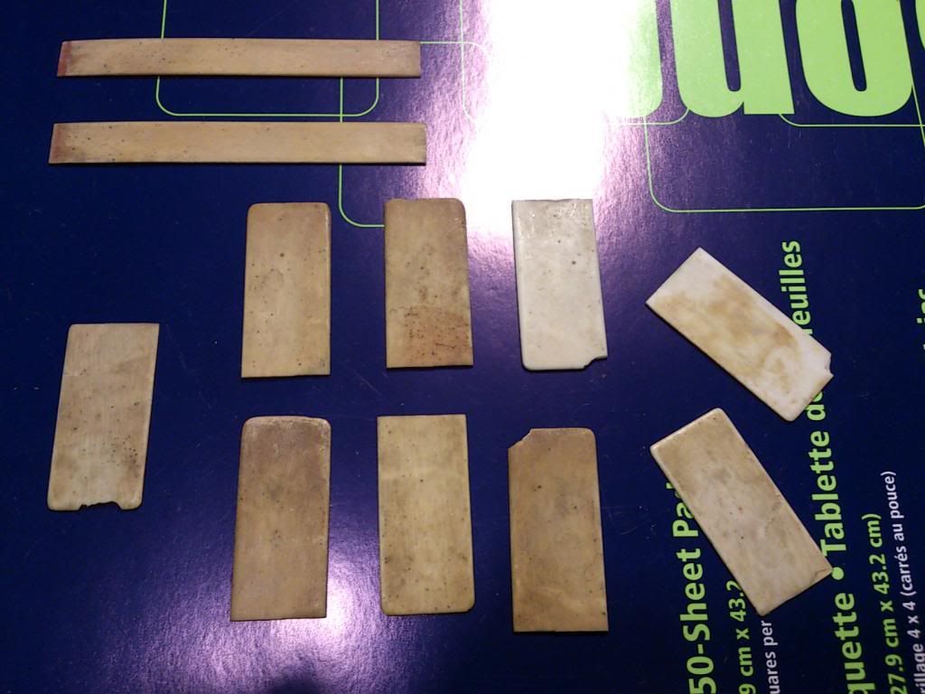

My job provides many opportunities to pick through rubbish piles out of old houses. Needless to say I find lots of cool stuff, although my wife would disagree as to the perceived worth of my finds. The other day I ran across an old piano that has been sitting outside under a shed for several years. The piano was ruined of course but I noticed the veneers on the keys were separating from the wood beneath. I popped several off to see if they were ivory. Well after some research I am 90% sure that these are ivory. I haven't done the hot needle test however each key that had an "L" shape, was made with two pieces. My few minutes of research indicates that this was done with ivory while plastic would be one piece. Does anyone have any experience with such so as to confirm my suspicion that this indeed elephant ivory?
I plan to use them as spacers for small hidden tang knives. They are super dirty and stained, I don't know if they could be used for anything else. Maybe bolsters but they are only about 1mm thick. Besides inlays, has anyone else used these for some aspect of knifemaking? Or does anyone have any suggestions as to how to use them or clean them up?
I do not make knives for sale, so I'm not particularly interested in the legal issues associated with elephant ivory that always seems to be suggested in threads concerning this subject, thank you.
Just run a flame along the edge of one and you will know. Plastic will melt, the ivory will scorch/burn and smell like burning hair/feathers.

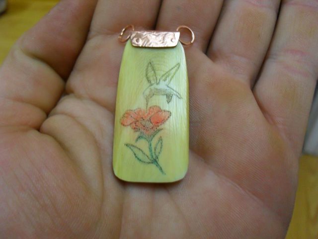

Those are the perfect size for scrimshanding, so you could always take a crack at it and make a necklace pendant for the wife.:D
Here's a piece I made for a friend to give to his wife on her birthday from a piano key overlay, for an idea.
Thanks Nighthaxen, that is a wonderful idea. I will have to admit that my first reaction was one with the four letter word "can't" in it. However upon further contemplation I don't think that I could produce the more traditional pictures but maybe something else. I could stick with what I know and make the wife one with a silhouette of a Focke Wulf or an overhead of a P-38. They don't sell those at Jared's. :p
Clean up is really easy too. Just get a few sheets of sandpaper ranging from 120 up to 1000 grit and some double sided tape. This video shows cleanup and shaping using piano key tops at the 2 minute mark.

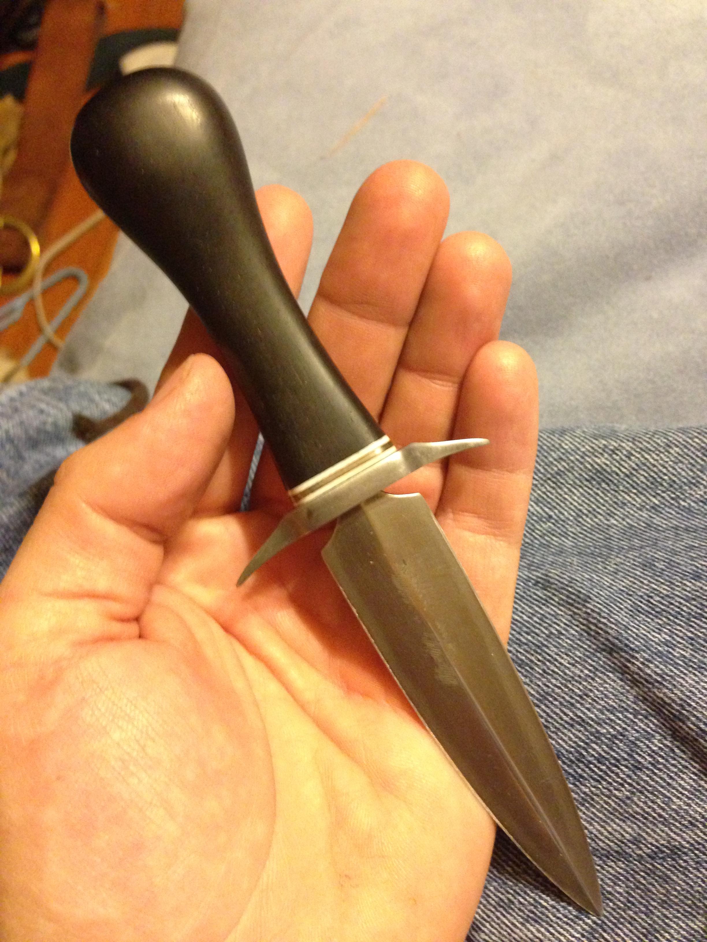

Yep spacers inlays all good stuff but wonder about future. How will we prove this ivory came from old pianos. Here is a little dagger I made several years ago out of a file wrought guard, silver and ivory piano key spacers and ebony for example.
Chris
What a pretty little dagger. Thanks Chris, that is exactly the kind of pic I was looking for. I'm stoked, they are going to look great on a future puukko.
