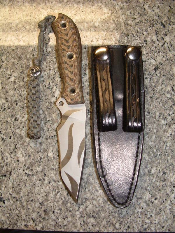

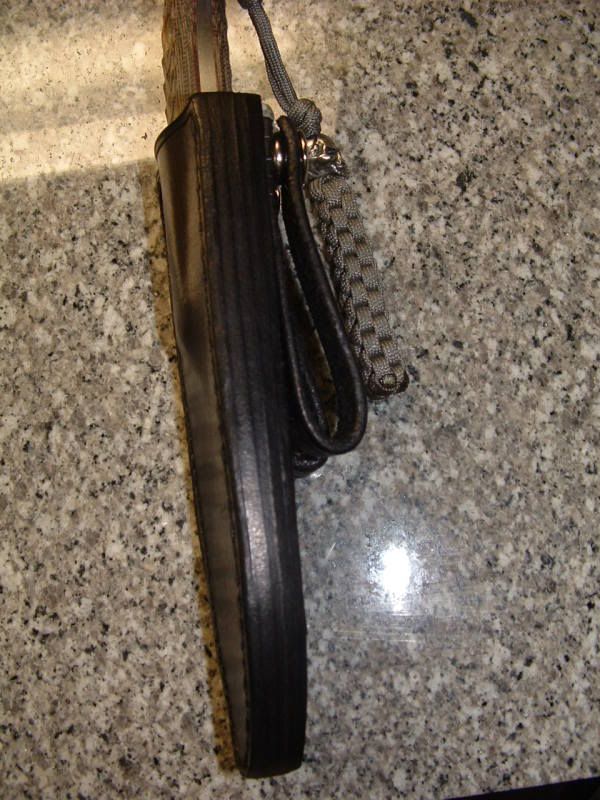

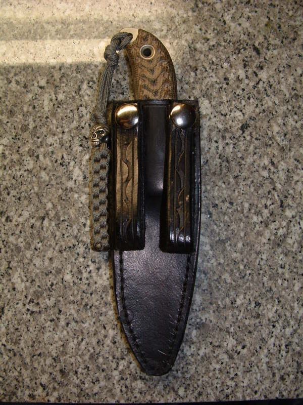

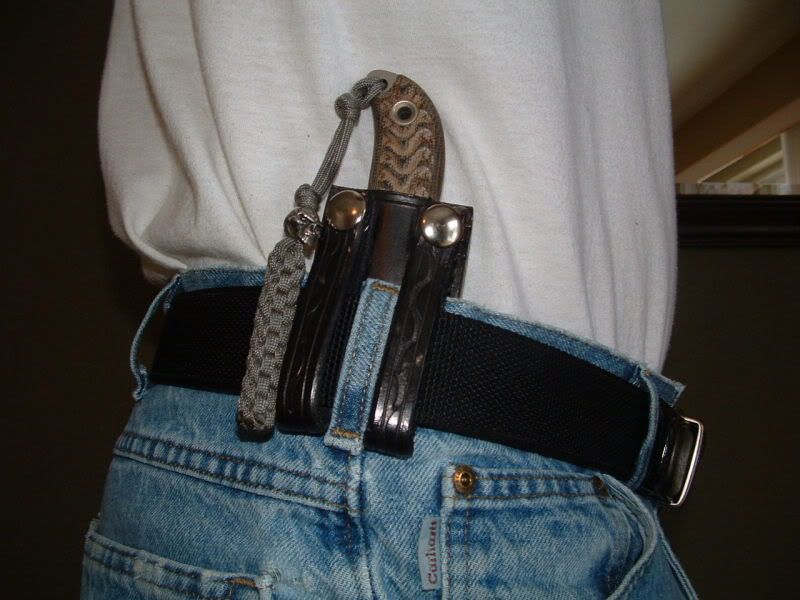

Well here is my latest sheath. It's set up for in waistband carry and designed to have the leather straps snap around the belt on either side of a belt loop. Kind of Spec-Ops inspired I suppose. Took out tonight on a two mile walk to test out the comfort and forgot I was carrying it. :thumbup: Hope the same holds true when I'm wearing it while driving. Still learning every time I do a project. Lessons learned this time were: 1. Be careful not to mark the leather with the drill press (yes I cheat) by going to far through or you'll leave little circular marks
2. Use something other than Tandy's Eco Flow black. I've had nothing but trouble with the black rubbing off the leather no matter what I do. It's been recommended that I try Fiebing's. I'm open to other suggestions as well. Thanks for looking!
