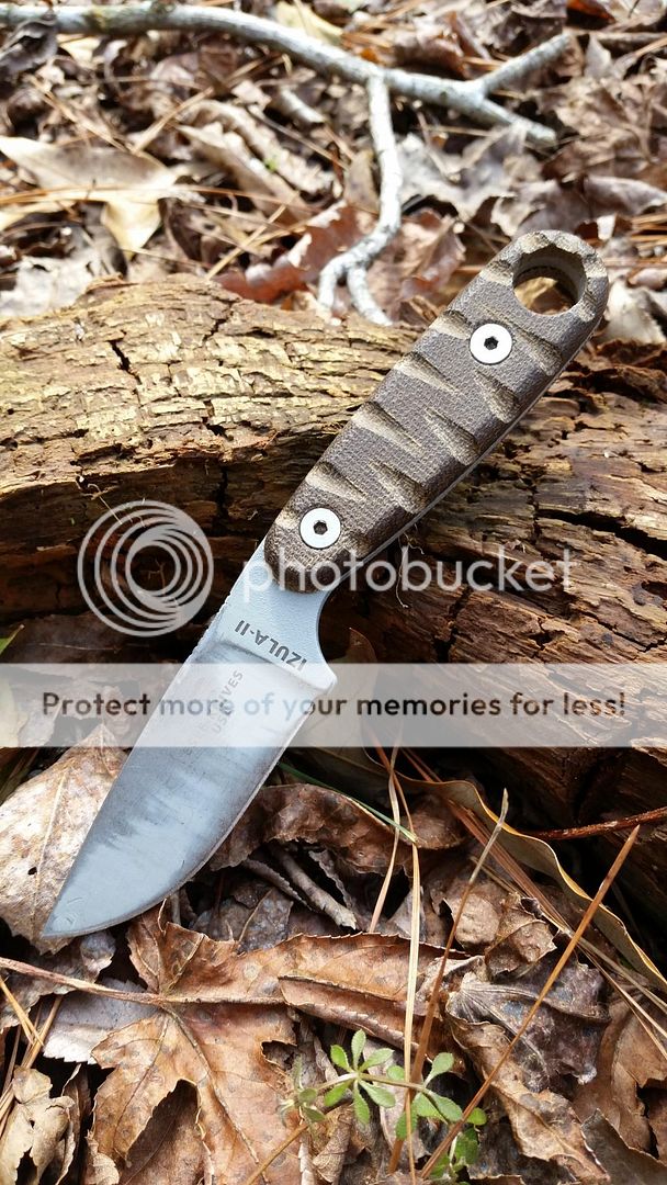

On my 15th birthday my sister gave me An Esee Izula 2, and I still use it on nearly a daily basis 3 years later. A lot of Youtube reviews of the knife have basic cord cutting, batoning, and paper cut tests but honestly, I feel like many of those reviews don't do the knife justice. The video is usually taken with the knife right out of the box and is biased by the excitement of a new knife. I wanted to share some thoughts on the knife after having it and using it for nearly 3 years.
I am an avid outdoors man and I take the knife with me hunting, fishing, kayaking, and camping. Personally, I don't like the term survival knife. I feel as if a knife is only good for playing in the woods, then the knife isn't as 'versatile' as reviewers claim. This first picture is of a deer (button buck unfortunately. thought i was shooting a doe) that I killed last fall. I used the Izula 2 to field dress then process the deer. The small blade was easy to handle and easily cut through muscle and tendons. The removable handle scales made cleaning the blood and hair off the knife very easy. A knife with a bit more sweep would have made the job a bit easier, but the slight clip point was definitely good enough to get the job done.

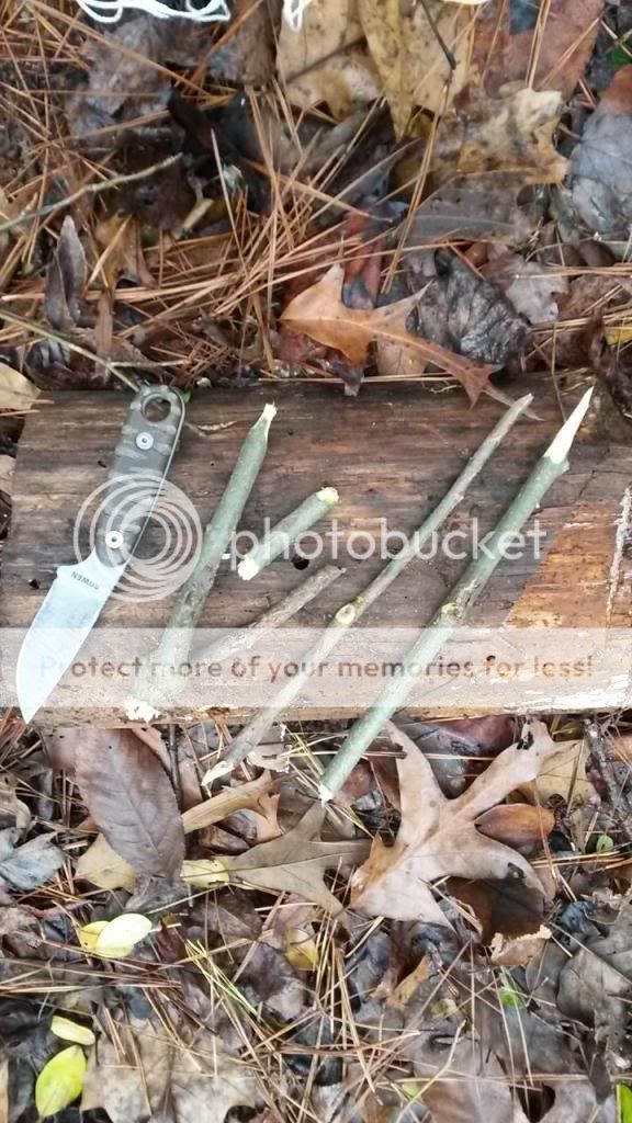

The knife also carves well. The handle allows for plenty of purchase on the knife, and the ffg and not overly aggressive coating allows for the knife to bite into the wood. My factory edge is long gone, but Esee's 1095 is easy enough to sharpen with a stone or rod. I ground down the spine slightly for the knife to easily throw sparks from a ferro rod and filed grooves in the handle... pretty much for the hell of it.
