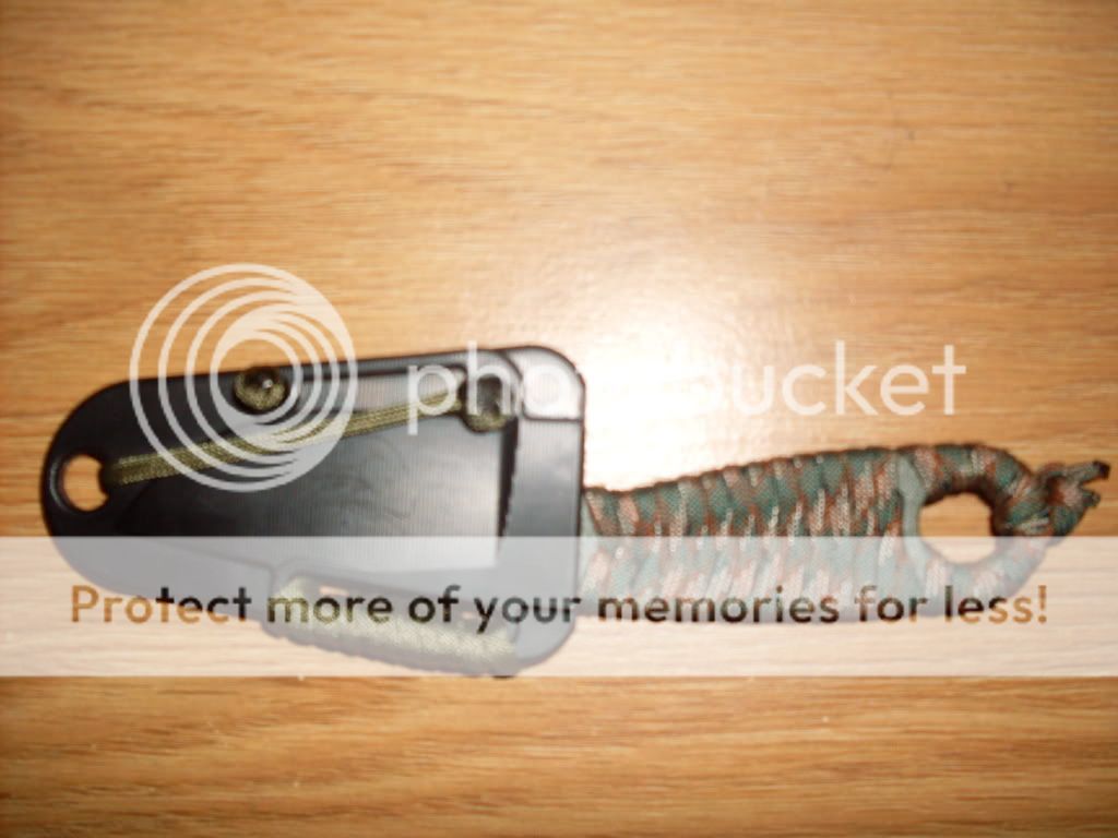

Well i decided i would like to carry my IZULA in different ways so i messed around with some paracord and rigged the sheath so that it could be used for belt carry. Cheaper than going out and buying a tech lok too. I wear it horizontal carry mostly or just in my pocket. I can carry it in the vertical position as well. In the horizontal carry position, the sheath sits very tight (i wrapped it real tight on the sheath and tied knots once the paracord went through the final holes, then burned the ends to prevent fraying). Overall im happy with it, with a hoodie or jacket on, the knife is completely concealed. Large shirt would conceal it too. Also frees up a pocket for my pack o' smokes :D

Cool setup. I'm having a hard time figuring out whats going on with the vertical piece that goes from the bottom hole to the top. Is that a seperate piece? Where are the ends?:confused:

Then ends are here coming from the bottom. You can see where i burned them if you look closely. Its one piece of paracord. I will try and explain it the best i can with the photo i edited with paint.
Make sure you have the knife held the same way as i do in the picture. Sheathed and blade facing away from you. Will make it easier to follow the step by step instructions
Step 1) From the bottom, push the paracord through and tie a knot. Burn it to prevent fraying.
Step 2) Take the paracord and bring it under the sheath and through the gap [ ] it has in the sheath and over so that you are wrapping it towards you. Do this until the end of the gap making sure you keep the paracord tight in the process.
Step 3) Pull the paracord under the sheath and put it through the hole directly opposite where you just finished wrapping.
Step 4) Pull it tight all the way to the bottom of the sheath and feed it through the large hole.
Step 5) Bring it up and put it through the top hole (the one you have fed it through already). Tie a knot, burn the ends and youre done.
Happy horizontal/vertical/inverted carry. Just remember to keep it tight at all times.
I hope this helps you out
