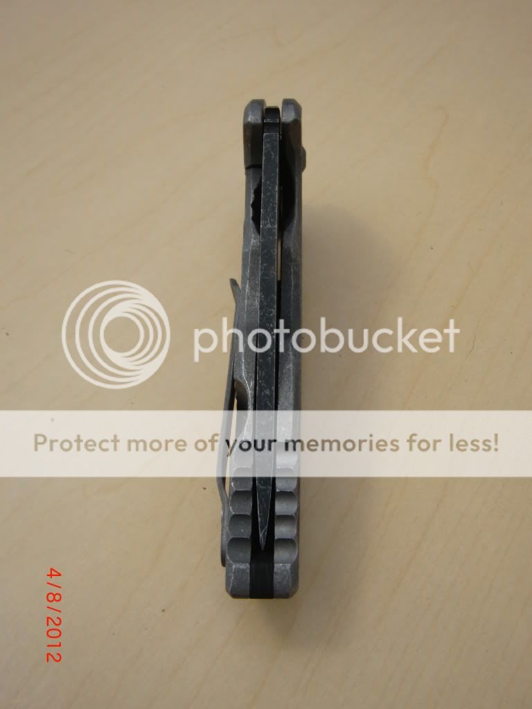

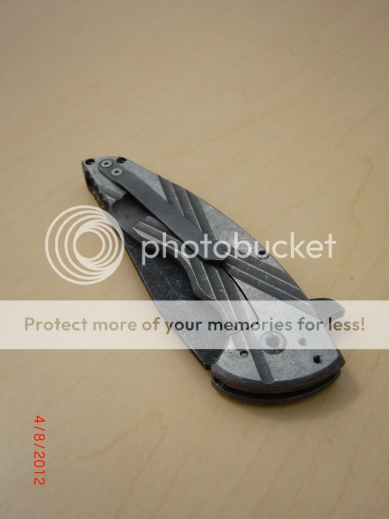

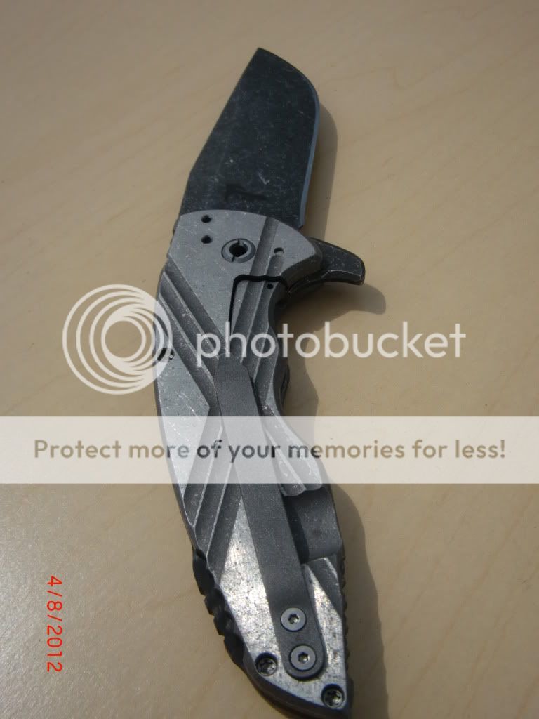

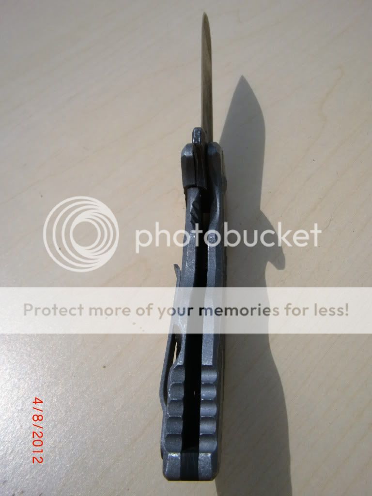

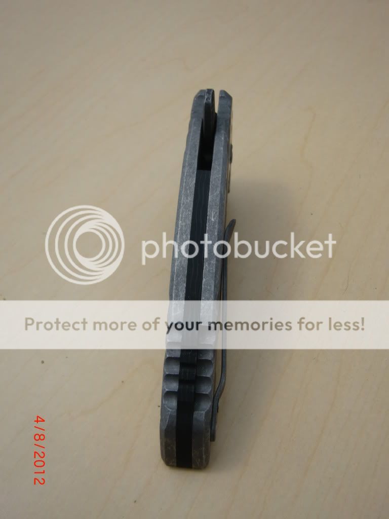

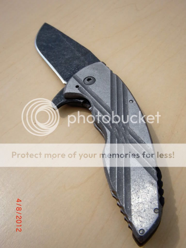

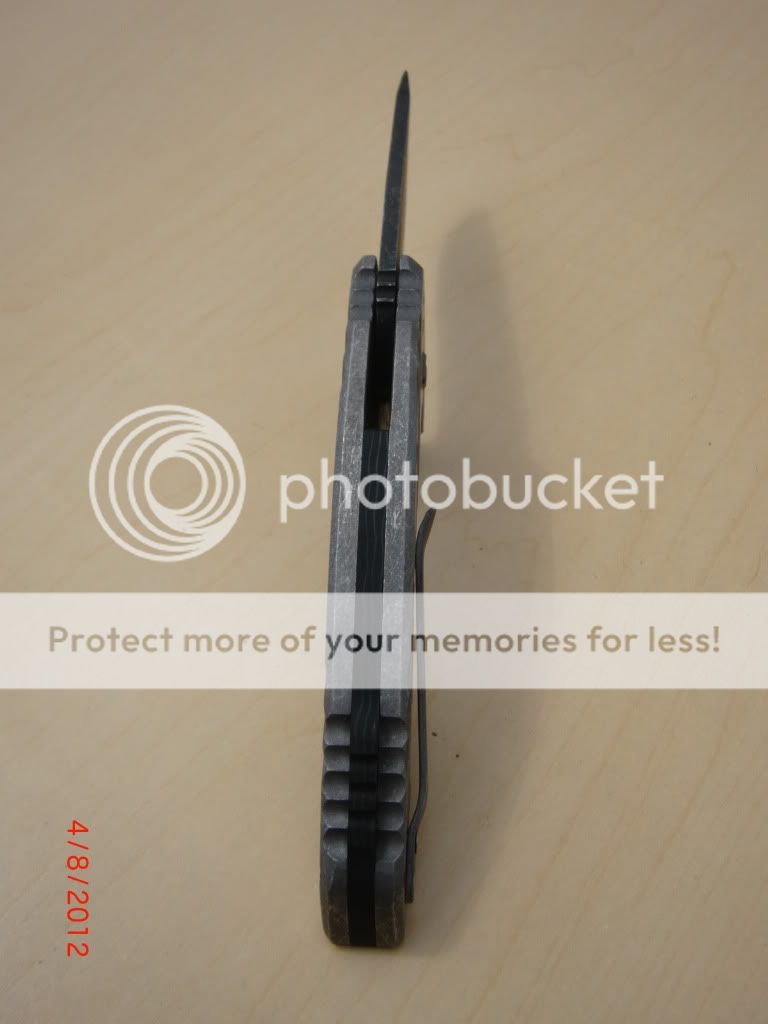

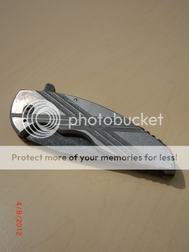

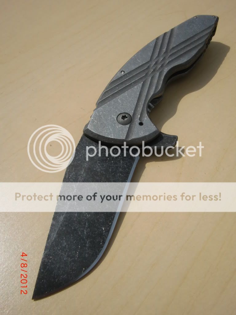

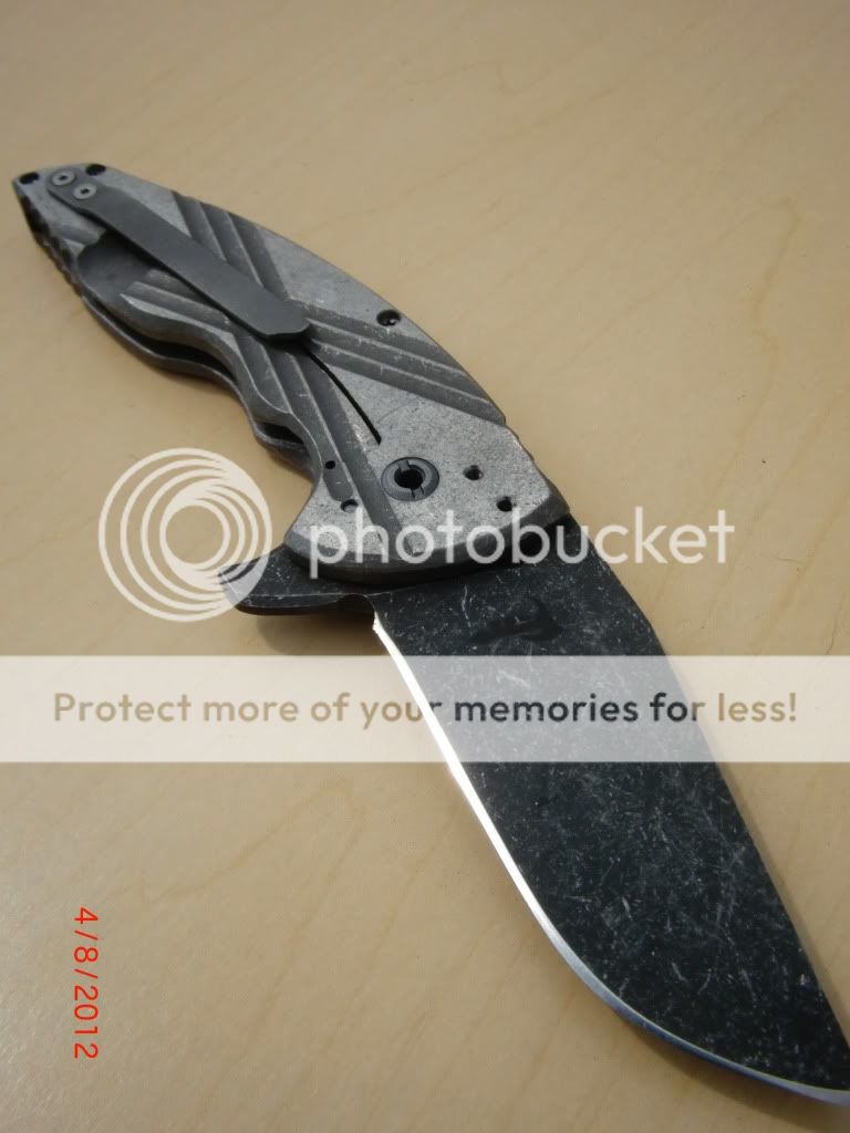

Hay Fellas,
Just got this done, figured I would show it off. Going out to a USN brother.
Specs:
CPM154 .140 thick Acid/stone wash
6AL-4V Titanium frame lock .180ish thick
3.25" long blade
mill work
carbidized lockface
Bearing system
Hope you enjoy
