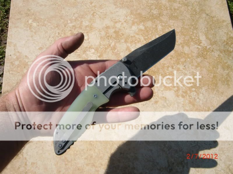

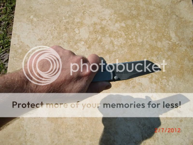

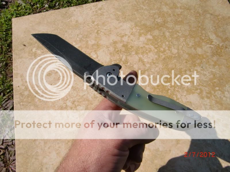

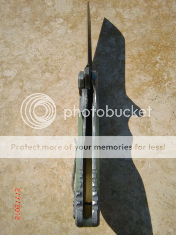

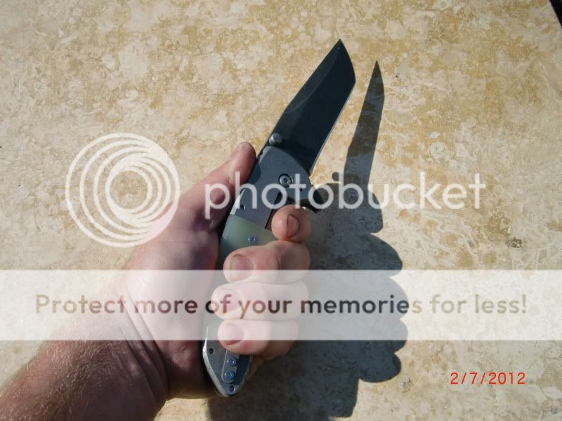

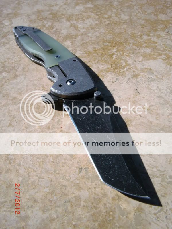

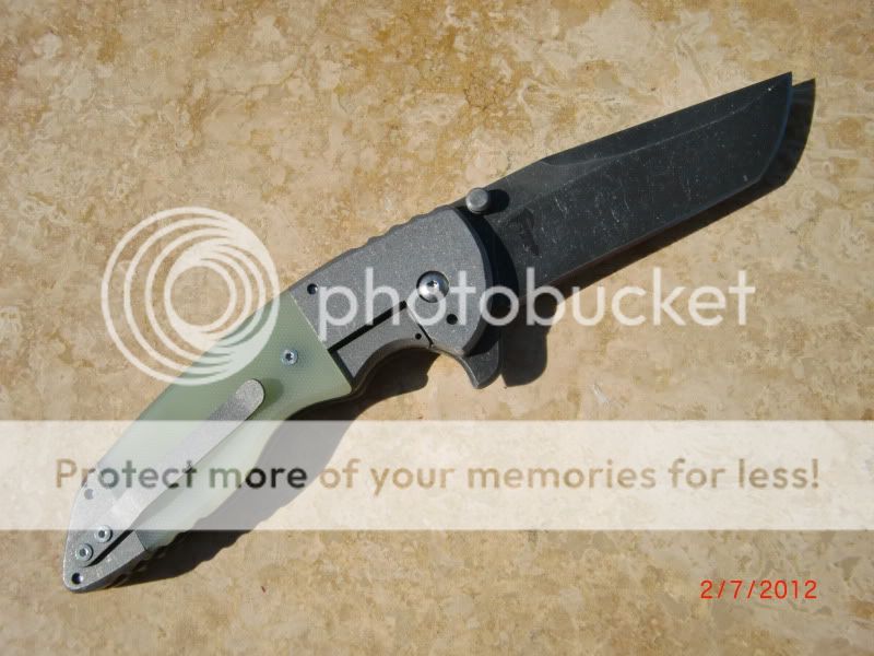

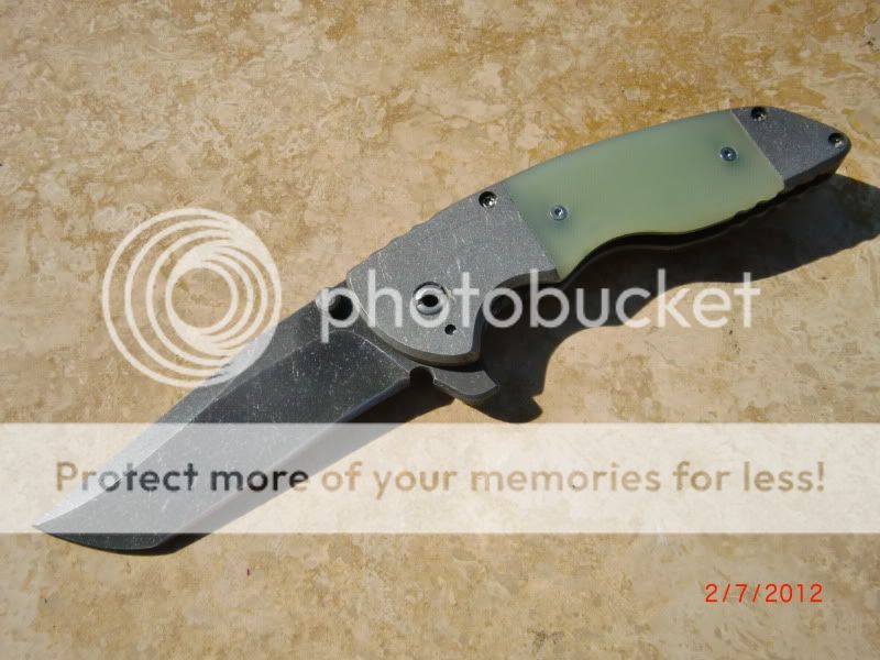

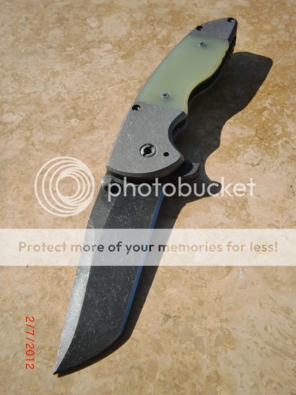

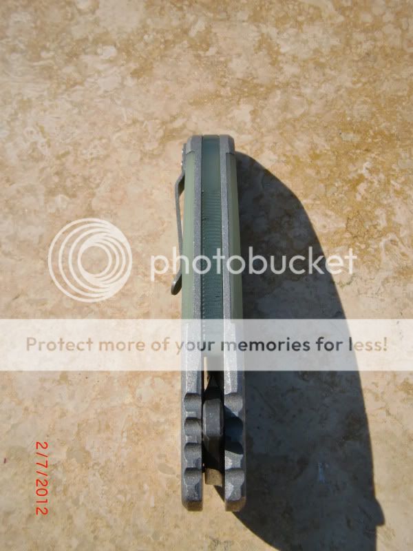

Its done Mike!!!
Got this done this morning, just had a few min to make a vid and get pics uploaded.
.200 CPM154 blade 4.85" long
.200 thick titanium handles with Jade G10, not really a bolster but kinda? milled out the frame to accept the G10. left the titanium under the G10 at .100
carbidized lockface
bearing system
custom clip
blasted and tumbled frame
Acid/stone wash blade
9" overall length

I really like that blade shape! What is the finish on the blade, it looks great.
