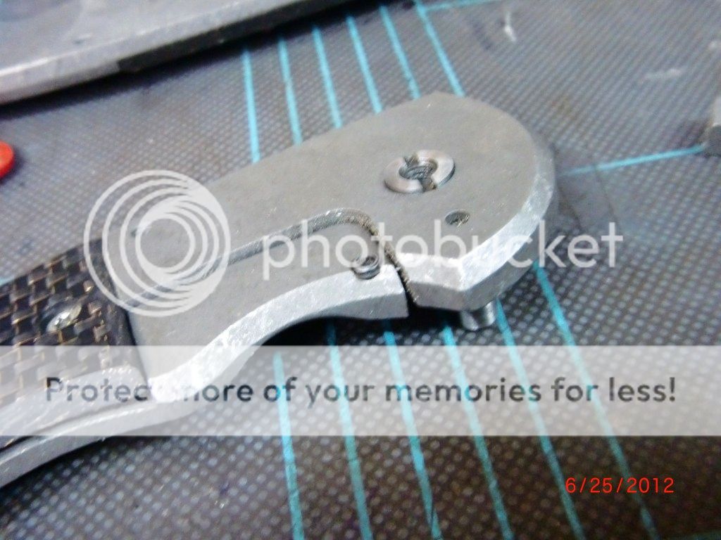

World premier of my new HRD system:toxdance: The Hoback Roller detent gives significantly less drag on the blade compared to a standard detent. This is exclusive to Jake Hoback knives.
Now that Im done with the marketing gimmik side of things:haha:
Yall probebly know how this works but here it is anyway.

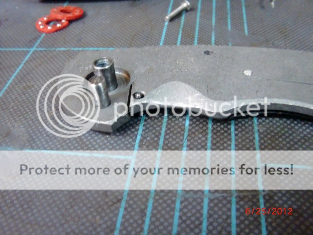

A normal detent in a folder is a pressed in ball bearing either .062 or .092 wide. it drags along the blade and keeps the blade in the closed position and lifts the lock off of the surface of the blade to keep the friction down.
The HRD system uses a rolling ball bearing to do all that a standard detent does, but with substantially less drag. A great side affect to this is that there is greatly reduced wear, and it is user replaceable.
I want to get this info out there and in the hands of people who can use it.
I am willing to give the information, sell the detents, or tell you where to get them made, to anyone that would like to use it. I only ask that I am given the credit for the device. Call it the HRD system, and use it freely. I hope that this can create a new line of folders that will be so smooth it will blow your mind.
I will be using this HRD on most if not all my folders from now on. I have been amazed at the lack of friction that I'm getting. I figured that if the pivot is riding on bearings, why not the detent too.

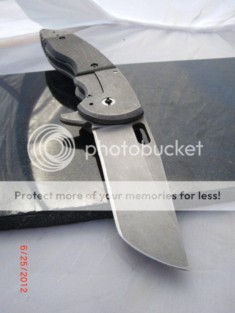

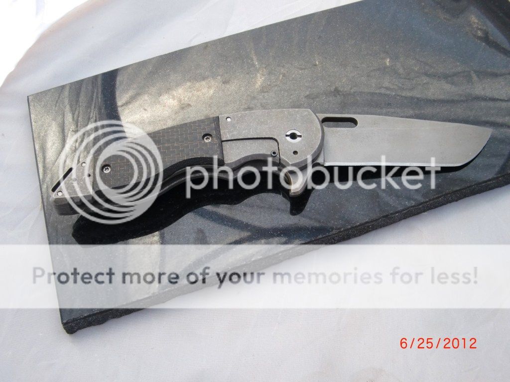

You will see a all titanium blade folder from me in the near future with this system on it:P no more plastic balls or ceramic that eats the blade
http://www.youtube.com/watch?v=imlppF4q2i0&feature=youtu.be
Look at the wear pattern on the detent area. cant even feel it with your fingernail. Thats 3 weeks of hard use from me. Ask anybody that knows me. I'm not easy on my prototypes!!! the chipped up M4 blade will attest to that.

Cool idea, Jake. Does it just sit in the hole? Also, how thick was the titanium stock before you carved it up so nicely? i REALLY like the fact that you have a proper handle scale on the lock side of a frame lock so no need for a "travel stop". By the way, that is one big honkin' stop pin! Looks like a second full sized pivot! :eek:
Do want!!!
I would love that folder in a left handed version with a bit of a darker etched stone wash finish on the blade!

I still need to sand down the head of the screw so that it doesn't protrude. It only sticks out about .015-.020 so I don't even notice it when in use, no hot spot to speak of. I am considering making it a flat tip instead of an Allen key so that would take care of grinding them to fit thinner frames.
The frame on that A15 is .220 thick, plus the HRD is setting right where I chamfer the edges of the frame. New models will get moved back a touch.

Also, I really like that knife. That looks like a great EDC.

Interesting concept, thanks for sharing. I'm not very sure how it works though. Is there a tiny spring that presses the detent ball or is just the screw that holds the ball in place?
