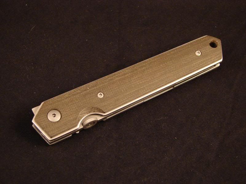

Boker Kwaiken flipper mod

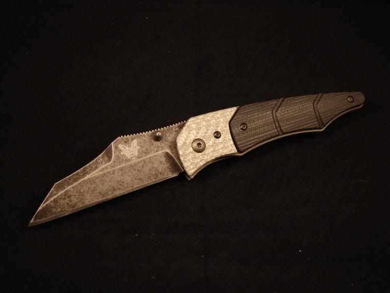

Benchmade Gravitator 425bk stonewash

Kwaiken Flipper mod

Gravitator bk stonewash
