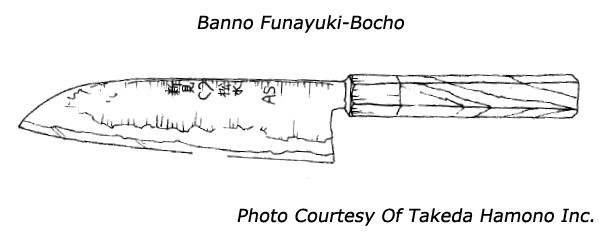

I got this stupid idea that I could make a Japanese kitchen knife so I roughed out this 80CrV2 to about 0.10 thick with a blade at about 7.1 long x 2.1 tall.
I’m seeking your collective wisdom regarding the bevels. I’m too big of a coward to try the single bevel on the first try so I’m looking for input on a double bevel. I’d appreciate your thoughts on:
1- Bevel angles (and bevel height),
2- How much distal taper, and
3- How much do I grind before I HT?
I was thinking I wanted the bevel to come up about an inch to an inch and a half on the blade. Or do I full flat grind it?

Yes a slight taper and a full flat grind
I never do a full flat on a bigger kitchen knife but on a smaller bunka I wouldn't worry so much about sticking
And go to at least about .8mm at edge
Some say to .5 but the nearer to that you go the bigger danger of warps
Search don Nguyen post on kitchen knife design critique also search Bill burkes posts :) your welcome....
It looks a litte too straight to me but im not an expert on Japanese kitchen knives
I would plan out your profile better before you grind bevels or ht .
Also test your knife profile on a board does it feel smooth or "bumpy"
And i think you might need to reduce your tang down if its going to be a wa handle.
Not harping on your design but ive just spent a lot of time looking up kitchen knife design threads
And particularly paying attention to the well known makers advice....

Your tang should have a step down about 3/16"from the spine and 3/16" from the bottom with shoulders about 1/2 back from the blade. See the image below. A tang width of 3/8" is just right.
