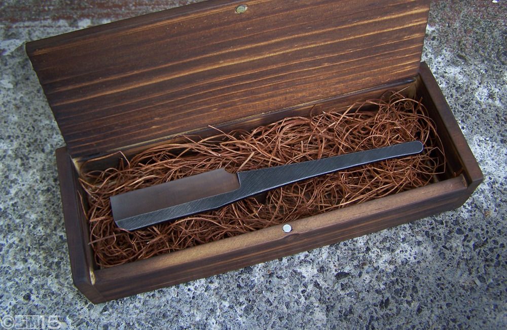

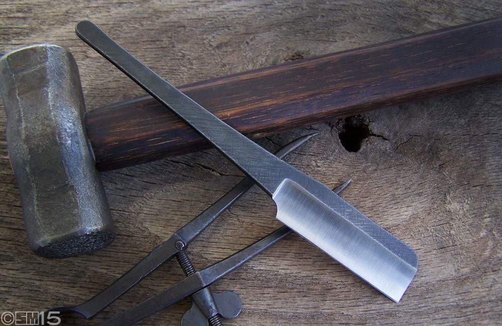

I had an order for a kamisori for a Christmas present.
Forged from W2. Gave it a light texture and blued it.
One side is hollow ground on a 5" wheel and the other with a 72" radius platen.
I didn't make the box, but I burned it and smoothed it out with steel wool.
I lined it with some filler stuff I found at Michael's. Thought it looked nice.
The razor 'hovers' in the box on top of a piece of dowel rod with a magnet inside topped with some felt.
Thanks for looking.
Shelby
