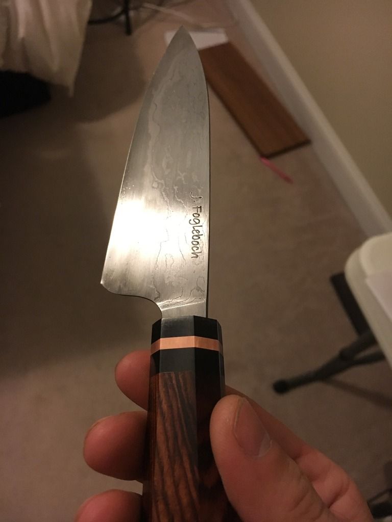

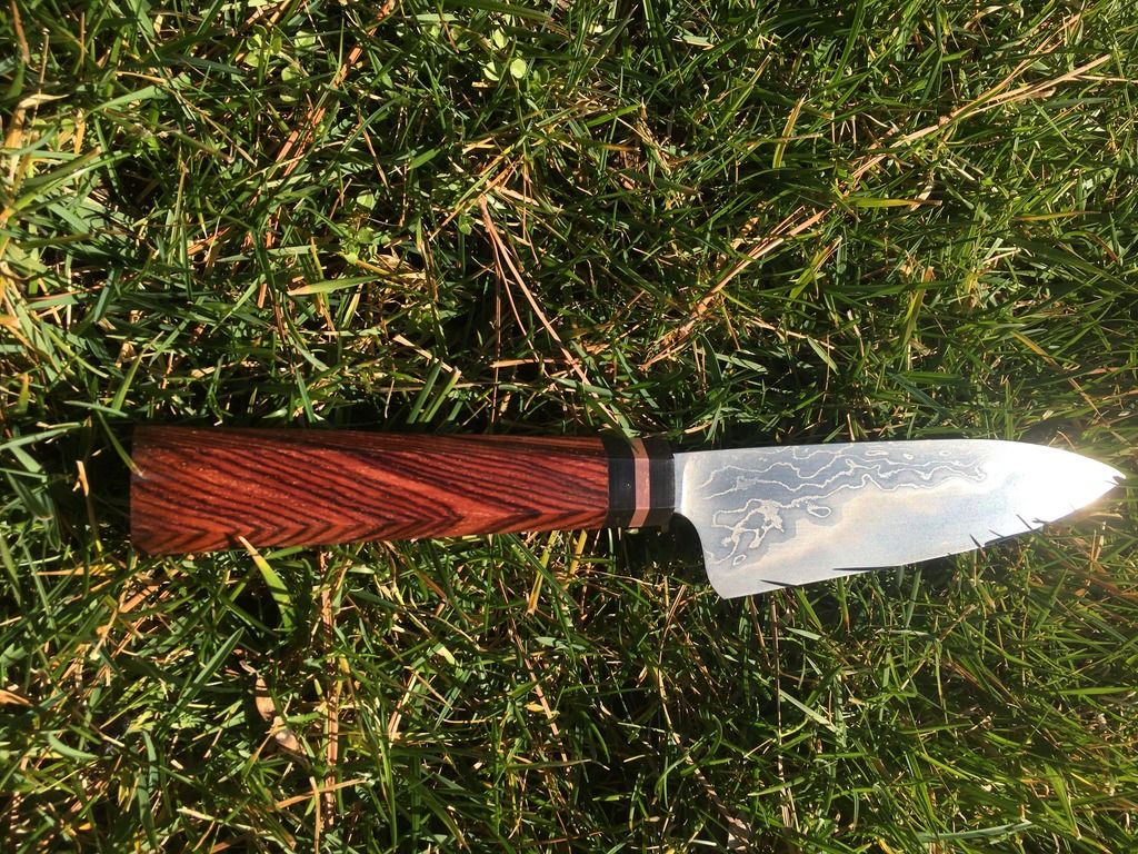

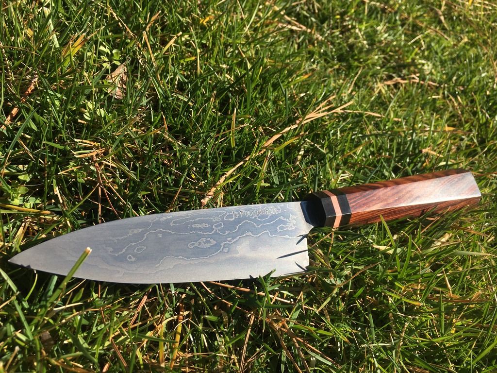

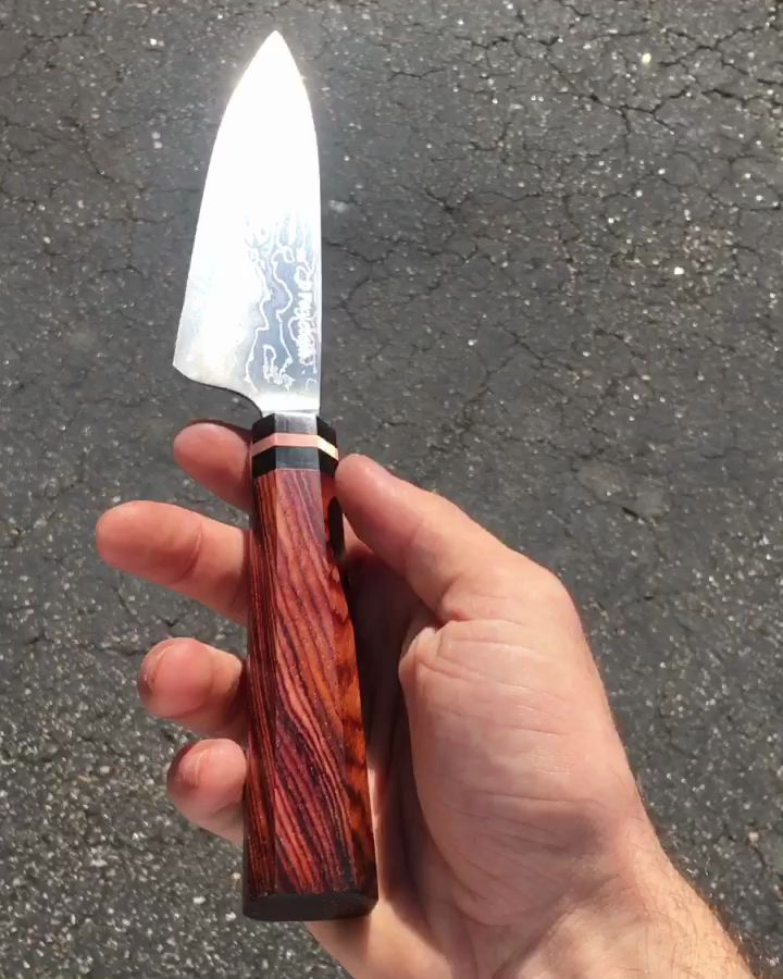

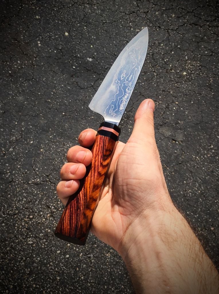

Hey guys just finished this one up. The blade shape was based off of a funayuki deba.
Blade: approximately 5" of takes white #2 suminigashi steel. The blade is laser thin (approximately .09" at the thickest portion and tapering down to a needle point. The grind is ever so slightly convex with the tiniest microlevel.
Handle: The handle is comprised of black g10 with a copper spacer and some beautiful old growth cocobolo.
Thanks for checking this out; if you have more questions please feel free to comment or message me.
