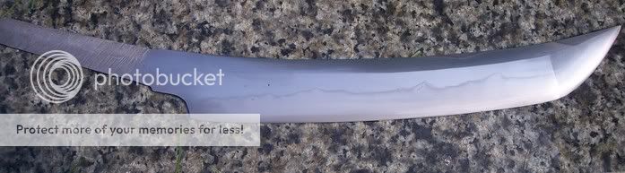

This was inspired by a few sources. Firstly Don Fogg's Yakuza Bowie II.
And another version of this style of knife from another forum.
Looking more closely at the woodblock print shows something I would like to make a little more closely but it does look like a very purpose driven design and I think where the drop to the edge is is probably a sharpened like a gut hook.
For my intented purpose as a camp knife, it looked a little dangerous and not particularly useful so I altered the design quite a bit and also did not do the chisel grind like the originals... Hence the "Camp Knife" reference.

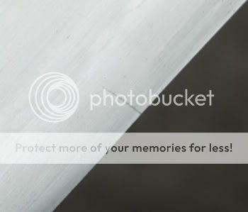

Anyway... The worst is yet to come.. I have been disappointed with Parks50 as a quenchant as one needs to forge to allow for the drop in the tip of the blade, the negative sori, and I have been having luck with water... well there is always a sacrifice and just when I thought I was safe, a quench that seemed to go perfectly.... tink!!:(:(:( I couldn't see it right away so I thought it may have been in the tongs (I told myself hopefully.:o)
But...
I didn't see it until I started to hand sand the blade... I had gone that far so I did a truncated polish job but did do some polish because it looked to have some great action in the hamon but I did forgo getting it super clean. I finished off the handle rather quickly too and did so to test the feel and durability of my wrap.
I'll use it around the yard and see if it still holds up. If not I will look at the grain.
Blade is 12" DHIII's W2 and the handle is 5 5/8" with wenge and cotton ito wrap.
The shinogi bevel is strongly tapered and there is a very pronounced mune. The blade is over 0.300" at the thickest part of the shinogi ji with a strong distal taper.
I figured I'd post it though as my first almost knife of 2012. I like the design and will do it again,, maybe with Parks 50 though. :o:o
Happy New Year!

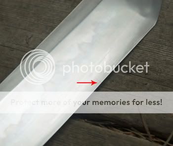

Oops... forgot the hamon photo.

my wife and daughter enjoyed the Branson's hospitality yesterday, and I GREATLY enjoyed 'whaling' away with his knife. The high grind made for a wickedly thin profile and the edge bit extremely deep into whatever it encountered. For such a big knife, it wasn't at all unwieldy, and I figure the upper grind and distal taper was the main reason for this. The handle fit in my hand quite nicely, even though Stu has freakishly big hands- I mean, each of his fingers was a good inch longer than mine! Freakish! But a great handle. We discussed the addition of a turk's head at the end of the handle, and I hope that Stu puts in a little extra time even with the little crack, (which didn't show any sign of growing even though we spanked his knife pretty good).

When I first got into making hamons, I could never get the pattern I wanted. The clay was a guide but it never really worked how I intended. I couldn't figure it out until I saw Nick Wheeler's thread wherein he had some hamons produced without the clay and I realized how much the geometry had an effect. I noticed that I was used to testing "non-magnetic" too close to the edge and up in the clayed area, it was still under critical. After a few "low" hamons, I started watching the height of the austenitic area. But, when doing a water quench, if the whole blade is austenitic then it usually shatters so it's a balance between heat differential, geometry and the clay.. Still trying to figure it out but doing radical geometries like this introduces variables that are hard to gauge. Other large blades I've done have had low hamons so I went a little lighter on the clay, relying on some geometry interaction to get my hamon. I think you can see that in the really stormy area that happens where the yokote is. This yokote area introduces a variable because of the thickness changes..
But to your question... I am really wanting to try doing a full immersion quench without interruption because of a comment Bill Burke made in a thread of mine some time back but I've been too chicken.. I held it in for about 4 secs, interrupted for about 2 secs, back in for 4-5 then out for a couple seconds then I figured I was safe so I put it back in to finish cooling.. "tink"... I should've stopped after that second dunk and gone to the oven and clearly this was a case where if I hadn't interrupted, it would have probably failed much more spectacularly.
In the end what I really think happened was that the geometry was compromising to the stresses of a water quench. There was just too much edge and as the spine contracted it broke.. If you look at hardening a Japanese sword, the blade itself, the shape and the geometry is very much part of the reason water quenching works, or so I figure.
The issue of Parks50 and negative sori, I think, is very dependent whether the blade is fully austenitic or not. I have to experiment but I suspect that with the safety of Parks50, you can heat the whole blade with a little bit of clay where you want some hamon and quench. There may be a little drop but I doubt it is as dramatic as when the blade is only austenitic half way up the blade. I'm going to try this next time. I have shied away from that as getting a thick spined blade fully austenitic risks unwanted effects to the steel at the edge. (or so I figure)
