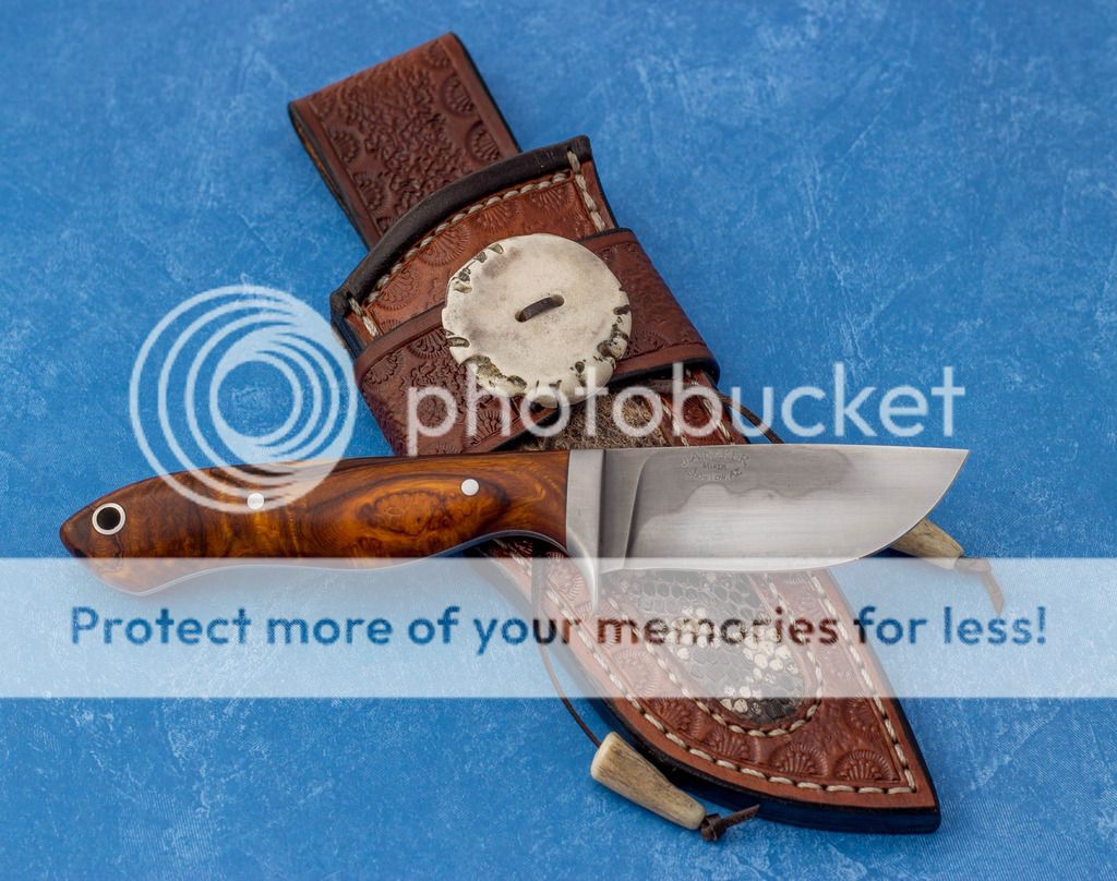

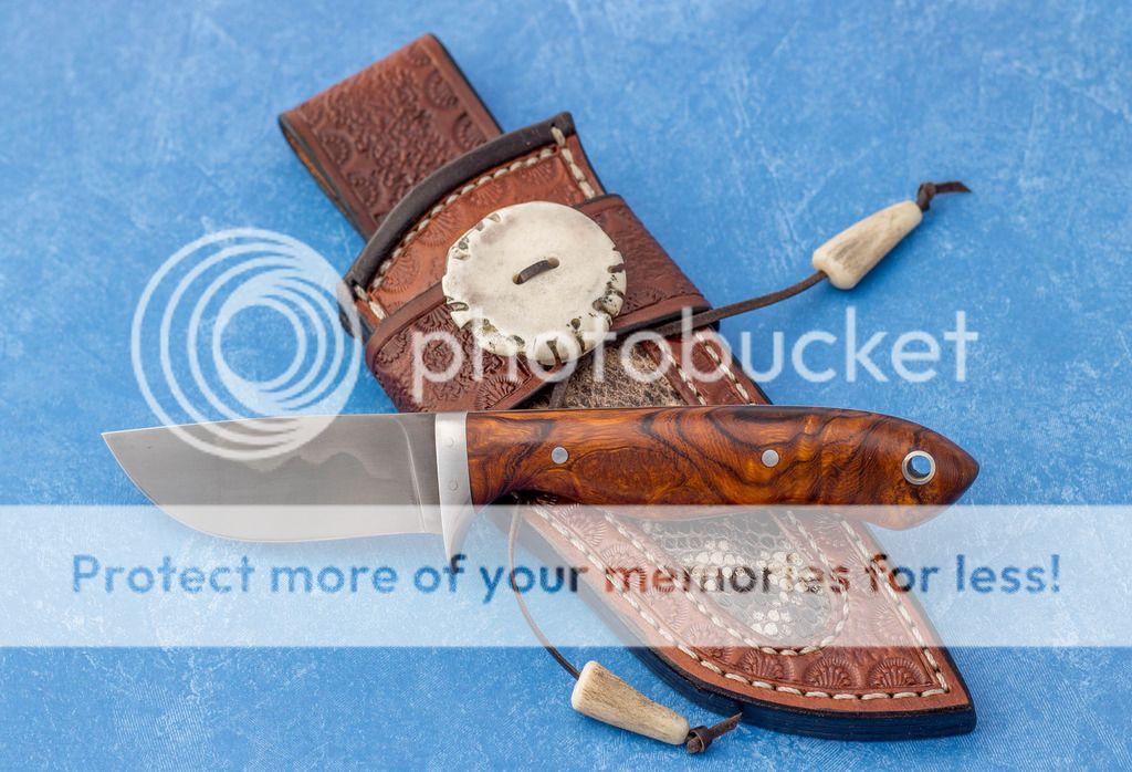

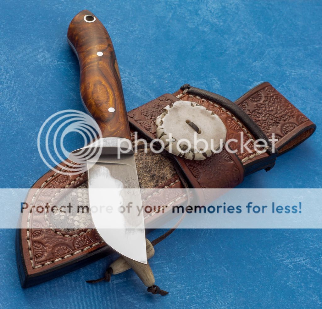

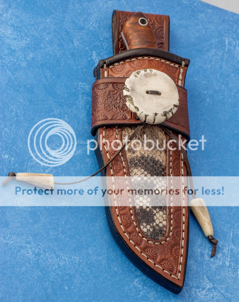

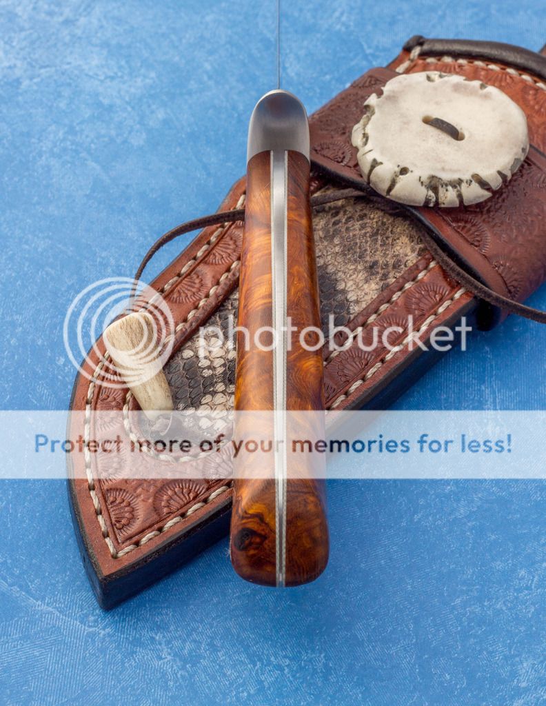

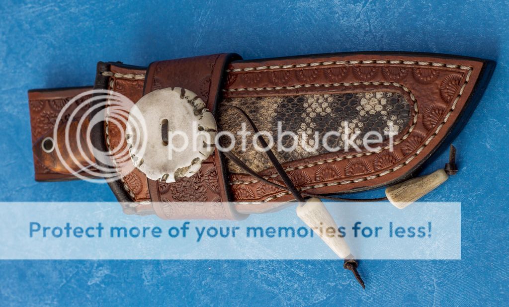

I just finished this one up today. This is a Javelina Skinner model with a stainless guard and a very thinly tapered tang (.010" at butt). It has a clay quenched 1095 blade with hamon and 2k grit finish. The ironwood scales have burl and sapwood inclusions and lay over white g-10 spacers. The lined sheath has a rattlesnake skin insert with an antler medallion and beads, and is all hand sewn. Thanks for looking, Jeff
Wow, that looks sharp!! Nicely done, both with the leatherwork and that knife!

Jeff . What a nice job on both the knife and sheath. Very good work. Can't wait to get my next knife
Wow. Jeff you outdid yourself here.
Glad you started using guards on a few of your knives. Looks awesome. For sale?

Thank you guys.
Would you believe that I've lived in Tucson since 1998 and have yet to see a javelina? Nice looking knife and sheath.
