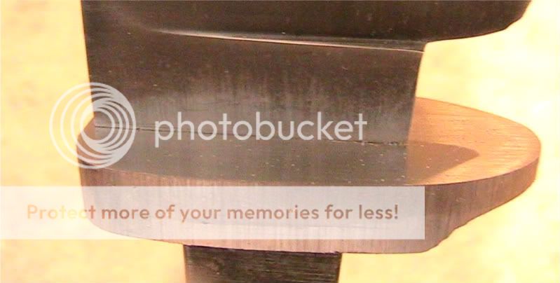

I really like the JB weld method. What I do is wait for it to set up for about 2 hours until it's rubbery like you said. Then I scrape the excess off with whatever I have laying around that will fit into the corner. After that all I do is spray some WD-40 onto a paper towel and carefully clean off any JB weld left on the guard or ricasso. Here is one that I just did yesterday.

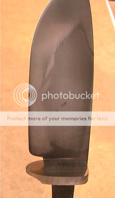

Here are two pics, one with JB weld (the same one that I posted above), and the second on a similar knife with silver solder.
