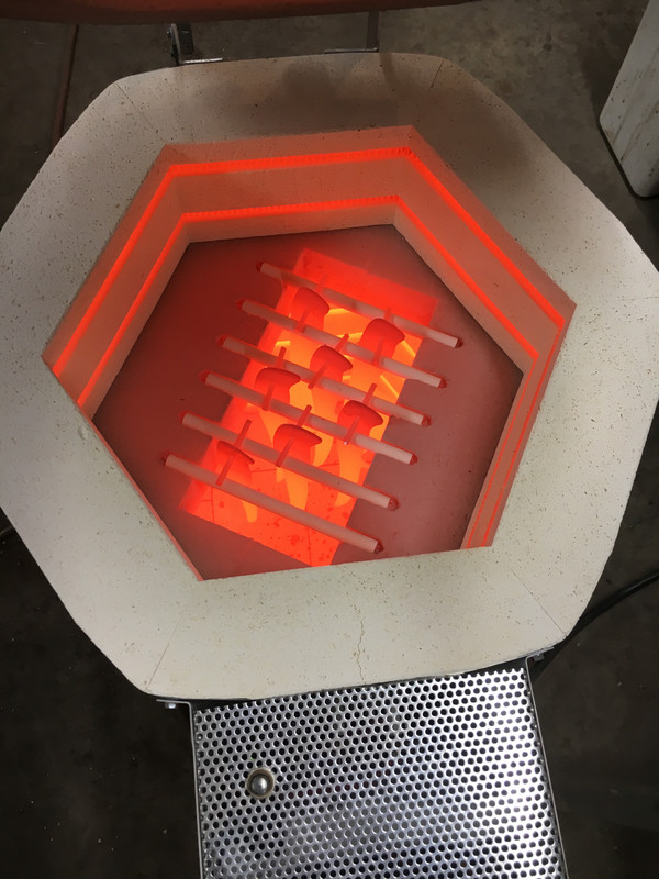

I have the 21" Airbath. I haven't been around any other kilns to compare to, but I absolutely love the Jen-Ken.
I recently did a batch of AEB-L that included 5 that were .070" and over 13" long with no warps. I won't say the airbath completely prevents warps, as I have had trouble with thin 15N20 warping in this kiln.
The kiln comes with rods that set in the top shelf of the kiln, then you use supplied pins through a hole in the tang to hang them on the rods. They also supply springs to use, but I had one knife release from the spring and fall in the kiln, so I don't use them anymore.
Here's a picture of it in use. I've normalized and thermal cycled up to 12 knives at a time.

Thank you i appreciate the feedback from an actual user!
Any reason you think as to why the 15n20 warped and the aeb-l did not?

I thought that 30 amp was pretty much standard "household" 220.? The 220/20 amp that is used for the other ovens like my Paragon and my press is the oddball these days. It is the old window unit air conditioner plug. I had to have it installed in my shop because of the oven.. The only reason that I used it for my press was so that I didn't have to wire two different circuits on one wall.
On amore related note, I should go over to Lakeland and take a look at these ovens. That is only about 40 miles from my house.
Do those ceramic rods lift right out? I am wondering because it sure looks like the opening that shelf is big enough on the long axis to get wider things like hawks in there. You would just have to figure out how to hang them.

Most of the 15N20 I use is recycled band saw blades. I have heard other people say they have trouble with it warping also. The last batch I did I used new steel and had more warps than I have ever had. These were some chef knives at 2" wide and I even had a couple large diameter ( 1 1/2" - 2") bubbles in the steel after heat treat.

Yes, they do. I'd have to measure to be sure, but I'd guess it's roughly a 5" X 10" opening with the rods out.
Hmmmm. Wonder if they cold supply say an insert that was 2 x 10 that sat on top of the main baffle? I would-be a tad worried about hanging something that weighed like 2 points on long skinny metal rods.

No, I got the new steel from NJSB. I was able to get most of the warps out during the temper cycles. I do all my grinding after heat treat, so anything left will clean up then.
