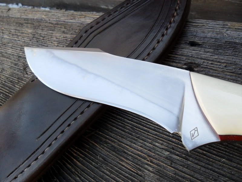

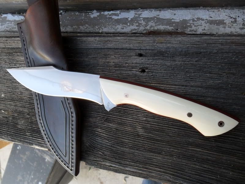

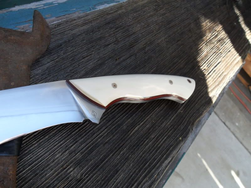

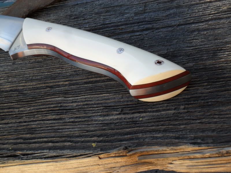

Here is one that we just had to show off. This is the first of many more like her. I took our first recurve design and reworked it over, giving it a more dramatic recurve/belly and a sexy new handle shape... What do you guys think of her?
specs:
Diamond J Knives
"Jenni"
3/16" 1095
Differentially Heat Treated
Flat Ground Recurve with swage grind.
Hand Rubbed, Acid Etched Finish.
The scales are 3/32 red/black G-10 3D and holly on top. The G-10 gives a really cool shadowbox look. CA finshed, hand sanded to 6000 grit and hand buffed.
(2) 3/16 S.S./copper mosaic pins and one 7/32 S.S./copper mosaic tube
Blade Length Tip To Plunge: 5 5/8"
Overall Length: 11 1/8"
Questions and Comments Always Welcome.
Thanks for looking!
Dan & Marce

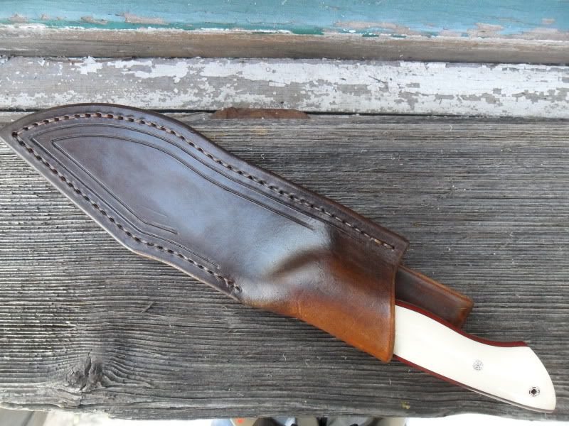

That is one sexy piece of steel. The handle shape looks good and comfortable! And the sheath work looks top notch! I'm a sucker for leather rigs!! Excellent work!!
I'm the proud owner of this knife and cant wait to hold her!When Dan and Marce first started posting their knives,I knew I had to have one of their recurves.I was lucky enough to contact them just as they were finishing their new handle design and am very proud to be the owner of the first one.I will be posting a review of her when it gets here but I think the pics speak for themselves.A first class deal from start to finish.My daughter,Jenni,just gave birth to a little girl last week so I guess I'm gonna have to get a small one to go with this beauty.
I too love their knives, love the naming, and love the sheath work. When I get money I'll be contacting them too. Can't wait for the review.
