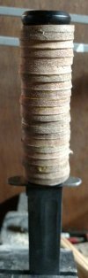

Jerry rigged KaBar handle vise
[QUOTE"eveled, post: 18236980, member: 448520"]View attachment 944310
2 C clamps with a wood spacer clamped in a vise. 2 small clamps to keep them from spreading. The rest is self explanatory. I think. Any questions just ask.[/QUOTE]
Looks Ingenious Brother:thumbsup::thumbsup: Keep posting your progress. Ive been wanting to re-handle a few myself.
Lesson learned, it sat all night, when I took it off there was 1/4 inch gap at the guard. The clamps were pinching the ricasso. I had pressed the blade out of the handle. So I added a spacer to keep the pads of the clamps just far enough apart to allow the ricasso to float. Added another washer repressed it and pinned the pommel.
