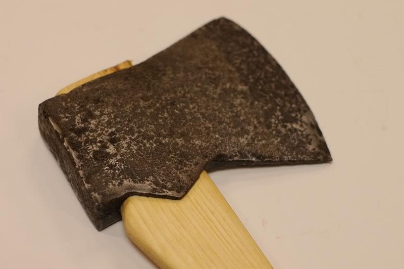

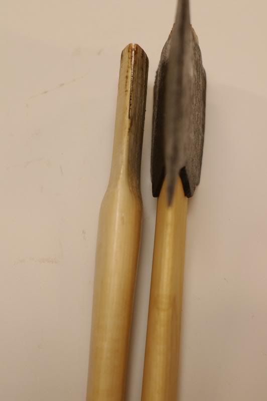

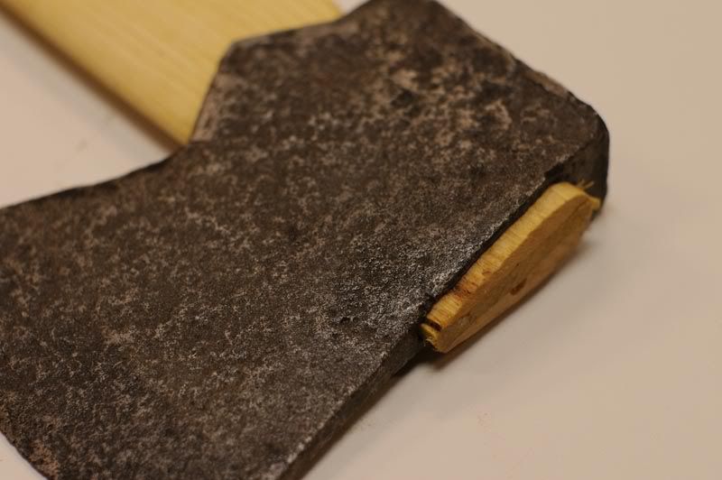

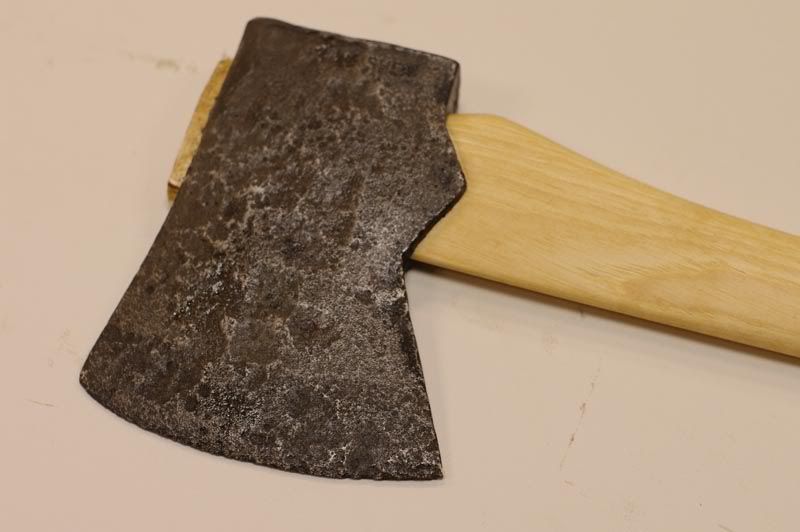

I love a jersey pattern as much as the next guy. There are times when I can't resist picking one up, even if they're not in the best condition. In this state of axe-induced delirium, I always manage to forget how friggin' difficult they can be to hang! Take Charo here, a Kelly Woodslasher that may not win any beauty contests now, but was sure to be gorgeous a decade or so ago (plus she has a great personality). I hung her on a Hickory Handle Store helve, which came a little thicker than my liking right out of the box, but Charo's damn gorgeous lugs just required so much attention! I used a block plane to thin out the helve from the shoulder almost to the throat. A spokeshave would have worked a bit better, but I can't find mine since I clean the workshop. I took a side by side pic to show how much wood I had to remove to seat the head properly, along with some other glamour shots.

nice work... that looks real nice, but your right, that ol' jersey head want win any 'beauty contest', but the hanging job just might:D

That's a neat job. I usually (but not always) leave about that amount of wood through the eye. I think it gives a good look.
