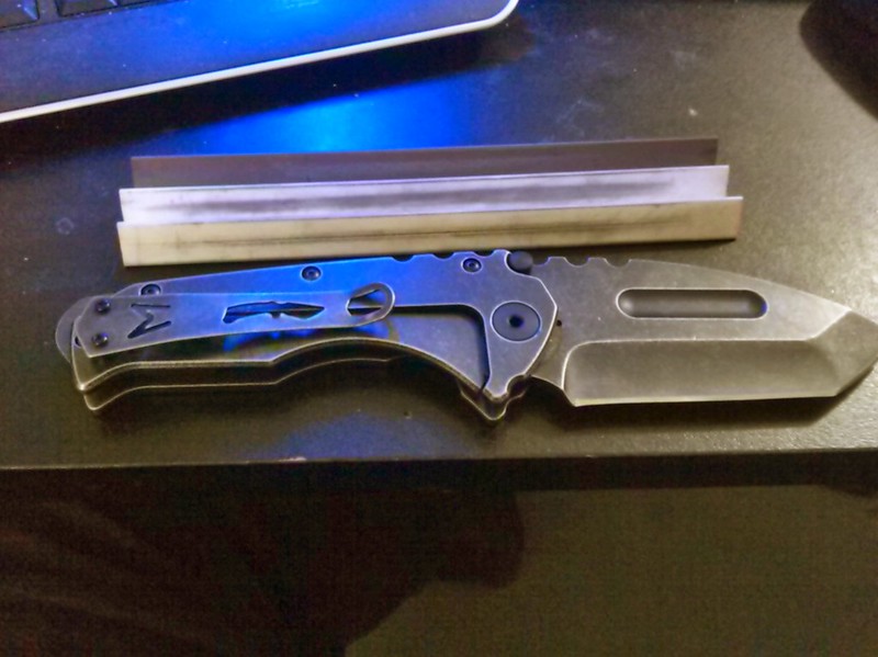

Some of you may have noticed me pimping or hacking a couple different sharpeners. Today, I focused my attention on the SharpMaker

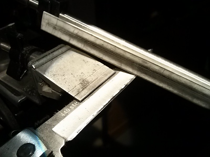

Notice the coverage on the rods. Right down the middle. The whole rod was not used, because the blade is slightly curved, but it does show how well I was able to stay on target. I set the angle to 20 degrees each side.
Anyone guess how I was able to keep my attack so accurate? I profiled the edge to 20 degrees (was at 25 degrees?) with the diamond rod (not shown) , then I used the coarse, fine and extra fine rods.
I cant wait to see what you have come up with. I like how you are always thinking outside the box.
The SharpMaker sharpening media is outstanding. Add Diamond rods, and extra fine ceramic rods, and what is not covered? That sets the stage for a ultimate edge.
O, wait, IF (big IF) you cannot work like a robotic arm in an assembly plant, your edge will suffer every miss stroke. You might get a 20 degree per side edge to be a matrix of 18 to 24, or 16 to 28. Nobody can hold a moving object in a repetitive pattern in a perfectly plumb motion. Some people are pretty good, and anyone can learn to get a sharp edge, but not a museum quality edge, freehand.

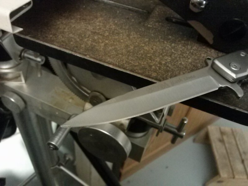

Realizing the SharpMaker 7" rods were a perfect sharpening medium, I put my brain to work on how to make their simple jig, work perfectly, every time.
What did I come up with? The answer, for limited funds, which we all suffer from, it cannot. As it is sold, is as good as it gets.
This being the case, I had to toss aside their simple and effective (at sharpening) jig, and build a new one.
After working on that project, I realized the answer I needed, was right in front of me.

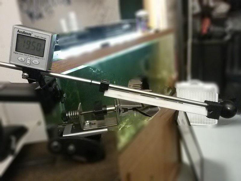

With no modifications, the SharpMaker rods fit nicely in the Edge Pro (clone) guide rod. Just remove the spacer from between the back holding block, and ball. Fits nice and snug.
SharpMaker rods, in an Edge Pro, is as good as you can get, on limited funds, that I have come up with so far.
You can purchase great stones for an Edge Pro, but can you get every stone you need for $100? No. And, they are only 6" stones. A 7" stone, that is slightly narrower, really serves most any blade design. Especially when you realize, you can use the edge of the stone, to sharpen real wild blades like kris Stiletto's.
Will post a photo later
I like any knife that holds an edge, and looks sweet. This one works.
Here you see blended three knife sharpening systems.
KME, Edge Pro (clone) and SharpMaker. Taking the best of these three offerings, and making one unit, does have advantages.
Over the next few weeks, I will work at tweaking the fixtures that bond these sharpeners together, into something that looks like it did not come from the movie Deliverance.

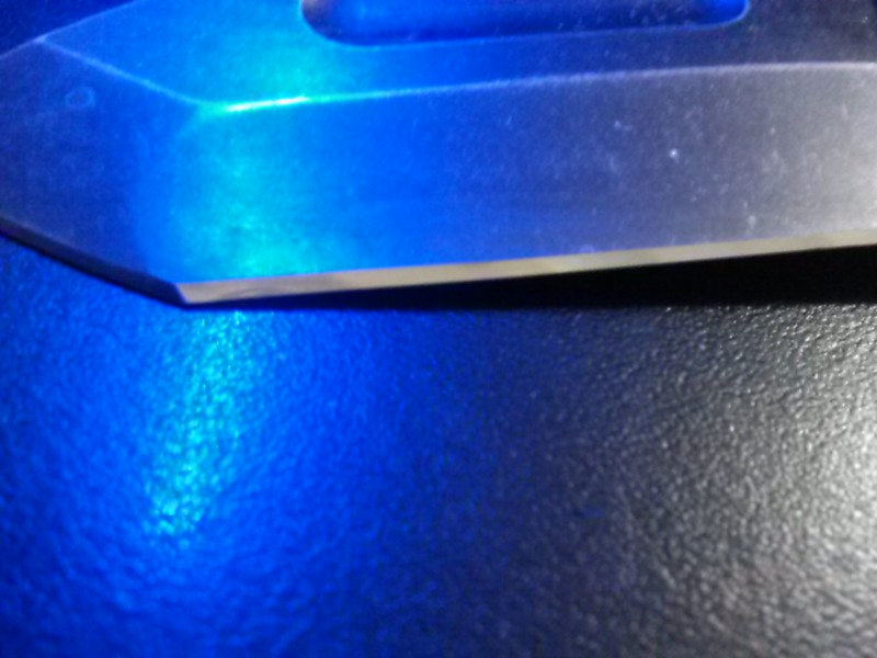

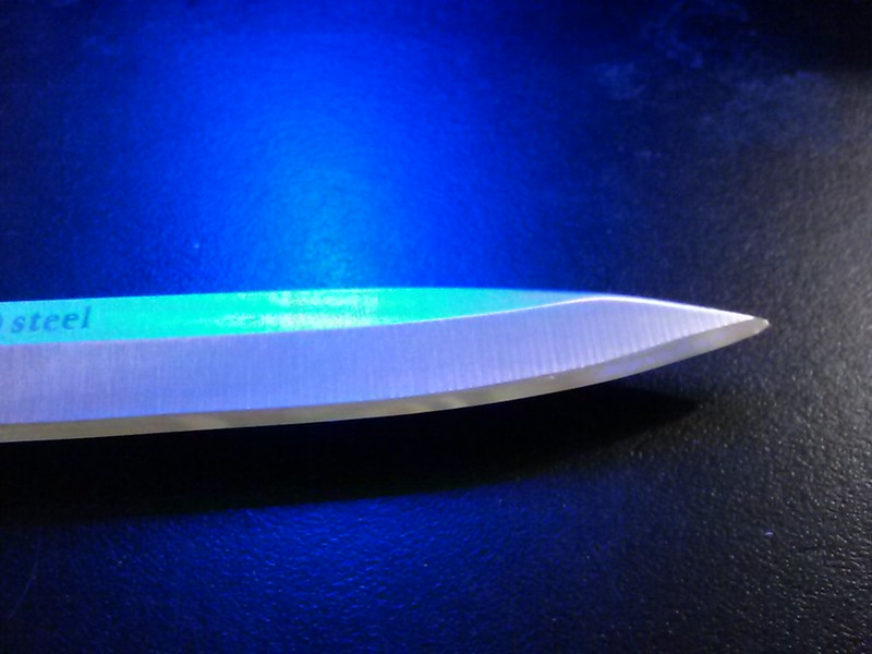

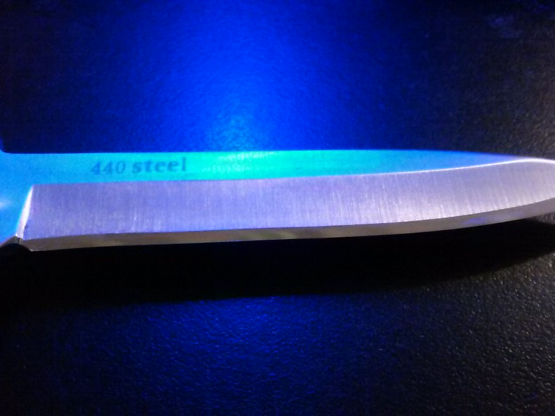

In another thread Cynic challenged me to try this on a wider bevel.
I took your challenge, grabbed a new knife, and went to work. The angle was 25 on each side.
Profiled it to 13.25 each side with the Diamond SharpMaker rods. This is the max angle I can do with this set-up or it rubs my jaws on the KME.
This is the results, no stropping. Just SharpMaker ceramics.
Before
During (notice how all the traffic on the rod is placed in the center? This is not possible to get this perfect angle of attack freehand) IMHO
After

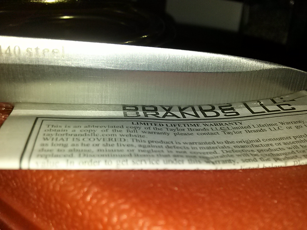

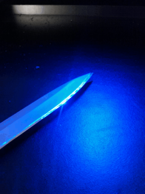

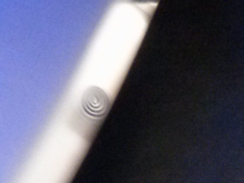

Being a math guy you might want to tighten up the slop in your pivot arm. The shoulders are still a bit hazy and some deeper scratches are showing. MadRookie has a nice arm setup with a heim joint for his edge pro. Good luck and enjoy the chase for nice bevels its a fun road.
cell phone camera capturing reflection from AC vent 12 foot in the air.
I would think the distance this reflection was captured, means the bevel is rather flat. Also quite mirrored. In a microscope, it shows some scratches, that should have been worked out with the medium grit. Note to self, check progress with microscope at each step.
