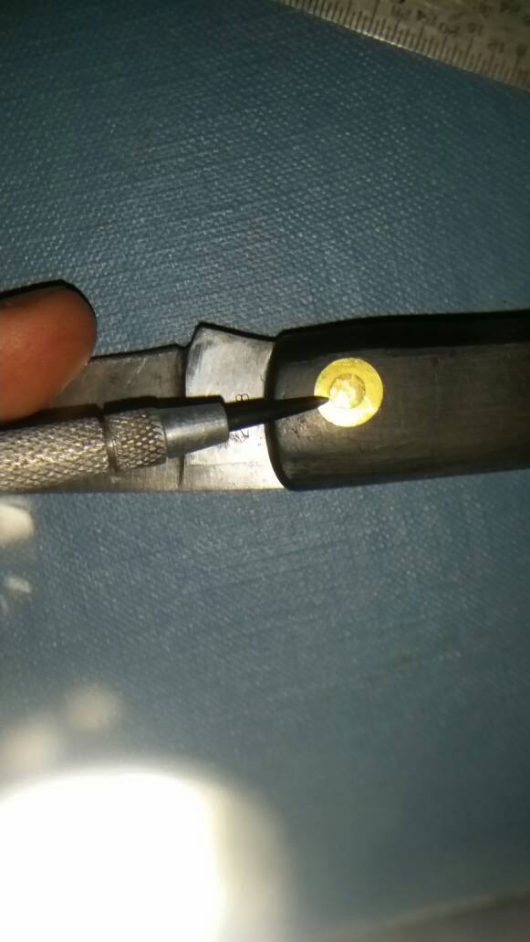

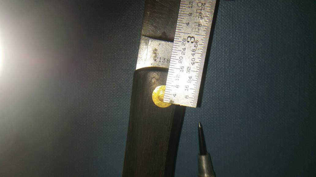

Well, the pivot pin itself is only about 5/32" on the classic style Large Soddie, but it is peened into a washer sort of. See the pictures I have.
This is the pin, you can see it popping out of the washer it is peened into. Mine is 40 years old and well used, so I've had to squeeze and repeen it. I don't think you can see it on a new knife as they are sanded flush.

I think Connor answered your question. I believe the pivot pin on both models is the same size. Since Delrin is soft, the pin is peened flush into a larger diameter washer to share the load from the pin and keep it from stretching out the hole in the Delrin. Once the handle is polished, the pin and washer appear as one, that's what you're seeing. The bone is stronger and doesn't need the washer, but the pivot pin is the same size.
The Case delrin soddies don't use a pin for the pivot. They use a 'cutlery rivet' for that instead, a two-piece fastener with male and female halves. When pressed together, the end of the male half essentially widens/expands within the female half, which is what locks them together. It's not a pin peened to larger diameter.
See the patent links below for a cutlery rivet. The illustrations show how they fit together.

The larger diameter of the rivet heads I think serves mainly to prevent the fastener from pulling through the softer delrin if the blade were twisted or laterally torqued very hard against the handle. A smaller diameter pin would be much easier to pull through the delrin if treated similarly, because the delrin would more easily deform under that stress.
I suspect the Delrin handle with the cutlery rivet might be stronger, if only because the larger head, which distributes the torque load, in tandem with the somewhat more resilient & flexible Delrin, would handle the stress of twisting/bending better. In the bone version, I'd be concerned about the bone cracking or chipping at the pivot under more focused pressure from the smaller diameter pin, if that version were twisted or torqued similarly. But that sort of torquing or twisting is what I'd consider abusive for most any traditional folding knife (if the pivot doesn't fail, the blade would likely be damaged anyway), and the bone-handled soddie should handle 'normal' EDC use easily, I'd bet.

I had figured it was a cutlery rivet originally, but it didnt make sense when I squeezed it in a vice and had the center pop out like that. I think it is a male half of a cutlery rivet that is peened over a washer, then sanded and buffed flush.

I hadn't originally been aware of what it was, until seeing some posts from BF member 'Seals' (Don Seals) who has re-handled many Case soddies with custom handles (some seen & posted in the Trad forum), and therefore had taken the Case apart and seen how it was constructed. He identified it as a cutlery rivet. I trust his input on the pivot construction. See his comment in the thread linked here (post #8 in particular):
